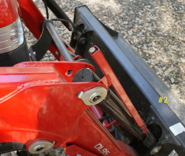

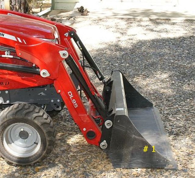

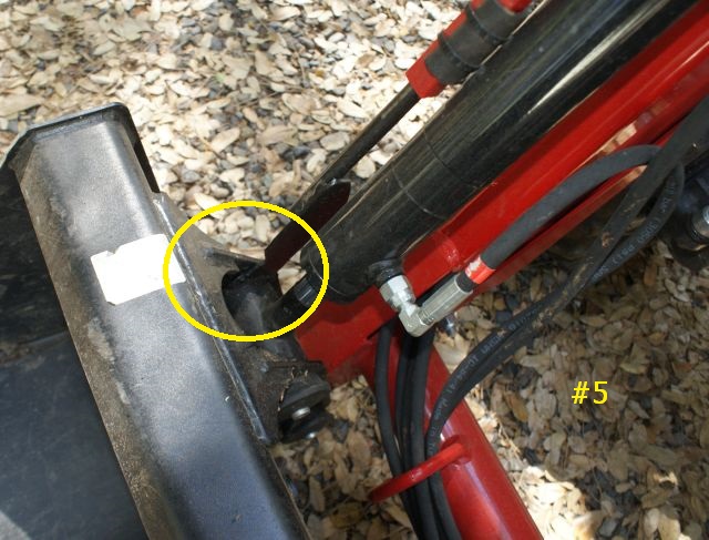

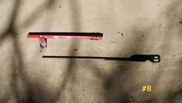

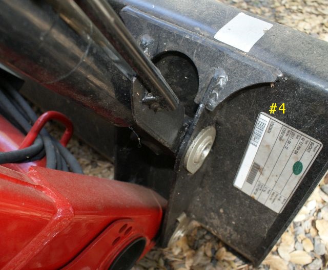

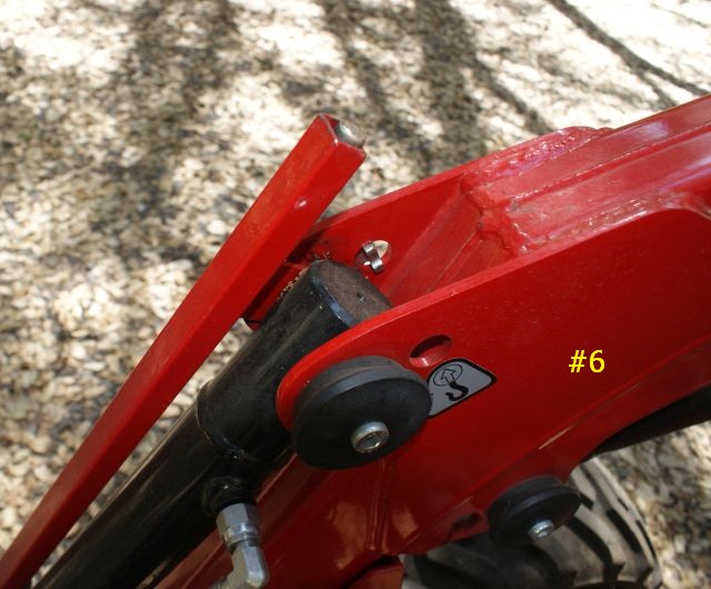

   / I NEED A TIP HOW TO SEE IF MY BUCKET IS LEVEL THE GROUND #64

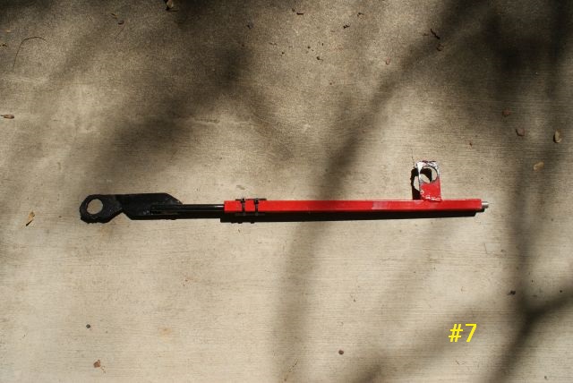

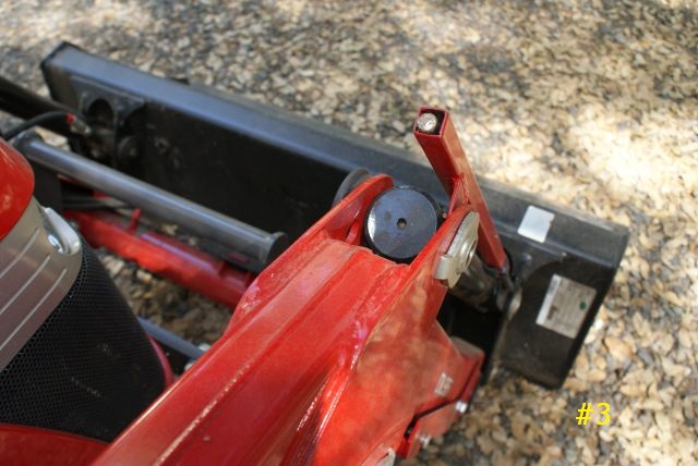

Yeah, and my MF had a piece of white tape on top of bucket as "level indicator" but my being old school and a but dumb could grasp how a piece of white stuff indication angle pretty much a protractor/bubble level guy.......SO...
Made a mechanical indicator.... Thread is somewhere on this site but don't want to bother finding it again....
But...
(not sure where first pic came from with hooks, but its not relevant so ignore)
Dale

Dale, I remember that thread!!! I'm too lazy to search for it too.
I use the V notched rod type on my Kubota.
I use your type on my Ford TLB In the brush I like yours better. Less chance of catching the rod on something and bending it.
   / I NEED A TIP HOW TO SEE IF MY BUCKET IS LEVEL THE GROUND #66
Slick idea and great for posts. I am thinking that with a loader bucket more times than not I am not looking for level with gravity but level with the contour that I am on which means I need an indicator that is relative to the angle the tractor is on. With my Ford I have the rod in a tube type on the arm but with the Versatile I can see the bucket so clearly that I just move it to where I want it by how much the tip is or is not digging.
