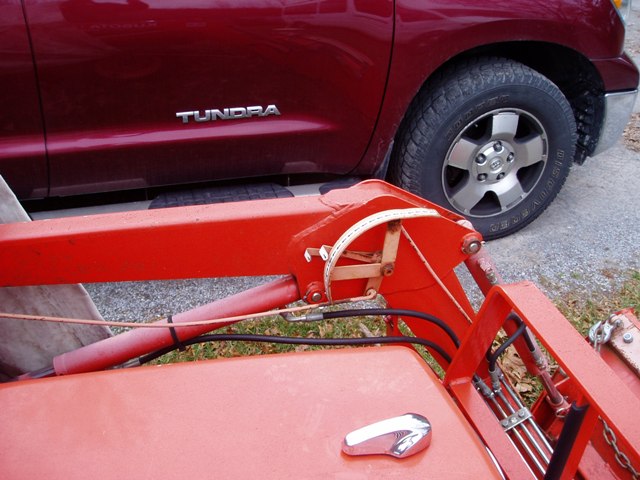

I made one for my loader about 10 years ago, mostly for using with the forks mounted. It has one fixed pointer that shows where the bucket position will be at ground level, a second moving pointer that shows the bucket position at the current level, and a rotating dial that moves with the bucket. Here's a picture.

I went to that thread, cant quite figure out what your looking for to indicate bucket angle, dose the rod come through the top of the tube to indicate bucket level?
Since he's not online right now, I'll offer an answer.
Yep. The rod slides back and forth thru the tube. When the end of the rod is even with the top end of the tube, bucket is level when sitting on the ground. That's what drove my comment about using it when rolling the bucket backward to level. You stare at the tube waiting for the rod to appear, then stop curl. Hard to tell how far forward your bucket is tilted without exposing the rod and then adjusting from there. I used that type for several years. You get used to it.
