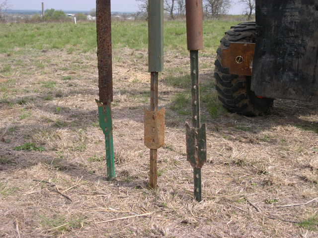

Post drivers are one of the easiest things to make if you have a welder. All it takes is a piece of metal pipe in the diameter and length you want with a cap on it and a piece of 1/2" rebar to make handles with. You can Google -images- post driver and see a lot of different ones to give you ideas. I like the ones with the handle going the full length of the pipe to fit various size people and I also like the handles about 160 degrees apart instead of 180 degrees. You would probably benefit from one with a longer pipe than the ones they sell.
The one I made is very heavy and long pipe and hard to lift onto the post, but it drives the post in quick and easy without as much shock to your arms as a lightweight one has.

Here you go re t post drivers.
Simple, really... get some metal pipe, heavy walled...just larger than T post shaft. Cut to length just short of the spade such that when you have driven post and bottom of driver is at ground level, you have driven it to your desired height. CRITICAL that pipe sheath be as long as possible... else when you start pushing it will bend and gets dangerous. Place a really heavy metal cap on one end, drill hole in that piece of metal... good to let water out... or get dirt out...these things get left in the elements. Grind off any sharp edges and points for safety. Find some sort of handles... or not... depending on your materials availability.
Technique:
select length of t post for fence height
select driver sheath to match post and desired driven length
find trusting buddy
buddy holds properly positioned post while you GENTLY lower FEL with tractor at 90 degrees to fence line
bottom of my FEL has strengthening structures creating a pocket into which I can place the top of the driver..pocket REDUCES slipping.
once driver is captured under SLIGHT down pressure, buddy MUST BACK OFF.. safety issue
lower FEL a short way, driving post into ground. Angle of bucket bottom will change and you will need to raise and lower bucket onto post several times... experience is best teacher here.... I kinda try to keep my bucket bottom just SLIGHTLY angled up or flat.
when resistance is encountered such that post no longer slips into ground, CAREFUL, front of tractor can and will raise off of ground and slip to the side, bending post and causing dangerous situation. This is EASILY AVOIDED by very attentively noting behavior during down pressure
you can raise FEL about 4 inches and suddenly drop it onto driver to provide impulse to get thru hard layers of material. BUT, when you have hit impenetrable rock, STOP. extra weight in FEL bucket can be helpful, but make sure it can't fall out on your buddy. Also, you can carry extra t posts in FEL (I do), but, again, worry about them tipping out on your buddy.
If impenetrable rock is on surface, move over a few inches and try again..it's just a fence..who's going to be out there measuring with a micrometer?
have short piece of chain available to pull improperly placed t posts using the centered bucket chain hook or bucket teeth..you do have this, don't you?
Also, have long handled pipe wrench at the ready...some posts WILL twist some during entry...simply place wrench at ground level and twist t post until it is aligned properly with direction of fence travel.
I find my hydrostatic transmission to be PERFECT for this application.. can crawl toward my buddy in lowest gear.. safety issue
PM me or respond with any detailed questions....happy post pounding!

Sodomo, down pressure with FEL bucket works for 95% of the t-posts.... pounding is ONLY for those situations where it hits a rock and you want to get a little more depth. sometimes, this breaks a small rock or moves it out of the way and you can go on down further....
So, down pressure is the primary method of driving... call it pressing... t posts into the ground...and driving/pounding is only a last resort.
I considered some sort of attachment... could never figure out how to make it work.. try a few and you'll be surprised how well it works with somebody holding the post while you just GENTLY lower bucket onto its top... then YOU :) get out of the way and let the wife press it on in. It'll give her a sense of power..... strong suggestion... develop the habit of resting the elbow on arm rest somehow while operating the FEL lever... makes operation much more smooth, much less prone to sudden slips... and this is a place where you don't want slips:eek:

I tried finally gave the bucket method that you recommended a shot and I gotta' hand it to you, it worked pretty well. Like I mentioned, I used a metal rod and made about a six inch starter hole then pounded the post in until the guide plate was started.
The posts were seven footers too! I put my grapple bucket on since it is pretty heavy duty. I found it best to center the bucket else a little twist could cause a post to slide sideways. A few of the small percent that needed hammering bent from hitting rocks.
Having a set of forks for my loader, I was thinking one could weld up a rectangular box to slip over the forks with a piece of pipe on the bottom to stablize the post and have at it.
/ I need a new T-Post pounder. #20
GOOD JOB... and now you know why I put a metal pipe just slightly larger than the T post itself over the post before I start driving the post.. since using this technique, I have not had a bent post.
