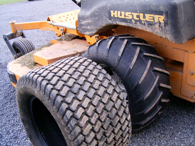

I also have a Exmark Laser HD commercial zero turn, it is useless on my slopes compared to the Husqvarna. If I had more flat property, the ZT would be the hot ticket, but where I am in south western PA, the ZT is not overly useful. My son has a small lawn service, so he has a few properties that he can use the ZT on, but many more that he has to use a Husqvarna garden tractor on. A lot of it depends on your are and your property, but for my the dream of a ZT is nothing but a dream.
I don't know, maybe one of those Cub Cadet ones with a steering wheel and hydraulically steered front casters would be better, I still think I would have the down hill runaway issue where the rear wheels let go and you go dashing for the lower tree line totally out of control. With my garden tractor and weights and chains, there is no drama. It is safe and effective.
I had the same issues with my zero turns on hills with the stock turf tires
I put Carlisle AT 101 bar tires on my zero turns and those issues went away
