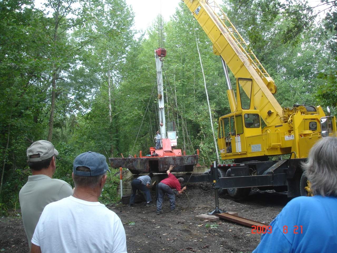

Site Report

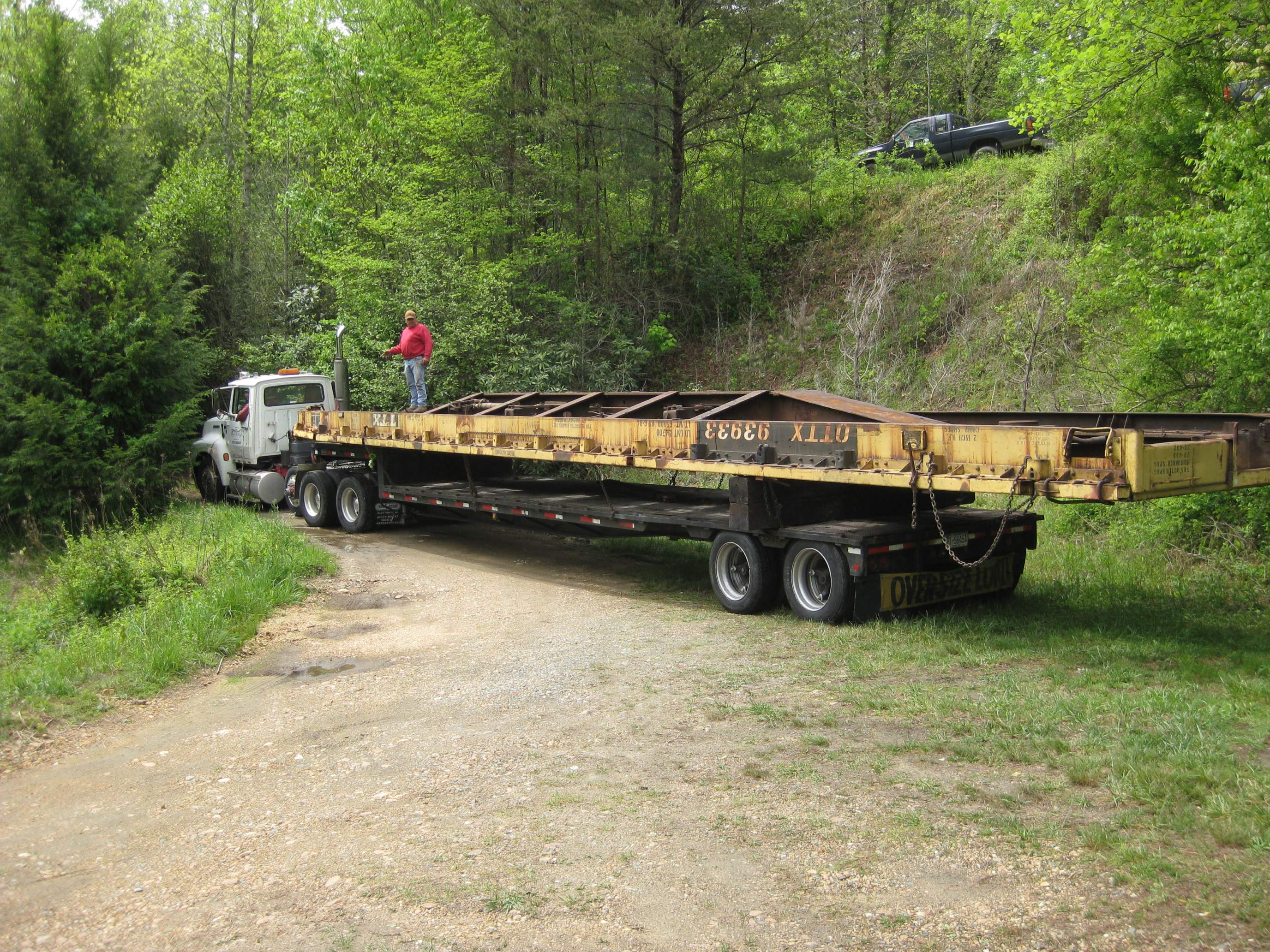

So we went to the rail yard and took a look at the flatcar. It is a 60 foot car that is 9.5' wide and 31" high at the high point which is the middle 30 feet. On one corner there is some damage where the car derailed. We talked with the contractor and devised a plan to install the flatcar using H beams and lots of concrete on the ends. It would be free span across the river. The flatcar weighs in at 44k pounds. The wood decking needs to be replaced. For this I have been looking at using Marston Matting which is military surplus landing matting. We will install this with a slight tilt to the upstream side because while the bridge will not go underwater often it will go under a couple of times a year. The contractor plans to have about 30-36" inches from normal flow to the bottom of the "bridge." Any thoughts?

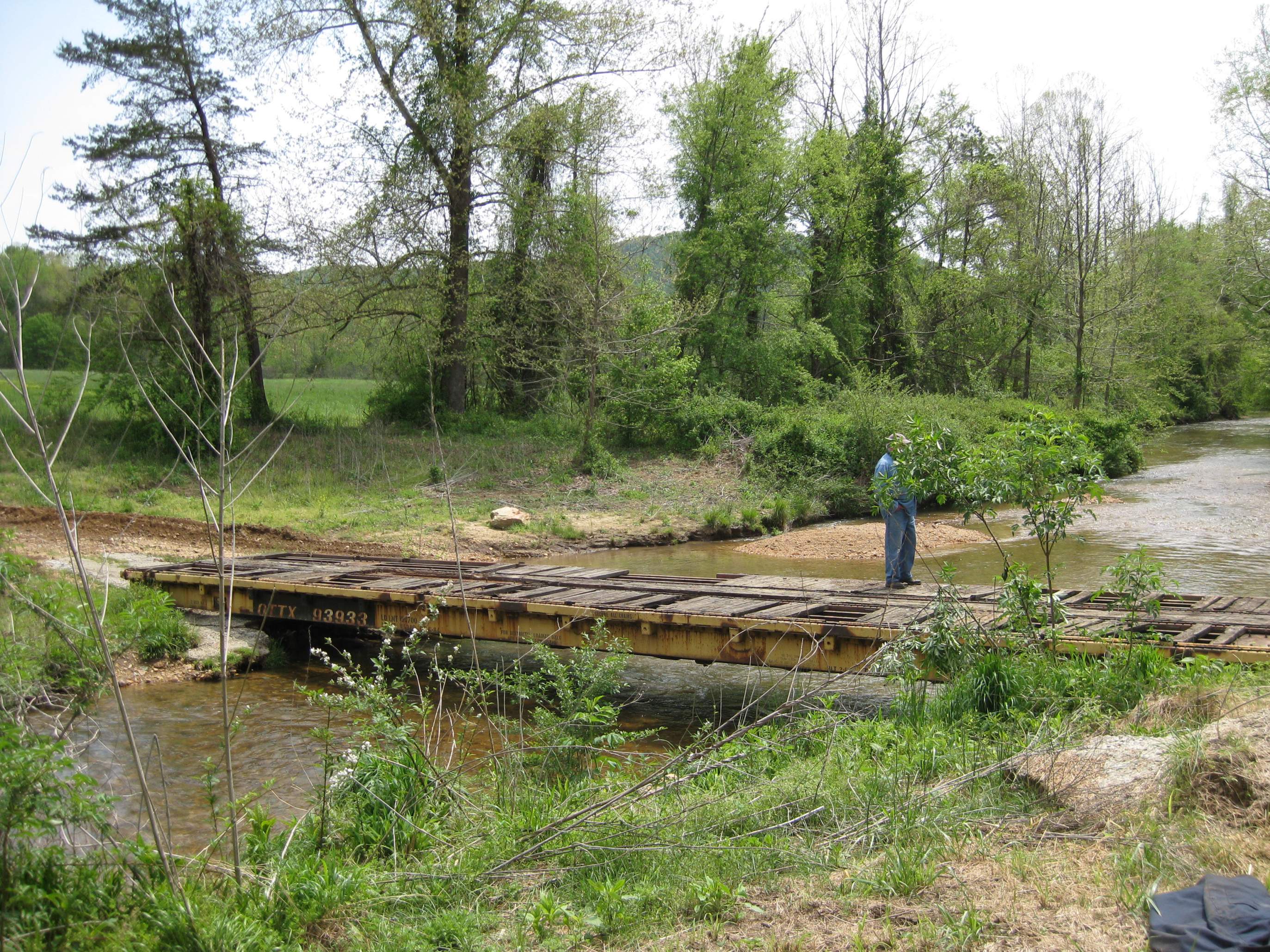

Update on the bridge project. Below are two shots of the original bridge built in 1946. These pictures were made just before we actually removed the bridge, now we just have a big hole in the river. In a couple of weeks the flatcar will be brought in to span the river. I will post pix as we move through the installation process.

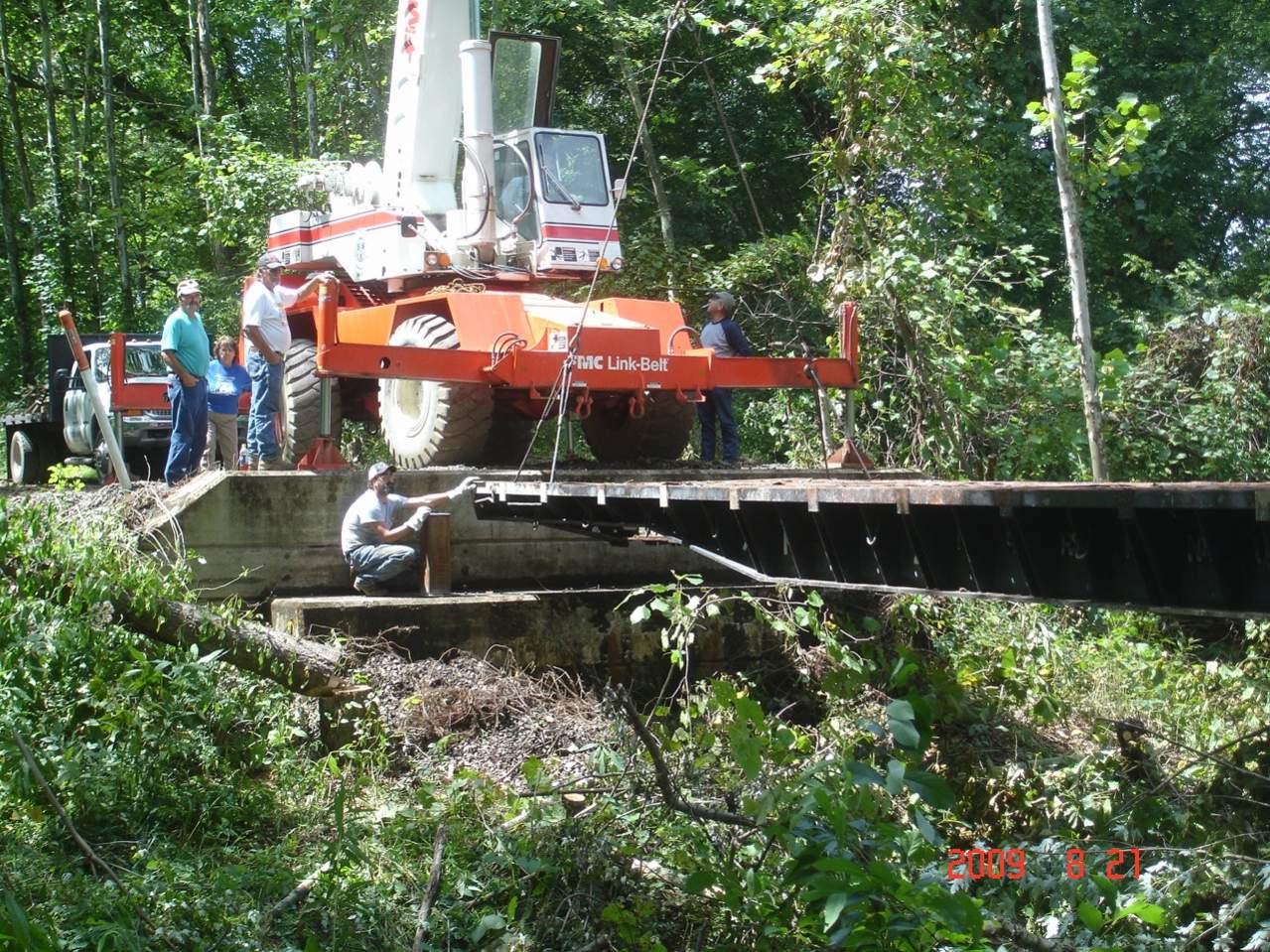

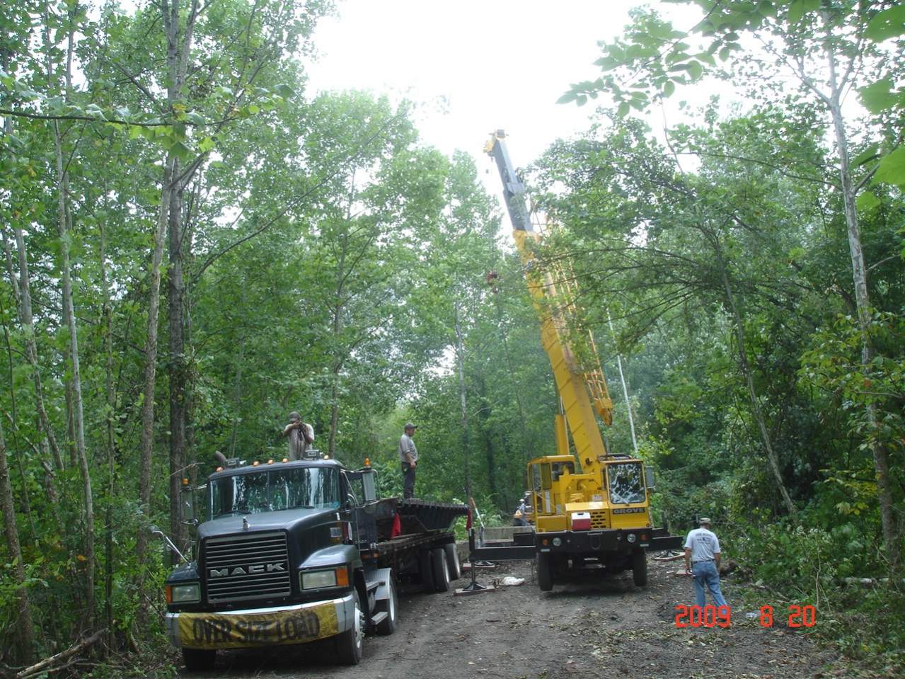

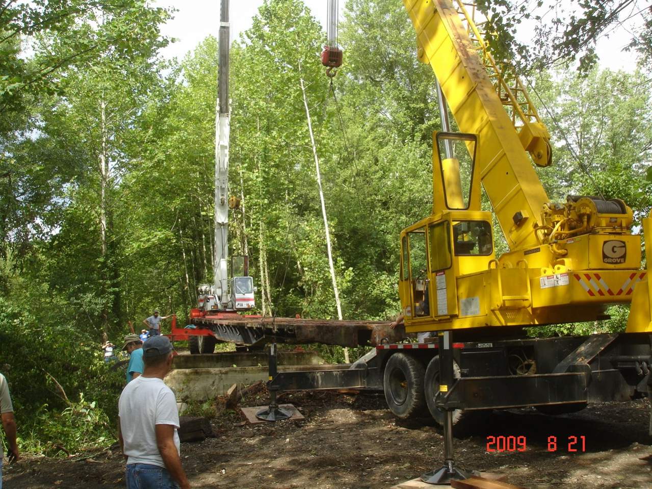

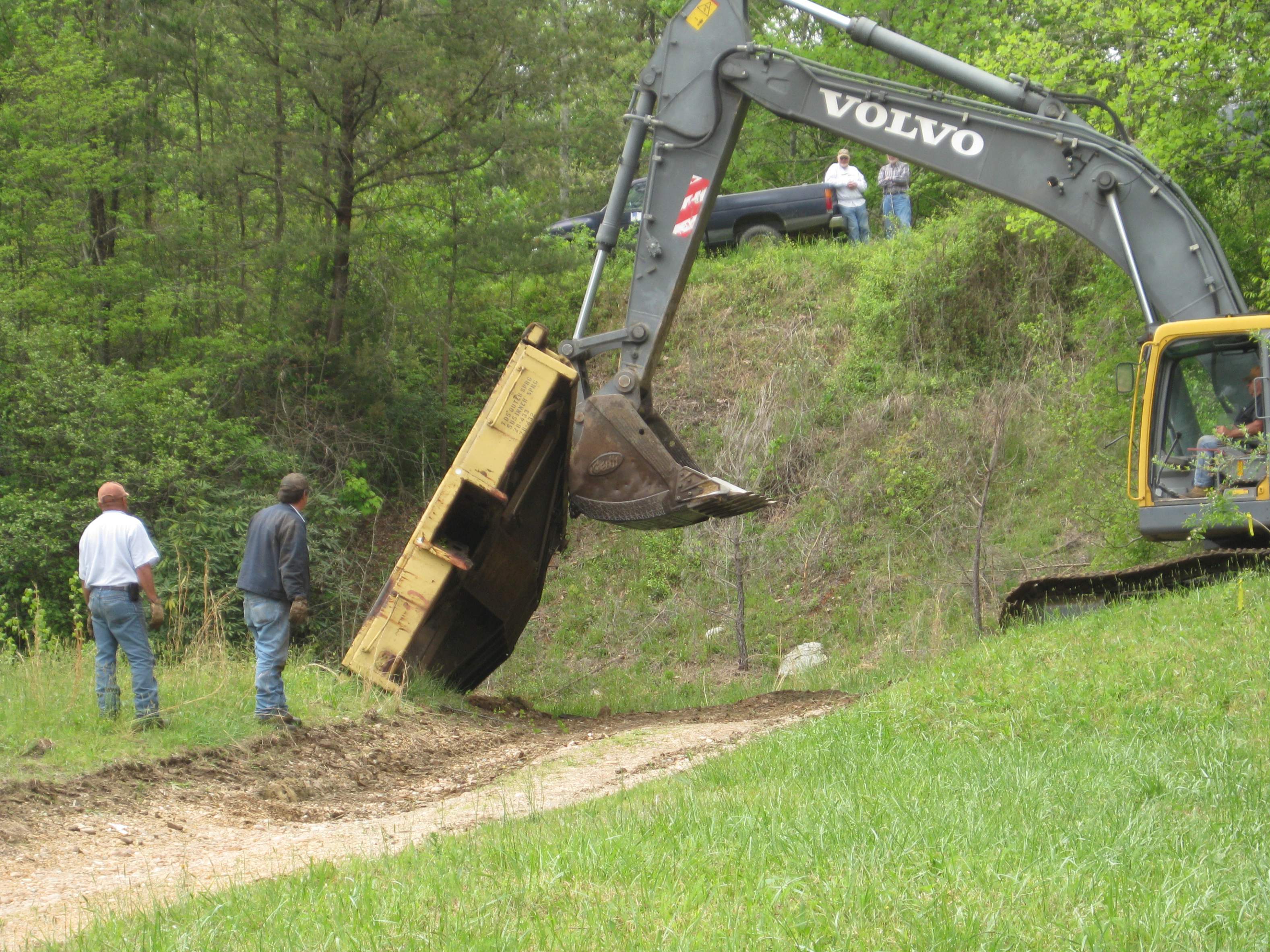

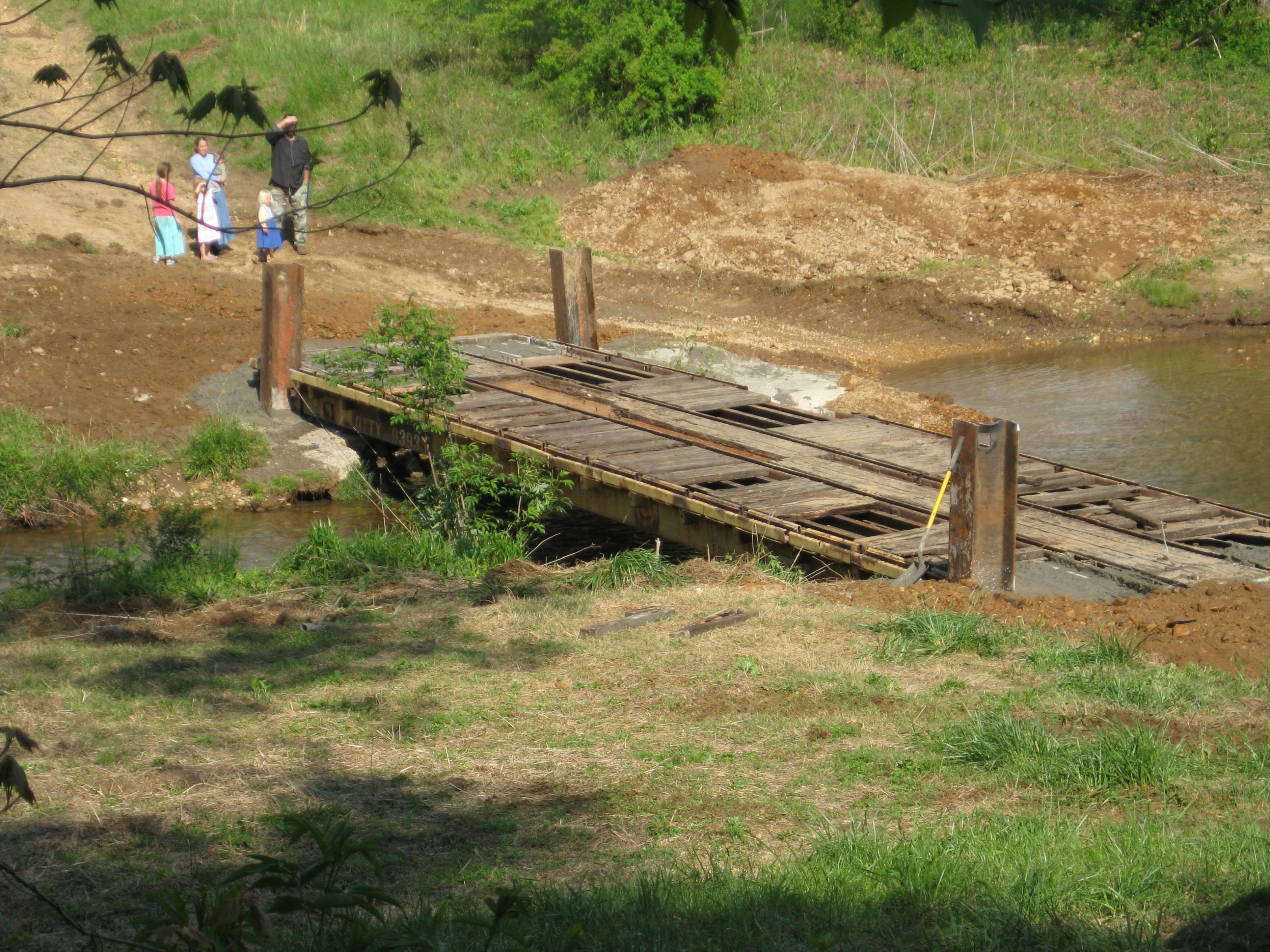

Well folks, we have a bridge! This past week the contractor made it to the river and in less than a day we had a bridge installed across the river. The contractor brought a large excavator with him to install the 60' flatcar. In just a few hours he had unloaded the flatcar, placed it across the river, dug the footings, installed the H Beams, and poured the 30 yards of concrete. What a day, it really went well and everyone was really pleased with the end result. Next is the re-decking project. We are going to use Marston mats which will be bolted to the superstructure of the the flatcar.

Nice looking bridge!! Glad you got it in place with no trouble, and ready for the decking now. I hope this bridge lasts as long as, or even longer than the original bridge. That way, you all can let your grandkids deal with replacing it next time around lol!
/ I need a new BRIDGE!!! #55
Looks good! Are you going to cut those pilings off flush with the bridge deck, or leave them stick up?

Thanks folks, I really appreciate your input and advice with this project. We are probably going to cut the pilings off in the weeks ahead as we get the decking in place. More pics soon!:thumbsup:
