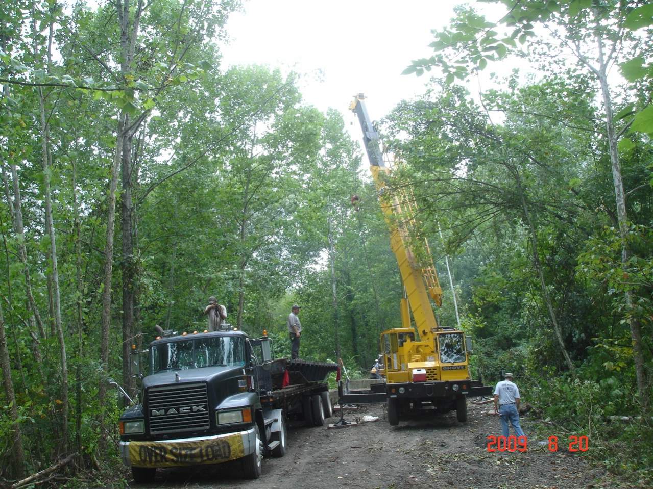

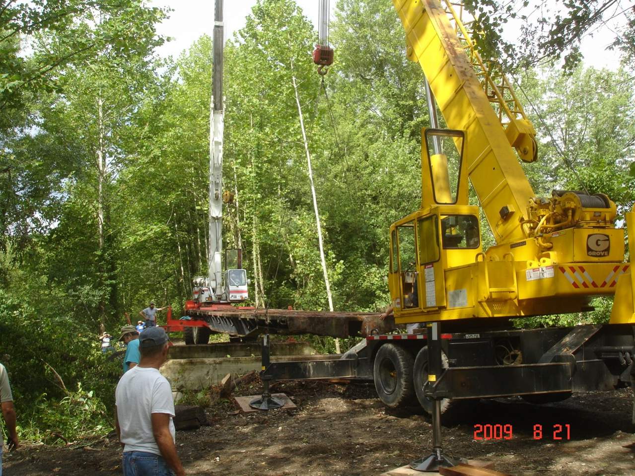

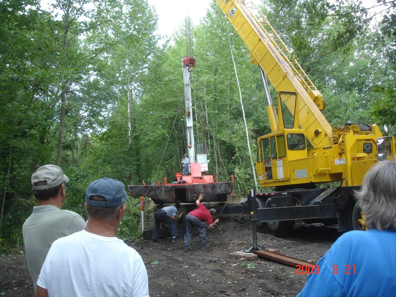

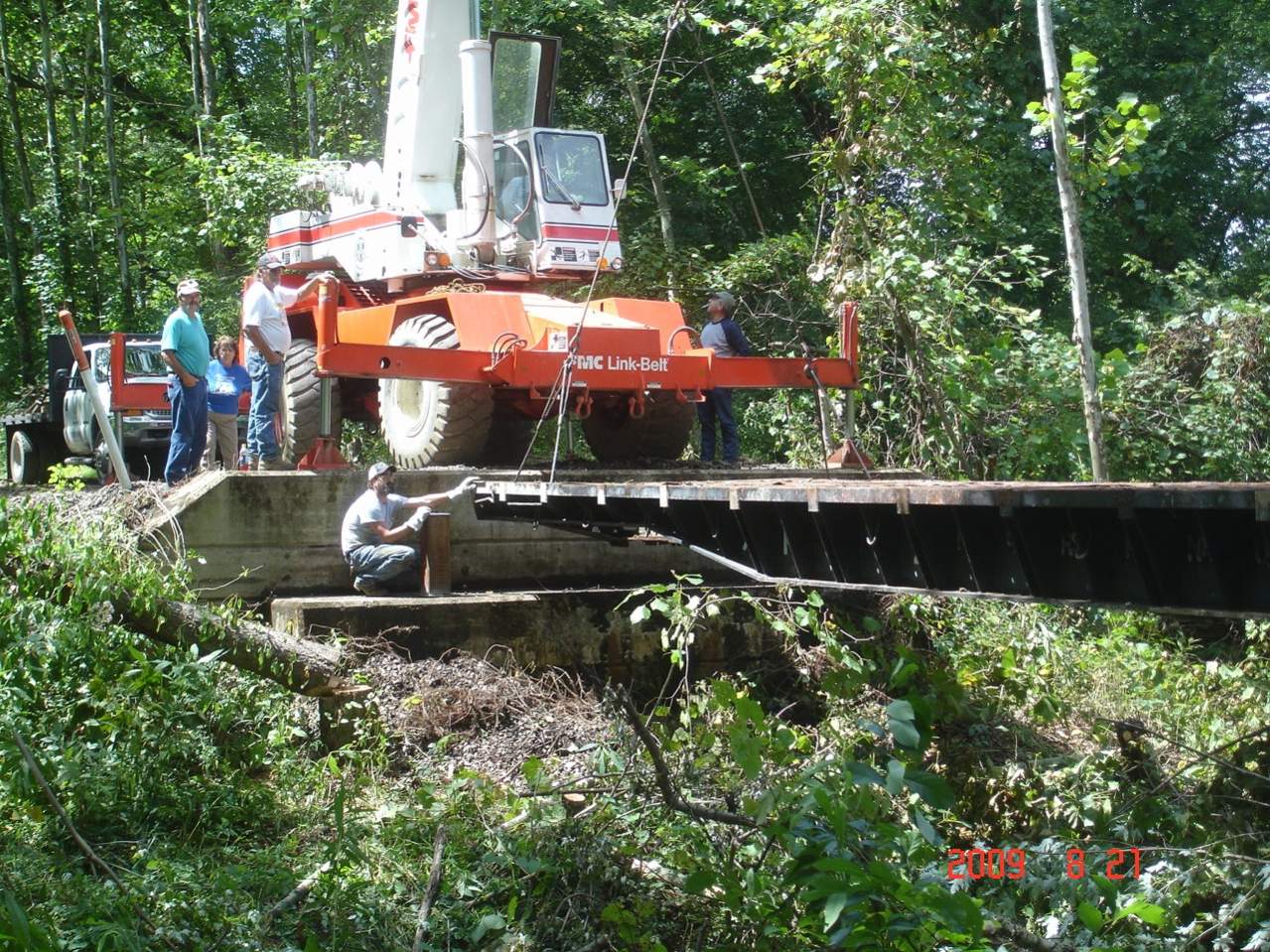

Here are some pictures of a flatcar being used as a bridge on the Moonville RailTrail, a muscle powered only, RailTrail is SE Ohio. The railroad pulled all bridges when they abandoned the line. Thank goodness they left the abutments.
All we needed to do, is find something to fit the spans. We secured three flatcars from the Dept. of Energy. They donated them to us, being we are a non-profit org.
One of our members is a contractor, and charges us only cost on equipment and labor. No profit, so it keeps his guys working when things get slow.
Car was stripped of decking. He hauled it in on one of his tractor trailers. They used two smaller cranes, because of getting them into the remote location, and was actually too much for either one, when booming down to get it centered on the abutments.
