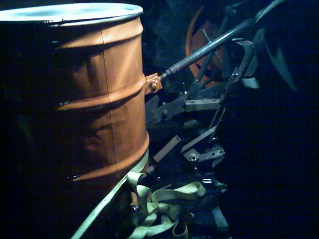

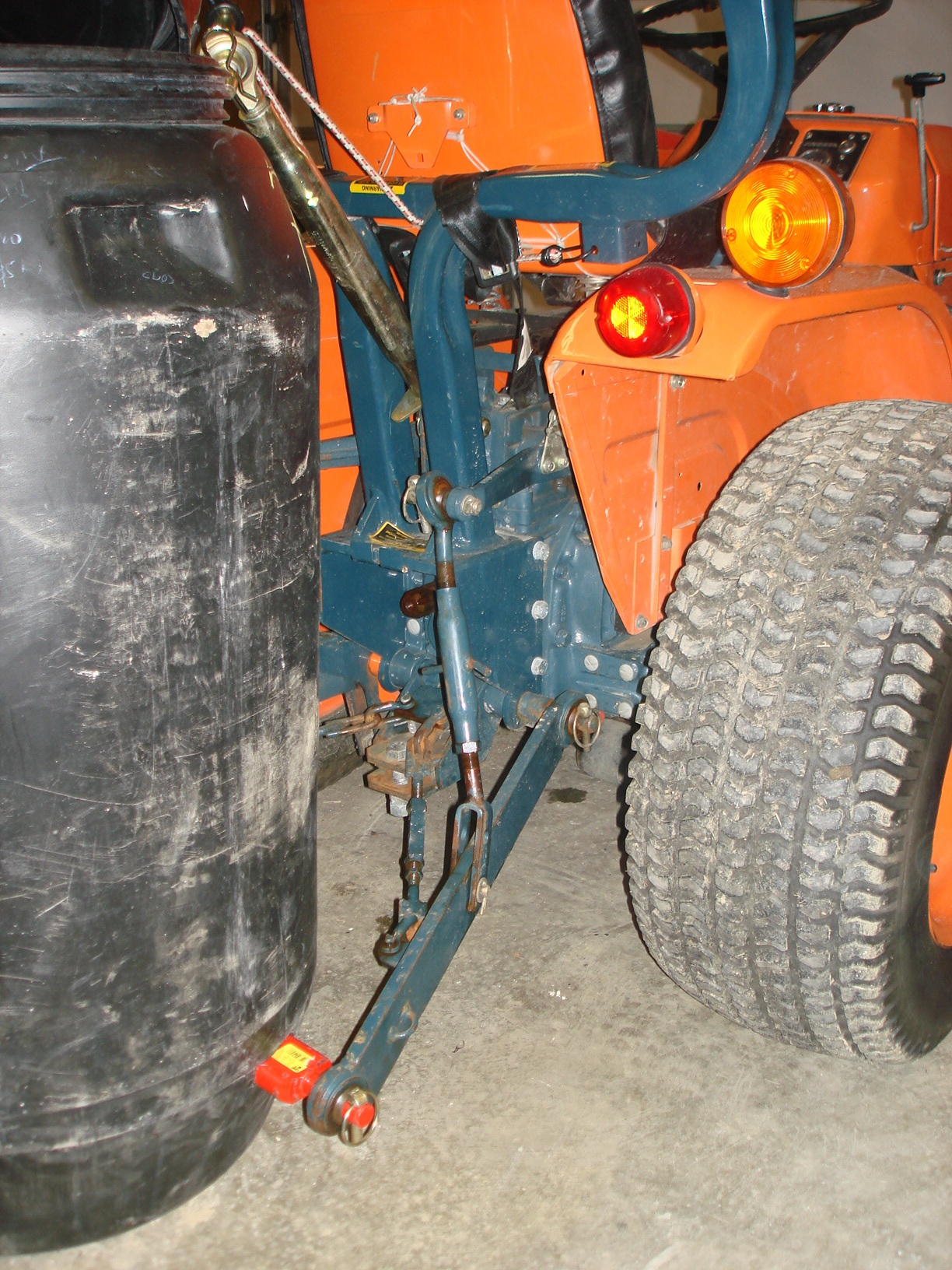

Well I just got my FEL on, and sorrily underestimated the ballast weight needed to counter balance the FEL even nearly empty. I was taking some garbage that weighed less than 50lb down my concrete driveway today, with no ballast weight. When I tried to slow down a little, All I got was howling and skidding rear tires! I was headed for a main highway, so I managed to run it up along the berm to get it stopped where I proptly checked my shorts for lumps.
Sooo, I HAD thought that 200lb would be plenty, I'm now thinking that I need alot more, like in the 600 -800lb range. My 275lb butt in the seat sure didn't do diddly. So I got a plastic drum to build my ballast with, and I cut the holes for my drawbar, now I need a top link attachment. I just got this Cat 1 top link, but it seems too long unless I attach it toward the middle of the concrete that I plan to fill the drum with. If I use a middle position, I am guessing that I'd have to shorten the barrel dramatically, which sacrices the weight that it could potentially hold. Or should I get a Cat 0 short top link and put the top link attachment on the side of the barrel? How does top link length affect the tilt if it when raising and lowering the hitch?

You're definitely going to need a different top link, the one that you have is just too long for your tractor. I doubt that it will work with any attachments you have.

I would either use a cat 0 top link or build a shorter one out of angle iron.

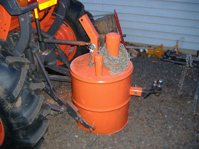

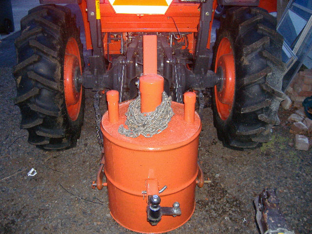

just get a piece of channel iron or 2 pieces of 2" x 3/8" thick x 12" or so long. Weld a "t" across the back and cut hole in side of your barrel. Once filled and dry with concrete, it will not go anywhere!! The particular one I have now has channel coming out of top. My old one protrudes from the side of the barrel, position it so your toplink will attach slightly above parallel to the lower arms.

The main thing all the links should be basically parralle for the linkage to follow the arch
Your top point is mounted to far up on drum too far in relation to the bottom links they should be in about the same angle your botom link are about 30 degrees below horozinal anf your top link is 30 degrees from verticale it looks like it is too long too like most rvery one else said but set the angles the same to get measure ment for length anfd

I took a measurement from the pivot point of the top link to the pivot points on the bottom on the tractor, and transferred that to my barrel. I did use a Cat 0 top link, and it does work very well.
