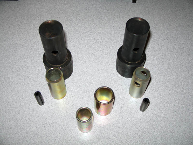

Just as an update. I order the part PM03015 (as I attached earlier) from my dealer. They arrived and are exactly like those pictured in the TSC post, although only one per pack with one roll pin.
So one bushing (with the big end) including a roll pin for $12.95 canadian or $9.95 from US dealers. That equates to about $25 per pair in CDA and 20 per pair in the US. Equal to TSC in the US, I suppose. And waaaaaaaaaay less than the quoted $130 per set for the other part listed by the canadian dealer!!
I can't confirm yet how well they fit or if I need a cat 1 to 2 bushing between the implement pin and the new bushing part. I assume I do, but I bought those at TSC for $3-5, so I'm OK there.

I got the I match on friday. A set of the bushing with the bigs ends ran me 40.00+2.5 tax

Are they heat treated??
They appear as if they could be.
I can't imagine what would make something so simple be so expensive....
   / I-match bushing question #40
The color pics posted in this thread are all the JD kit. Here is the last one in the set (I took them all) showing the JD part number:
I am not sure about the heated treated part, but the black bushings are finished in black oxide. They rust very easily. I would get the speeco units which are zinc coated and likely won't rust. And the Speeco units have fewer parts.
