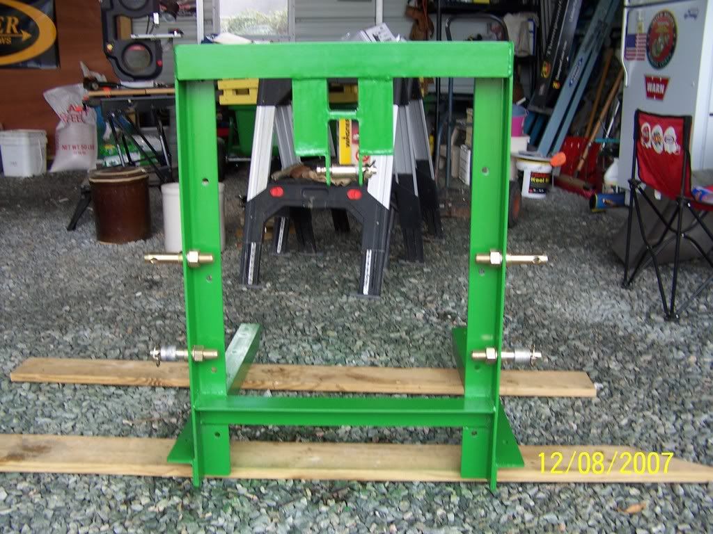

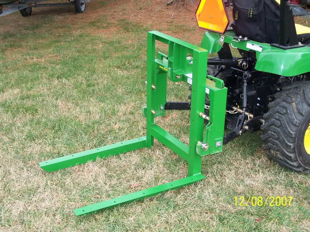

I got mine from 3 POINT HITCH WELD UP CARRY-ALL KIT It is awesome ask for Bill Tell him you want made for Your JohnDeere Imatch The kit is awesome I built mine & yes Jd Green Paint it will hold 800 Lbs http://i182.photobucket.com/albums/x247/kvjohndeere/100_0778.jpg
http://i182.photobucket.com/albums/x247/kvjohndeere/100_0773.jpg
http://i182.photobucket.com/albums/x247/kvjohndeere/100_0771.jpg
http://i182.photobucket.com/albums/x247/kvjohndeere/100_0777.jpg
   / I-match and a carry-all #7
kvjohndeere said:
OK, KV, I give up. What are the upper set of pins for on your carry-all? I am having a hard time imagining when you would need those.
   / I-match and a carry-all #8
They are for your adjustments if you to make it lift higher if you did nt have an I match ! So it is very versatile Take care
   / I-match and a carry-all #9
... still don't get it!
Wouldn't using the higher set of pins have the effect of lowering the carry-all? Regardless of I-match or standard 3ph?
   / I-match and a carry-all #10
They put Different Pin on there for height reasons ! Im like you ! I t is a good Idea though ! They designed not me LOL ! I just bought the Kit ! & welded it up ! I guess if you had A bigger series tractor it would be handy !I mean A bigger tractor with higher lifting 3pt arms !
