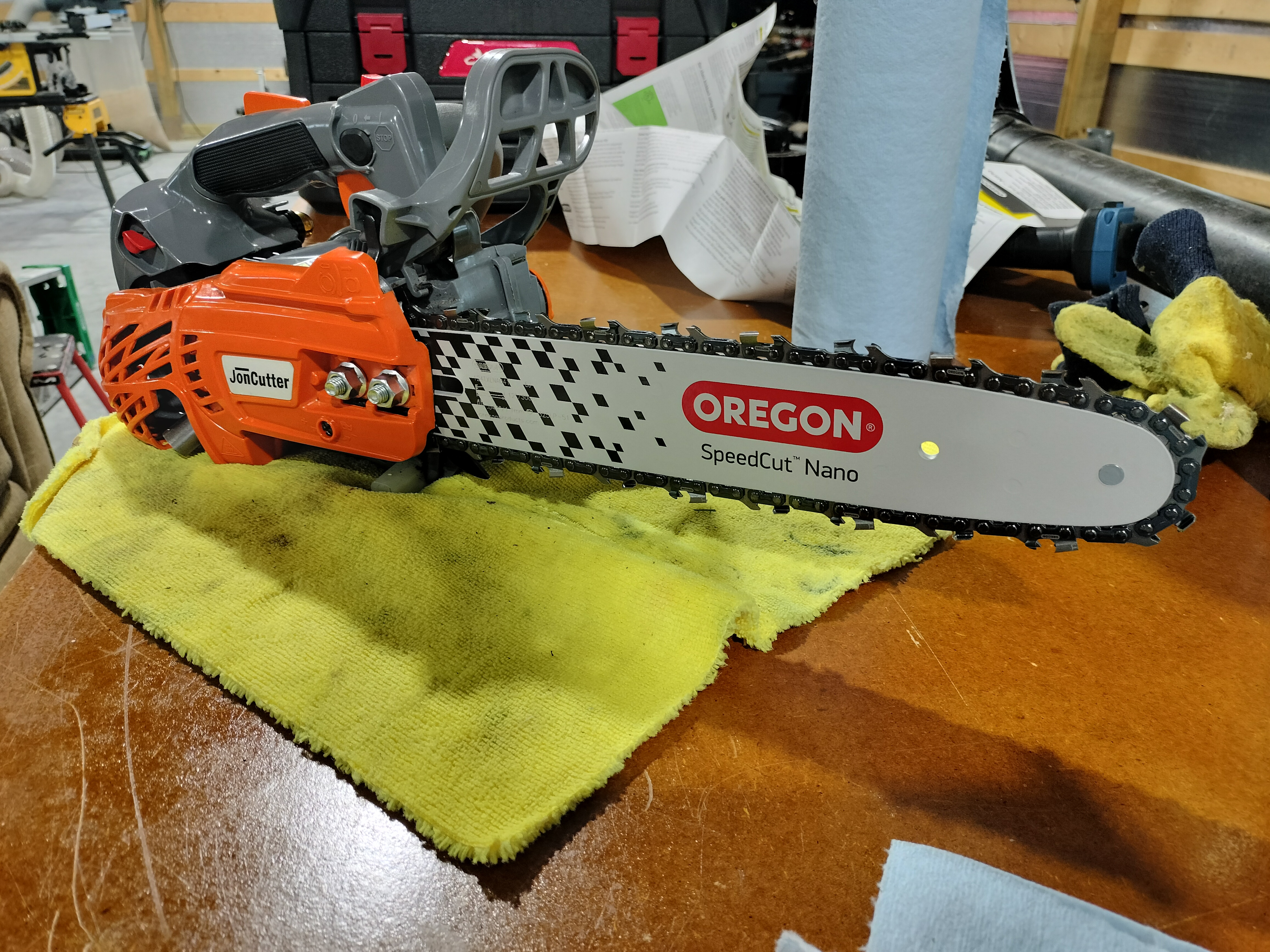

HD - Some like me bought the Amazon saw, and others got the one from Hockfire. I think 4570 got his from Hockfire, and 2manyrocks, Cloverknoll and I got one from Amazon.
My saw arrived tonight, spent 30 minutes taking it apart, and assembling it, yes the sparkplug was tight 15MM, and replaced with the NGK. The air filter was a bit loose, so tapped/closed the metal tab a bit and it tightened up - that may need to be revisited TBD.

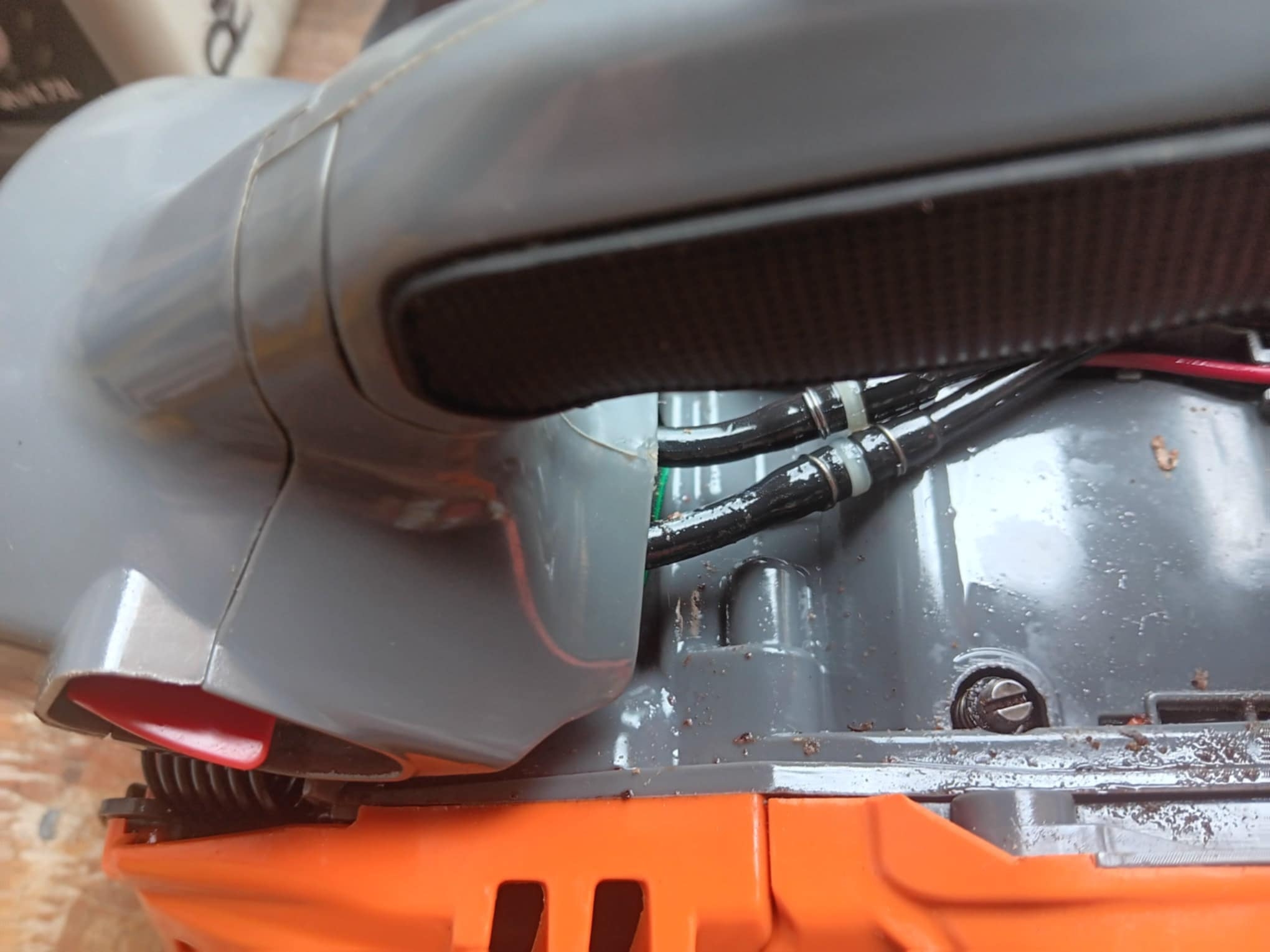

Some edges around the grip but 320 grit paper easily cleaned those up, Installed the chain and tensioned, and have not gassed or oiled it up yet, Overall fit and finish is good other than the grip.

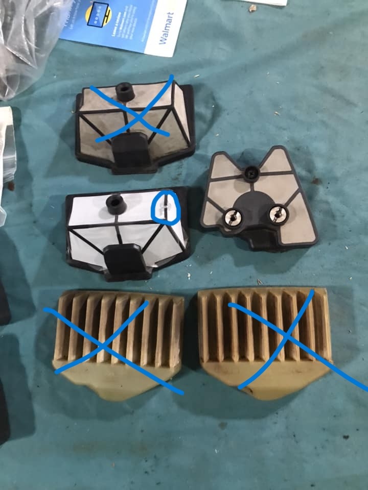

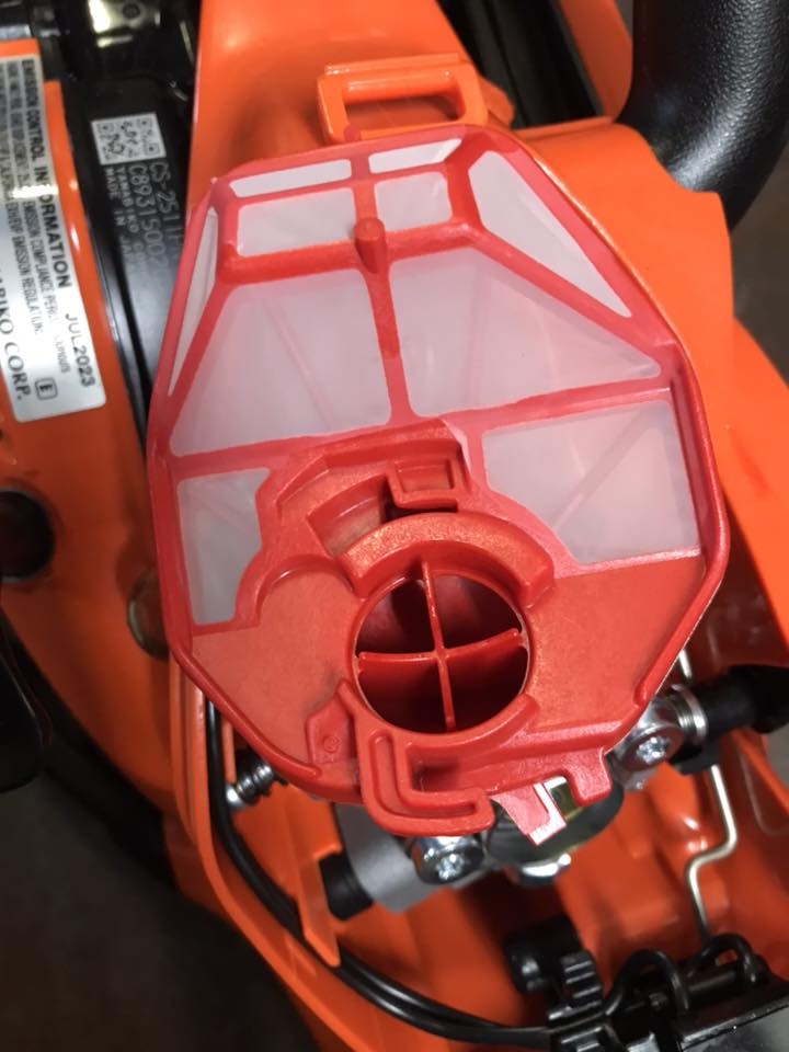

Loose filter? Wonder if you got an OEM filter
   / I just bought an Echo 2511t clone for $99. What was I thinking? #167
Blue filters will be small filters. Scotty said there is some small white ones too. I just never seen one yet.
I bought mine straight from Farmertec USA NJ warehouse.
Filter good to go here and I use grease on stihl and echo base mounts.
No flashing here on my 2 clone 2511. Just the new batch of small air filters ones had flashing.
