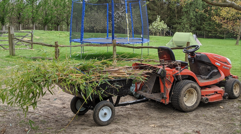

I have a different perspective on this (and bias I guess :ROFLMAO:) - I too own a 1.2 acre property in the UK, much of which is grass.
When we moved here I bought a diesel Kubota GR2120 mower/lawn tractor, used but with about 300 hours on the clock. Over the few years we've been here it has been incredibly useful. Mainly for mowing and collecting the cuttings, but also intermittently for pulling a trailer with firewood/rubble/garden waste etc., pulling a lawn roller when we re-made our formal lawn area, pulling an aerator a couple of times a year, and other things. I fitted a Rhino 1000lb winch to the front as it used to get stuck in winter despite the 4wd, which has also come in handy a number of times for pulling lumber, pulling small fruit trees upright, and recently pulling bamboo roots out from under a shed.
It wasn't the cheapest to buy but I'm pretty sure I could sell it now for more than I paid for it. And being diesel it doesn't cost the earth to run.
