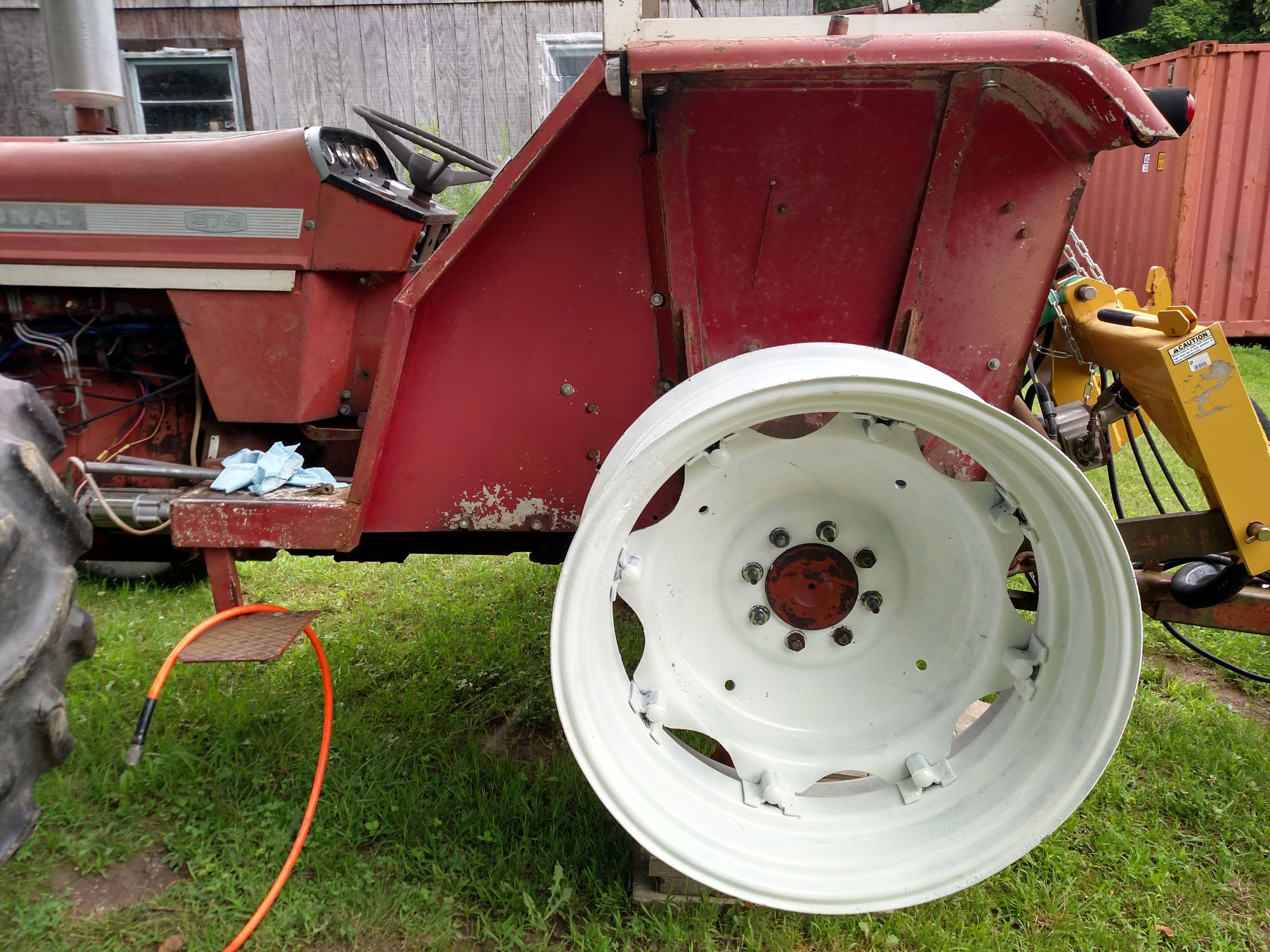

This work was the result of calcium chloride, it did take it several decades to be necessary though.
One day breaking the tire down and the rim off the center section and start the wire brushing and welding,
the second day to finish the welding and grinding and painting.
The third day installing boots in the old tire and then mounting the tire and installing the new $80.00 tube.
A bit of work a bunch of sweat and other then the tube minimal cost.
No fill or iron on this tractor now keeping her light as the only work it does is a bit of brush hogging once in a while
and back up for the other tractor. With chains it can pull the back blade or run the blower for snow.
