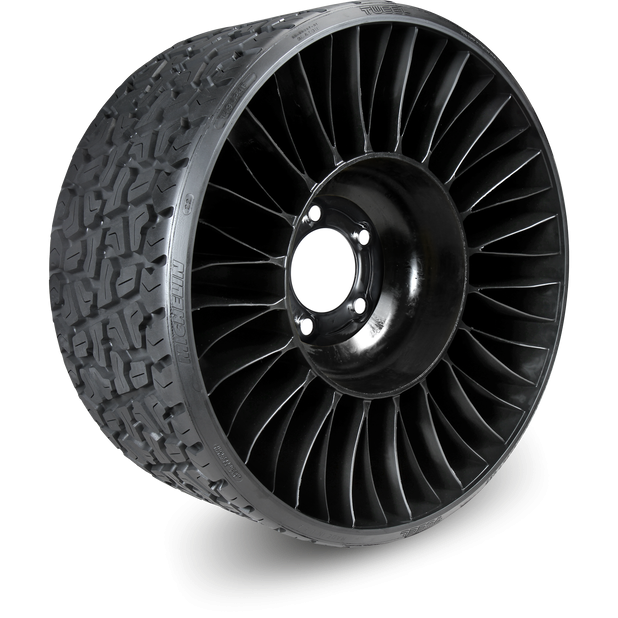

Maybe tweels will solve your problem.

I bought a set of these suckers and they will kill your back.....like riding on stone wheels. It looks like that they were designed to give on impact....well your mower needs to weigh 5x or so of commercially available machines for that to "might" happen. Well my 61" 36 HP commercial mower with an upgrade (comfort) seat didn't fit the bill. Very dis-satisfatied "puker" of my money!

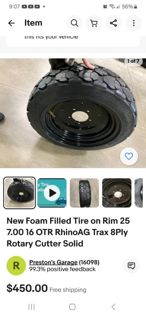

Proble we have is too many of them nasty black locust thorned trees on our property and i get a flat everytime i mow etc...Is it good to foamfill the front tires? $500 for front tires only.Any downside to foam fill?If they last 5 years it will save me money and labor. 7 16G.1W is on front tires.Suggestions please

I retired from highway dept. They foam filled their front tires. only thing is, If you have to remove the tire for any reason. You have to cut the tire off the rim or buy a new rim.

If you are considering using tweels, be aware they do not hold up well with heavy load. I mow (Kubota ZD1511) pasture paddocks behind the cows and looked into tweels to smooth the ride. My mower is too heavy and will cause the tweel to split/blowout.
