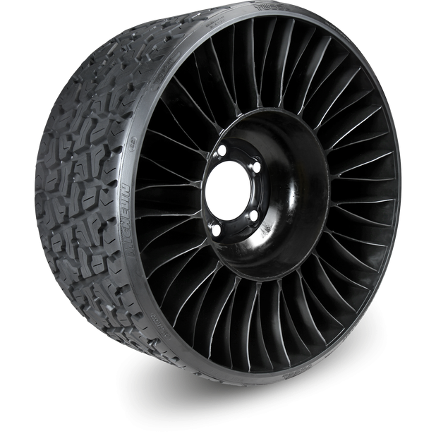

Maybe tweels will solve your problem.
I bought a set of these suckers and they will kill your back.....like riding on stone wheels. It looks like that they were designed to give on impact....well your mower needs to weigh 5x or so of commercially available machines for that to "might" happen. Well my 61" 36 HP commercial mower with an upgrade (comfort) seat didn't fit the bill. Very dis-satisfatied "puker" of my money!
