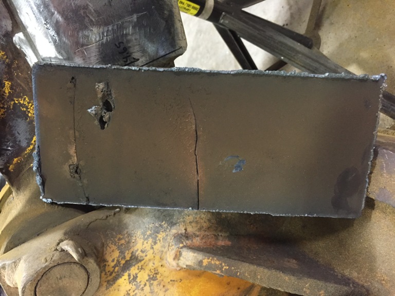

Here is what the piece I removed looked like on the back side!-

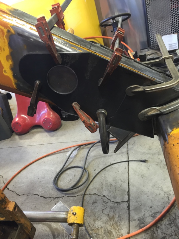

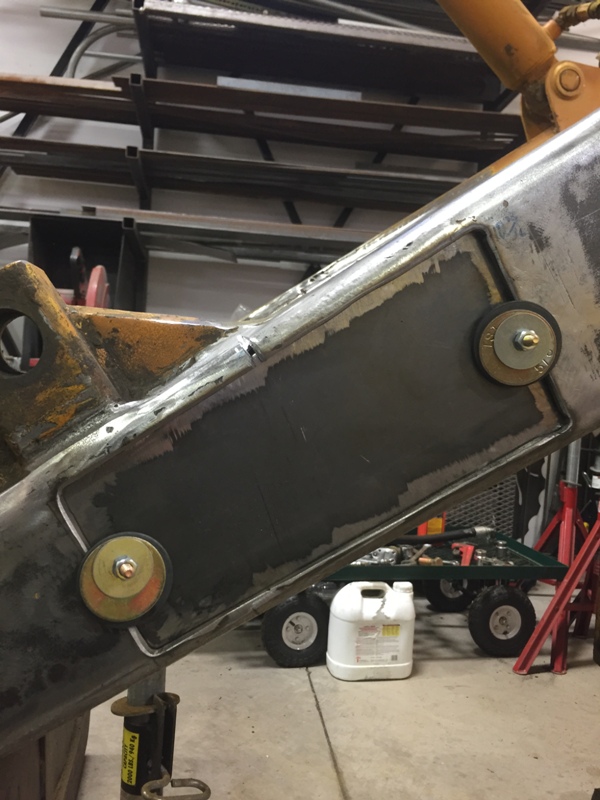

Then, I had my CNC plasma cutter make me a piece of 1/4" plate that was a bit bigger than the hole I had just made. By welding some bolts to that piece and using nuts and washers, I was able to draw it up tight to the inside of the loader arm for welding-

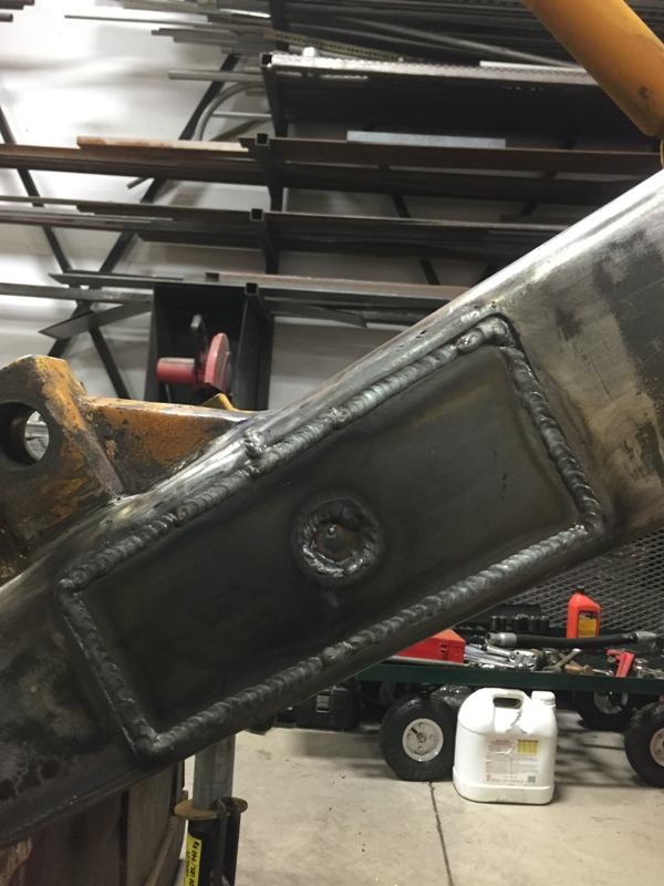

Then the bolts get cut off, welds are finished on that piece, and I weld another piece CNC cut to fit inside the welded area-
That ties it in nicely. I then ground down any high spots and clamped on then welded the first over sleeve-

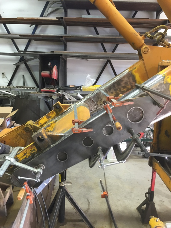

Then once that is welded where where the second over-plate will cover-the second one gets clamped and welded on-

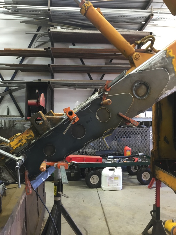

The inside of the arm gets similar treatment-
Then the process is repeated for the other side of the loader boom.
   / I got a Tractor!
#62
Then there are some top and bottom plates that sandwich the whole thing, but those photos aren't loaded in the computer right now. At this point the loader arm repairs are actually done, so the project is now pretty much up to date.
