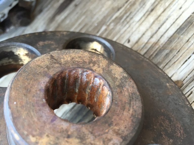

Lets start off with the front pump area. The pump coupler was just about worn out, the pump bracket was for some weird reason welded up with a bunch of junk, and the front motor mount was unhappy.

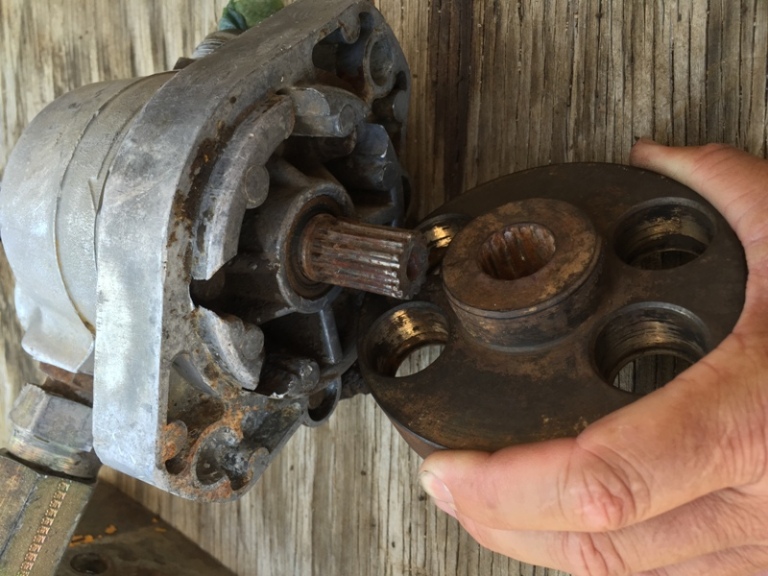

Here is the coupler and the pump shaft. Kinda hard to tell, but the splines in the coupler are nearly gone-and for some reason, they never had full depth engagement.
A bunch of internet parts searching turned up a part that matched the original part number as NOS at some dealer out east somewhere. A call to them on a price for this little beauty developed a nearly 800 dollar price tag! and they weren't even sure it came with new isolating bushings or was even actually the correct part! Correct or not-I wasn't about to part with that kind of scratch, so I hatched a plan to fix the one here...

Here is a closer look at the worn splines.

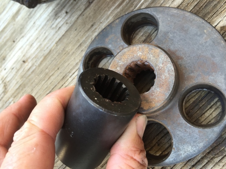

Here is the 12 dollar spline coupler I found that had the correct spline count-
And here is the coupler getting bored out to accept the new splines-
