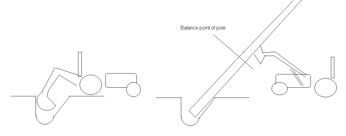

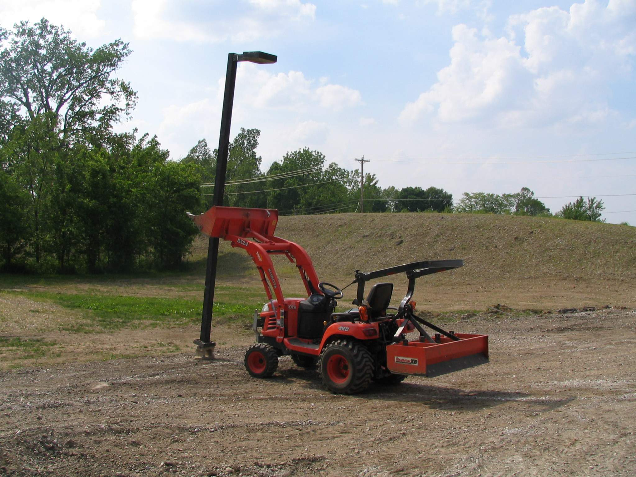

I have set this 30' pole several times (I use it temporarily in different spots) with the FEL. Once I have dug the hole with the BH, I drop the pole with with the butt end next to the fresh hole. From there, I just lift up the top end with the FEL and drive forwards. The teeth on the bucket keep it from sliding left or right and it drops right in the hole. I hold it there until I back fill some dirt by hand and then finish the job with the FEL.
Using this technique, from start to finish I planted this class 5 pole (in the picture on the right side) in about 20 minutes by myself. Several months later, I did the same procedure in reverse and removed it in about the same amount of time. My FEL barely lifts this pole so I am guessing it comes in at around 550 lbs.

That's a pretty tall pole there. I am no safety freak, but that seems like
a good opportunity to put your ROPS to use. So the pole does not flip over
the bkt and hit you.

I did have the ROPS up, but as you can see from the drawing (third pic below .... it is hard to see), because:
A- having the butt of the pole in the hole
B- with the balance point in front of the tractor
C- The fact that the FEL was able to lift up the entire pole
The whole process went surprisingly well. Using the tooth bar with a chain, the ROPs and the other 3 factors, I think I was pretty safe. The FEL bucket eventually goes beyond the balance point as you push the pole vertical (this is where the ROPs is key), but by that point, the butt of the pole is wedged into the hole so it cannot come back out. The fact that the BH bucket is only 12" wide and keeps the pole from going left or right helps a bunch too. I have done plenty of things that in hind site that have pushed the safety limits of things, but I feel pretty good about this setup. Having worked around poles most of my adult life, the one thing that always surprises me is how much taller they look when they are vertical (see the light poles on the trailer)
You don't have the same situation. You are only picking up one end, and the pole is sliding into the hole. His pole was chained to the bucket, and had full weight on it, and apparently it dropped or slipped for some reason, and overloaded the hyd circuit.
