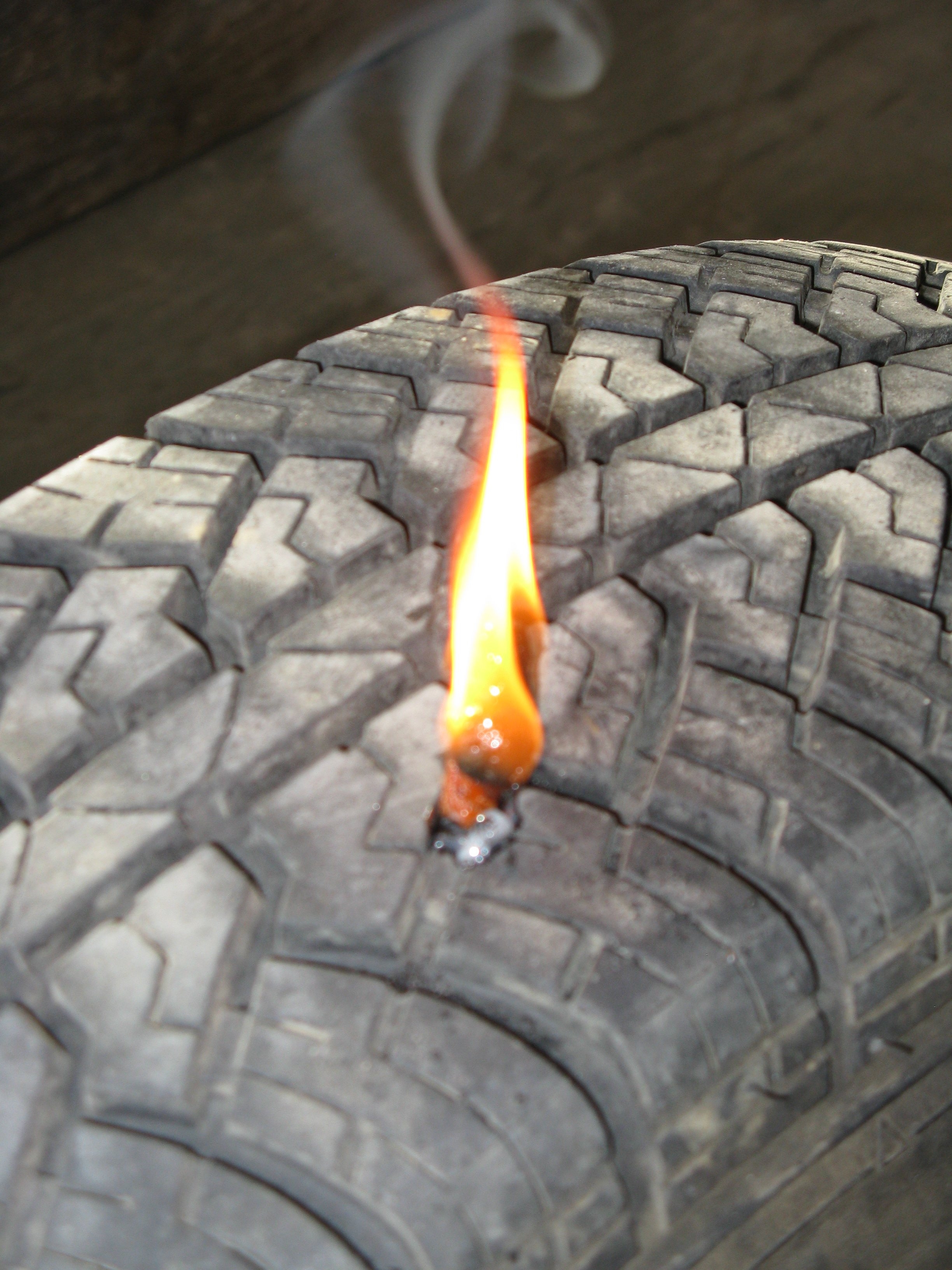

The thing I didn't expect were short lengths of rebar, like the one that punctured my 15' industrial front tire.
Now my regular repair shop won't work on tractor tires, even though they grew up on a farm and always had tractors there.
So I went on line to find some Hot Patches for a do it myself job, like CAMEL, the ones we used to set fire to. Seems like I missed that boat. Amazon has 25 choices with no real information on how they work in a tubeless, I assume, bias ply tire. What would you all recommend I get to do this job? Am I better off just buying a tube?

Try Safety Seal. Their plugs work great.
Since you'll never get them hot by driving, like with a car, don't cut the excess off and light the ends on fire instead. That'll vulcanize the fix in a minute.
Of course, do put the fire out before it's all burnt.
