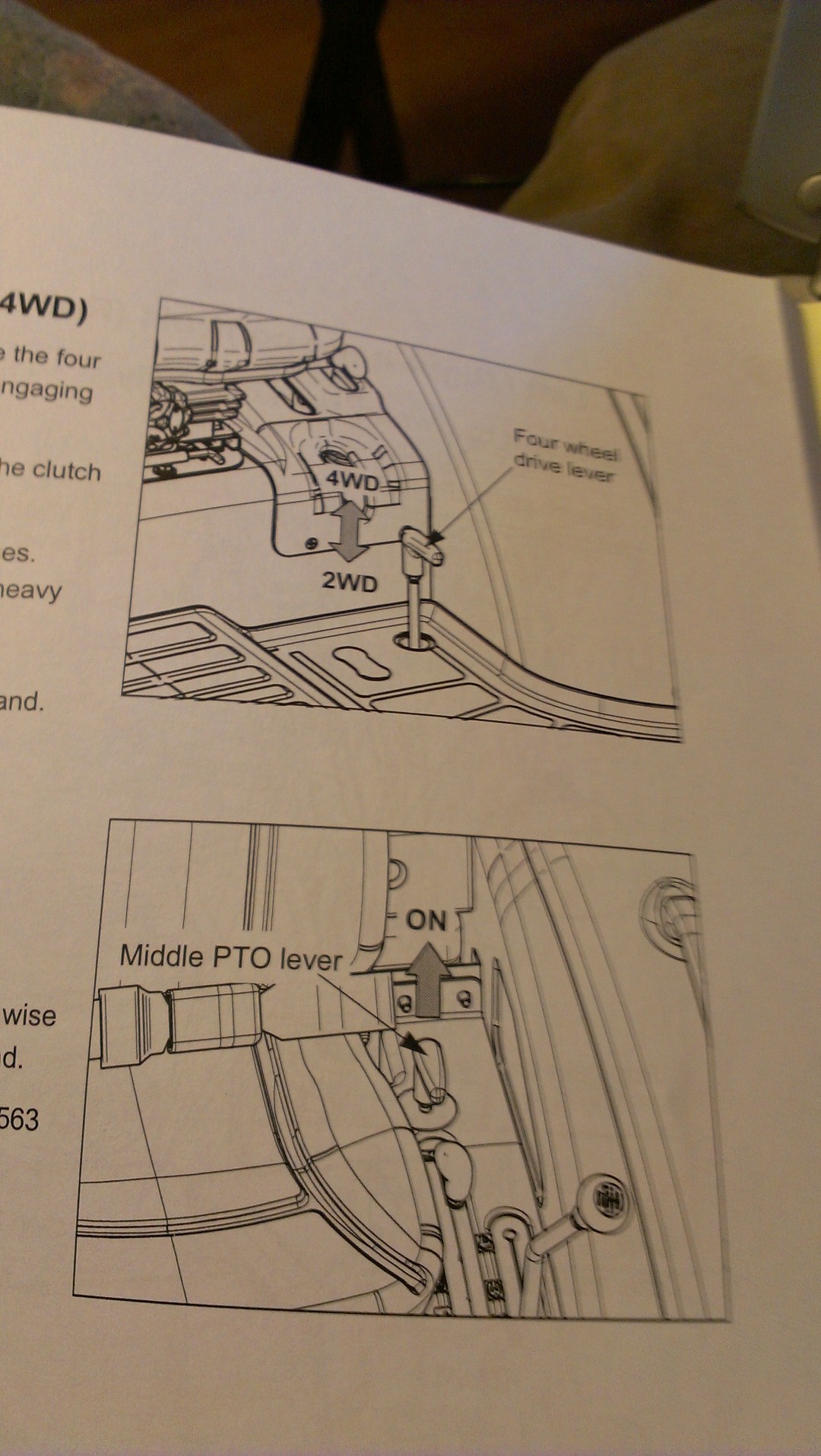

Are the XR's different? I'm pretty positive my R4047 is down for engaged, up for 2wd.
Yes, on the XR you pull up to engage 4WD. (see pic).

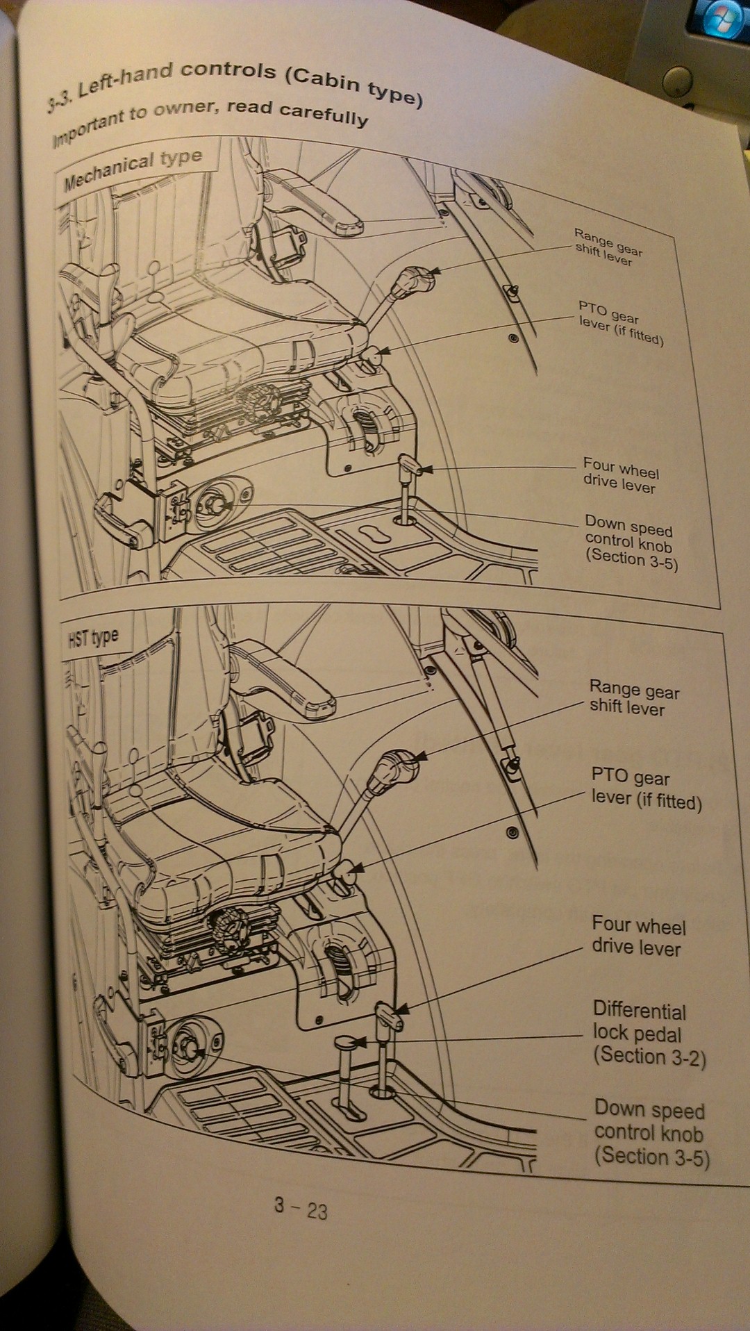

Also a pic showing the diff lock next to the 4WD lever on HST. Its on the right side on gear models.
On my 4046 you pull up on the lever for 2wd. Lever down is in 4wd. That's what book says and the sticker behind the lever shows. I'm guessing the 4000 series is opposite of the 3000 series then?
   / I did it. New XR4046H in the garage. #20
I didn't know the 4000 series was opposite. Post 14 shows my 4WD is to pull the handle up. Dont know why LS wouldn't make it the same on all models.
