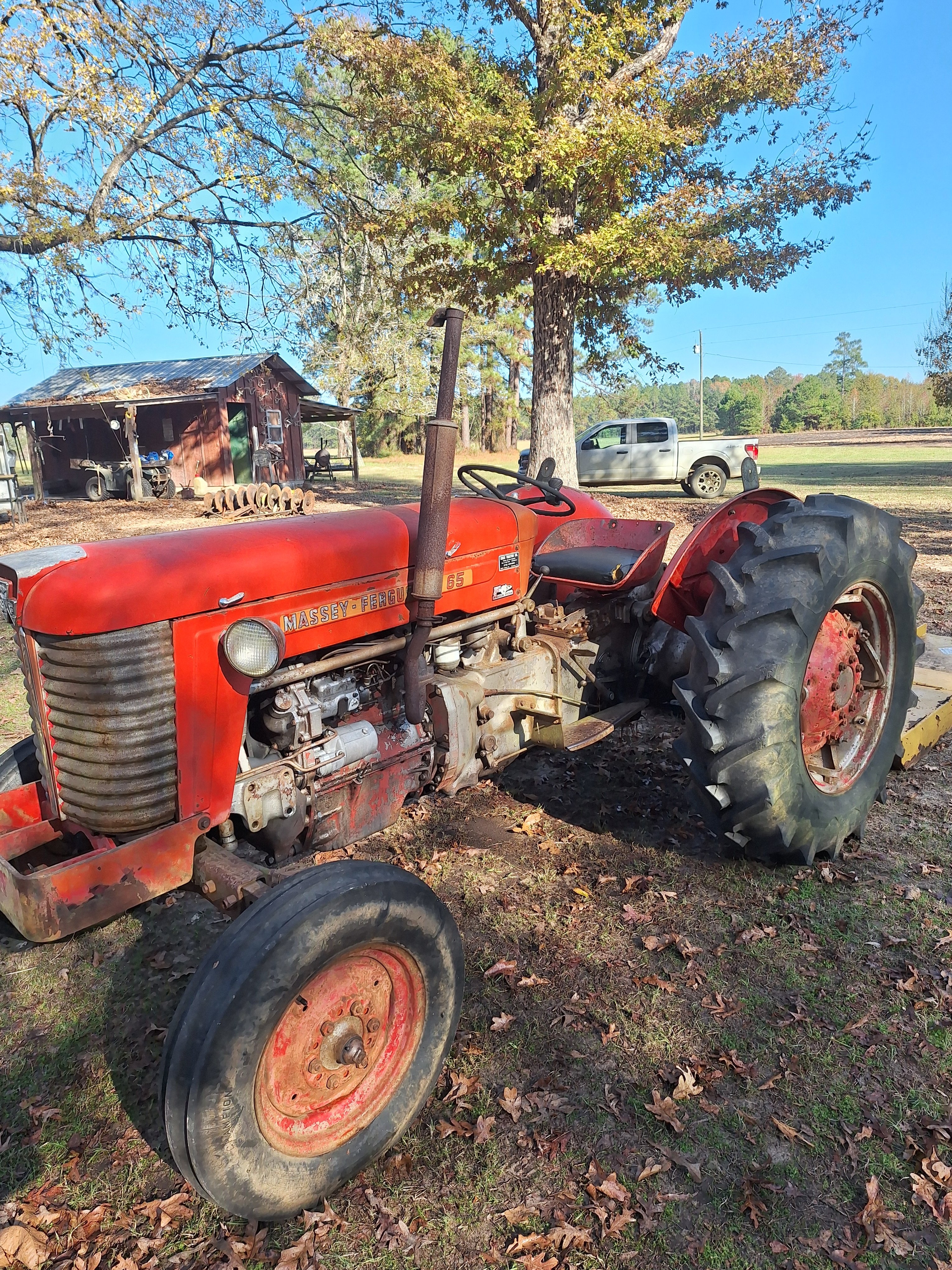

I recently purchased a Massey Fergusion 65 diesel year model 1963 I understand that there are 2 different diesel engines a 3.1 ltr and 3.3ltr how does one tell the difference

I believe the 3.1 is referred to in the parts book as a "Regular Diesel", while the 3.3 is referred to as a "Direct Injection"
Here is a comparison:
Feature Indirect Injection (IDI) (A4.192/A4.203)Direct Injection (DI) (AD4.203)
Engine ModelPerkins A4.192 (UK/Overseas) or A4.203 (US)Perkins AD4.203 (UK/US late models)
Displacement3.1 liters (192 cu. in.) or 3.3 liters (203 cu. in.)3.3 liters (203 cu. in.)
Fuel DeliveryFuel injected into a separate pre-combustion chamber.Fuel injected directly into the main combustion chamber.
Injector AngleInjectors are mounted vertically in the cylinder head.Injectors are mounted at an angle (canted).
Piston TypeFeatures flat-top pistons.Features bowl-type (dished) pistons.
Fuel EfficiencyGenerally less efficient.More fuel-efficient.
StartingCan be harder to start in cold weather.Better cold starting performance.
Power OutputA4.192 made about 54 hp; A4.203 IDI made about 57 hp.AD4.203 DI made about 58 hp.
How to Identify Your Engine
You can visually identify which type you have by observing the injectors:
  • Vertical injectors indicate an indirect injection engine.
  • Angled/canted injectors indicate a direct injection engine.
Another method is to check the engine tag or serial number prefix, where the "D" in "AD4.203" specifically denotes direct injection.
