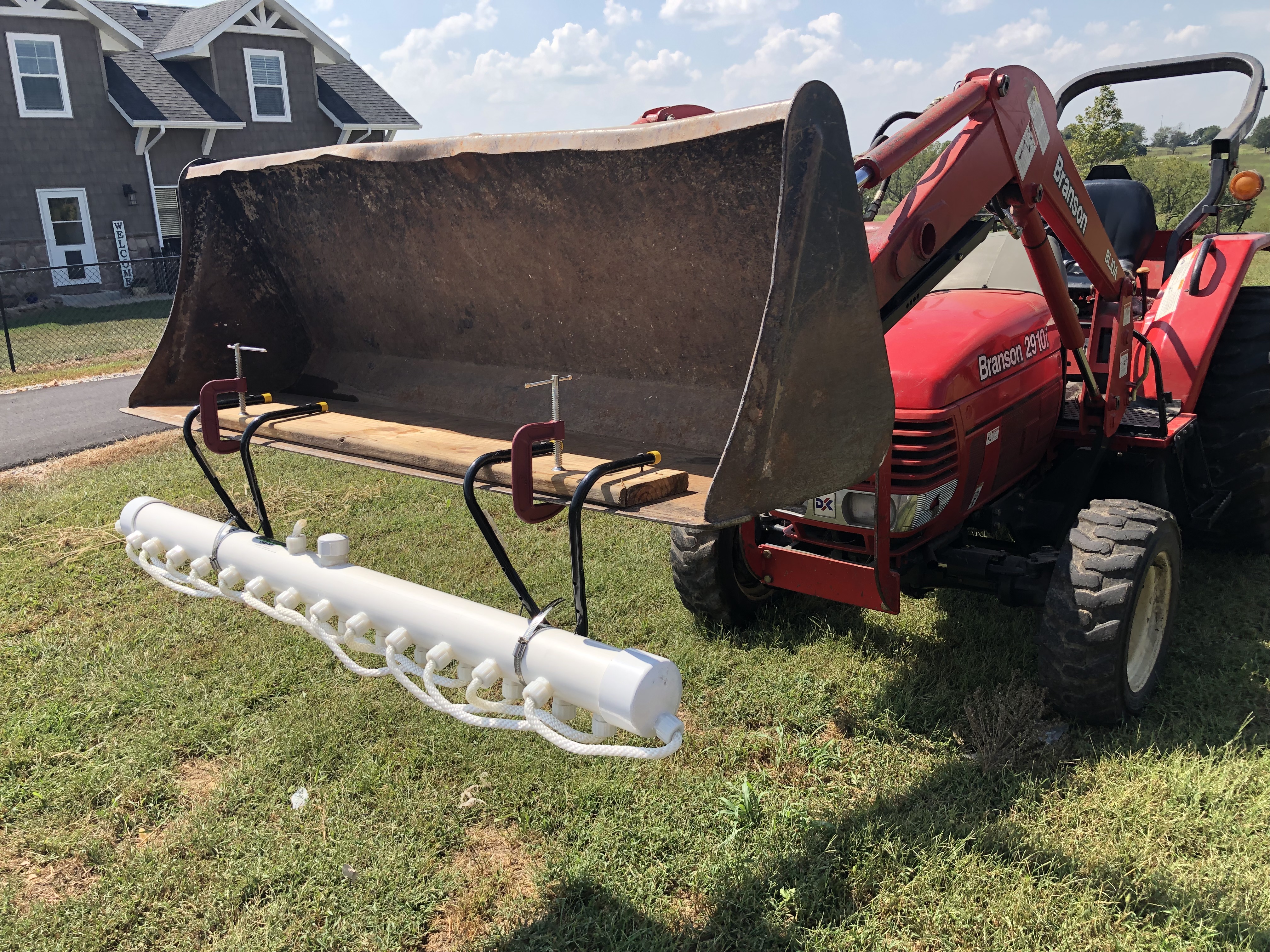

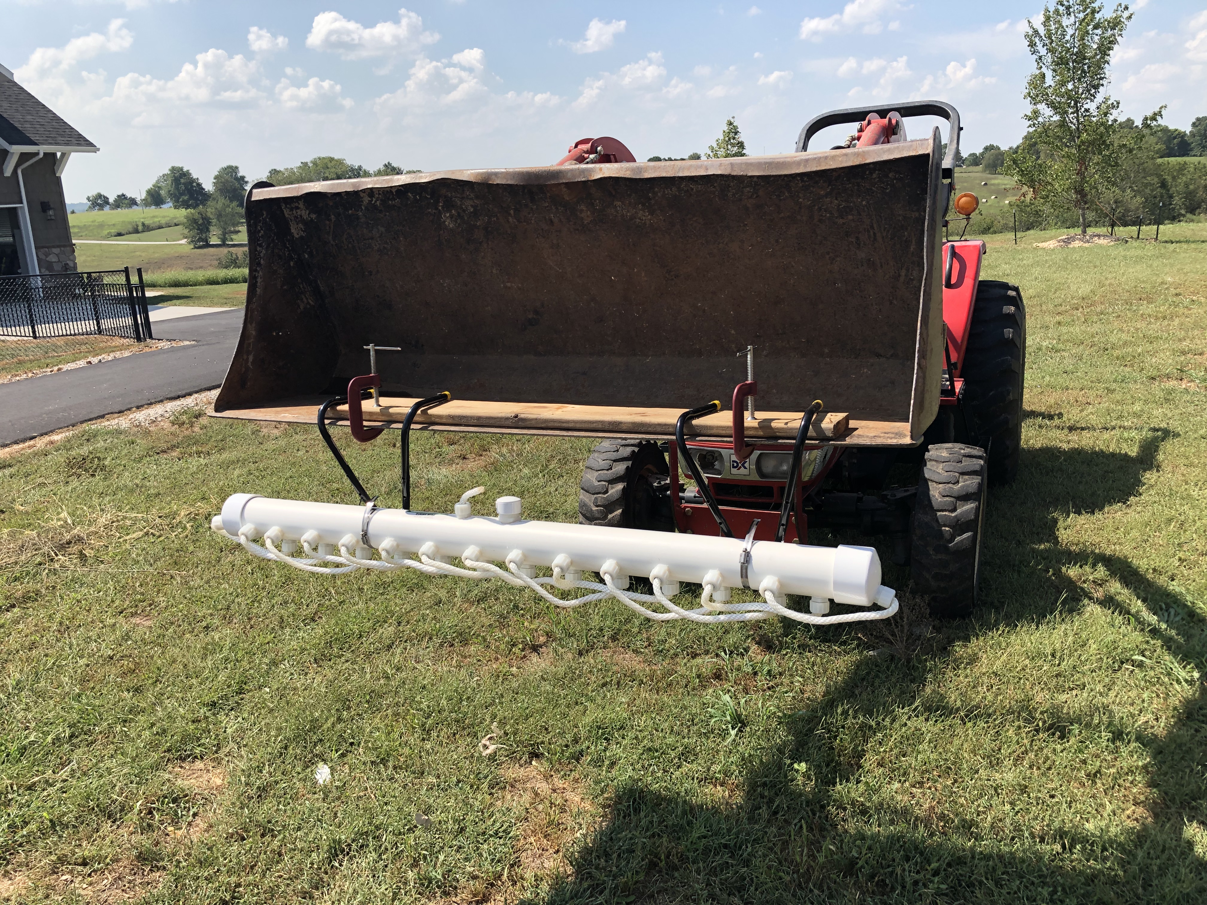

The Johnson grass was here when I bought the land and not surprisingly it痴 spreading. I didn稚 want to do an all over spray since there is great red clover and orchard grass everywhere else. So today I hooked up the wick applicator I bought online, loaded it with glycophosphate and water 1-1 and started wiping weeds. I値l know how effective it was in about a week. Guess we値l see.

That is interesting. Please give us a pic of the result and your evaluation. I've never tried that set up.

I've got one of those and the farmer I bought it from swore by it. Guess I never got the hang of it. so I walked it all down with a 4 gal. sprayer.
But do have about 1/4 acre of it left. So here is my plan: using the Pat's hitch will use the two hitch points to hold the pvc and then able to lower the wicks closer to the root and crawl through the grass slowly. Hopefully give them a good soaking.
May not have gone slow enough the first few times I tried.
By all means let us know how the kill rate works for you.
I need the encouragement...!
Looking at your pics a bit closer noticed you used the same large hose clamps I did. Now I'm thinking the secret is to prevent the pvc pipe from rolling with the grass and reducing the contact patch between the grass and the wicks.
So now will have to find a way to secure the pipe to the rear hitch points and prevent it from rolling.

Used properly, they work great.
Once the ropes are saturated, keep the wicks just above the desirable vegetation.
Proceed at an average walking pace. (Roughly 5 mph).
Post results please. Thanks.

I’ll definitely let you all know. My speed was well under 5 mph, probably closer to 2 mph. I wanted it on pretty good. I could see the dampness on the leaves as I drove, not saturated, but at the concentration I used, it didn’t need to be soaked.
/ I declared war on Johnson grass
#13
Honestly if I get 80% of it the first time I’ll be happy.
