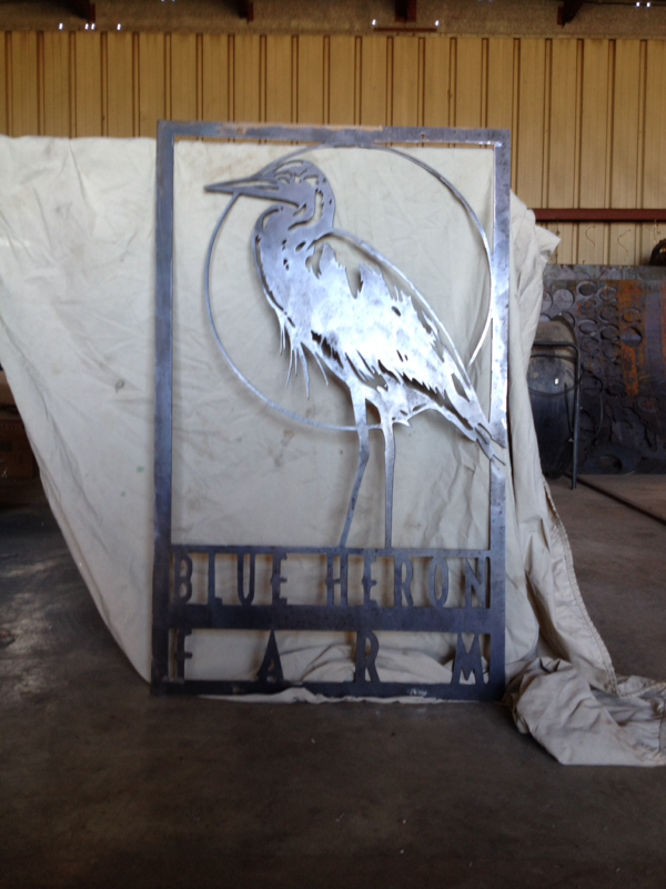

It is impressive ... I'm amazed everytime. Take a picture, drawing whatever and before long its being cut. It boggles my mind! I'm a computer idiot and to think someone had to write all that programming .... move this direction, cut here, up down ... when I get one cut ...I'm kinda like "oh ya man" !!!!
there is quite an extensive learning curve, that is the truth. I thought it would be easier to get up and running, but it took quite a long time. I use mine in the beginning making craft faire items for the wife and made lots of custom framing brackets for log and timber framed homes. The brackets were cool cause you can add an elk to the bracket, or bear, or whatever. They were cut out of 3/16 and 1/4" plate, complete with bolt holes.
The crash of housing in 2008 pretty much killed that work. Housing is up, but large custom log and timber framed sure havnt restarted. At the craft shows, no one had $$$ to spend, so the wife lost interest.
Nowdays i use it mostly to make whatever part i need at the time. I used it ladt week to make 2 base brackets for a 12' steel curtain rod to cover access to a jacuzzi.
I make parts for a couple of custom hotrod builders in the area who also use my box brake and roller.
My next project will involve making some custom exterior lights for the house. They will take several trial and error projects.

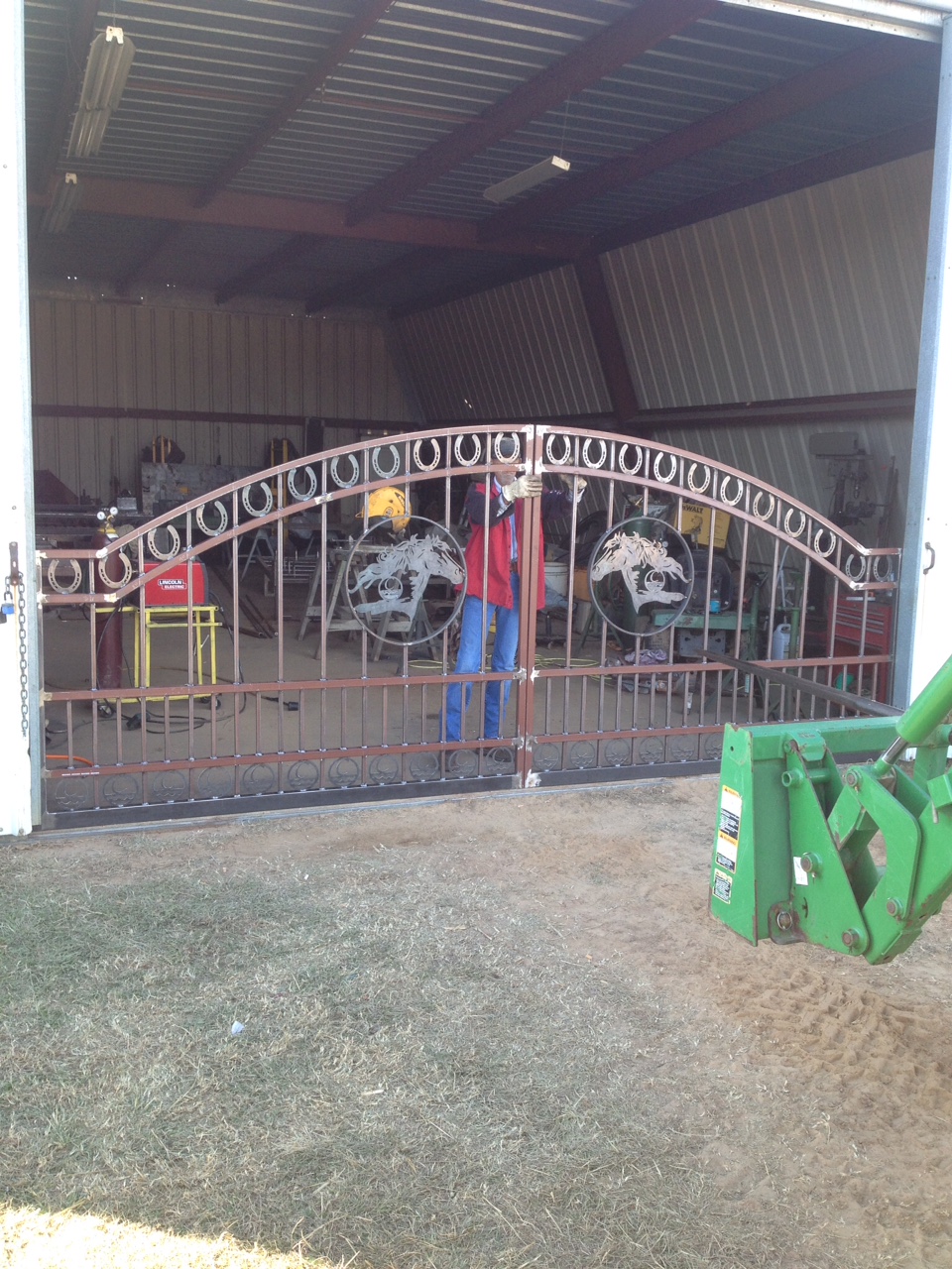

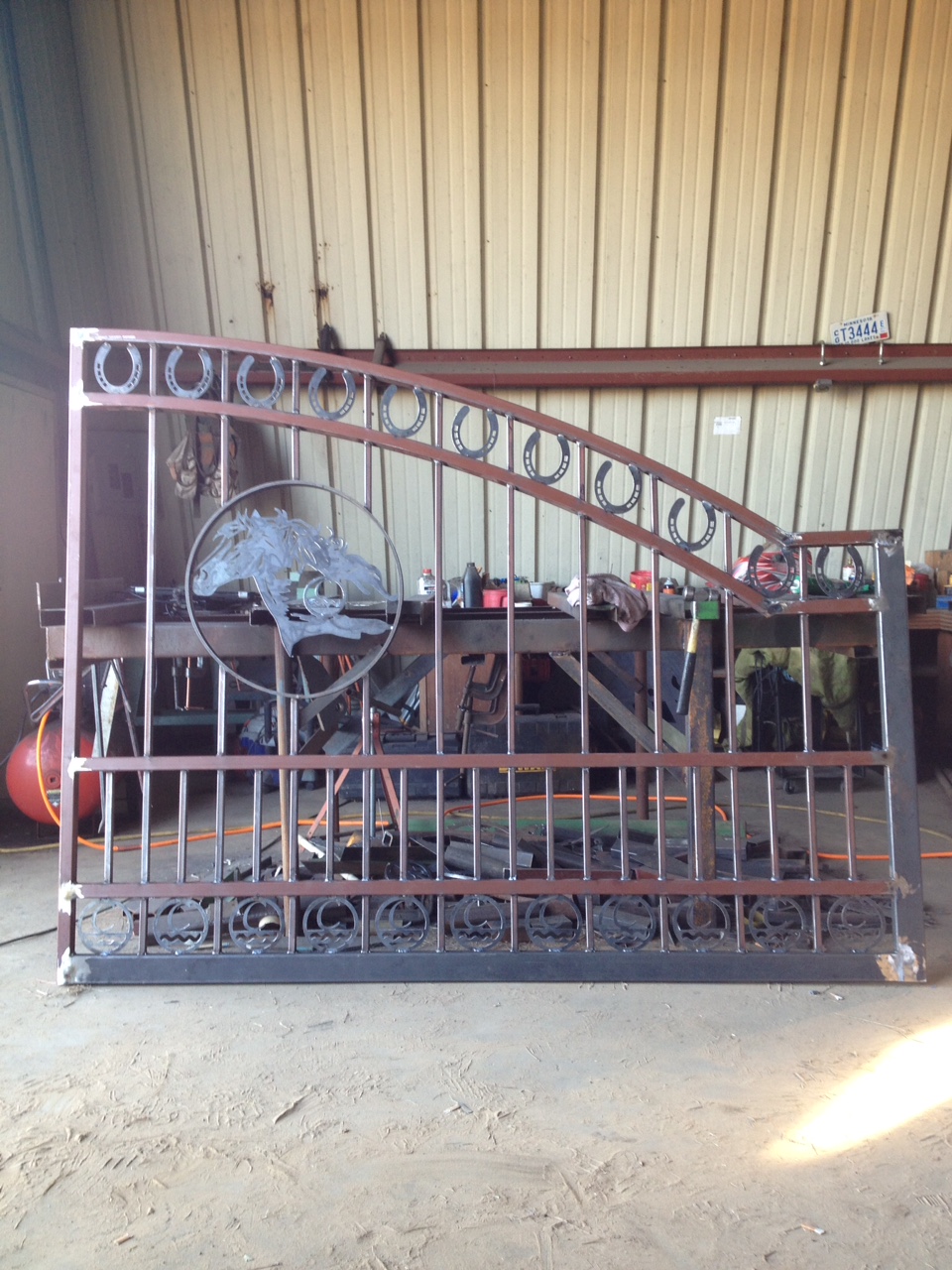

Yes they are level ... the last picture the wind blew one open a couple inches!!

wow, very cool stuff you make there !
makes one think to save for a mini plasma table to fool around with :)

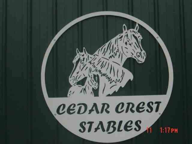

I just love that horse head cut out you used in the gate!:cool2::cool2: When my oldest granddaughter was taking riding lesson I cut this one out for her instructor.
