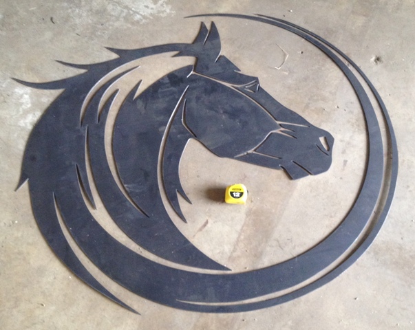

I cut this yesterday

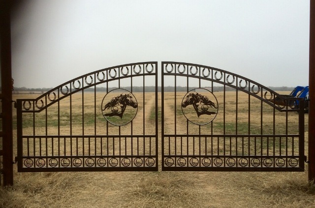

I love this gate!:thumbsup::thumbsup::thumbsup::thumbsup::cool: There is another member here who also made an amazing gate.
Thanks .. I really enjoyed making it .. Used a HF tube roller with the swag off road die and jack kit and the pipe threader for the drive motor to roll the tops and the rings.

Nice, if I had a plas table I'd ask you for a copy of that! Bet that made some neat scraps also!
It did leave an impressive silhouette!!

Made this for a TBN member and shipped UPS to South Texas

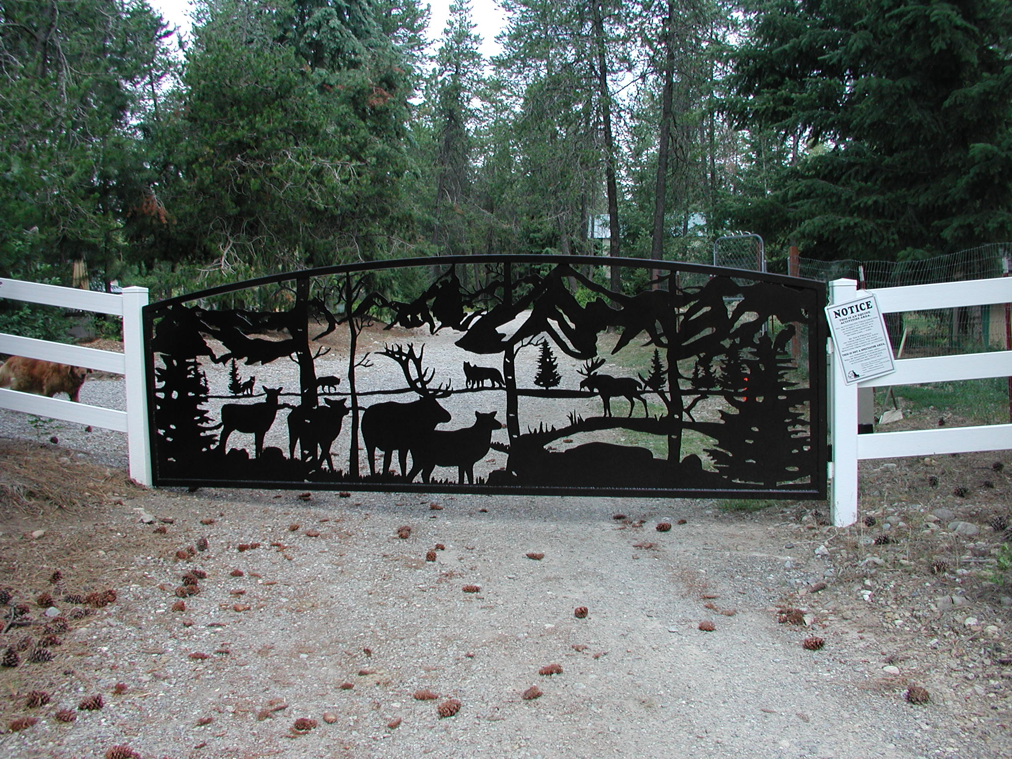

plasma tables are fun. this is the gate i made. my wife did the artwork. i did all the slave workP7261323.JPG
used 600# of steel to make it. had to install a 1/4" thick 5x5 into ground to free support the gate. no wheels needed to use.

Nice job ... Thats awesome. What size table and what cutter?

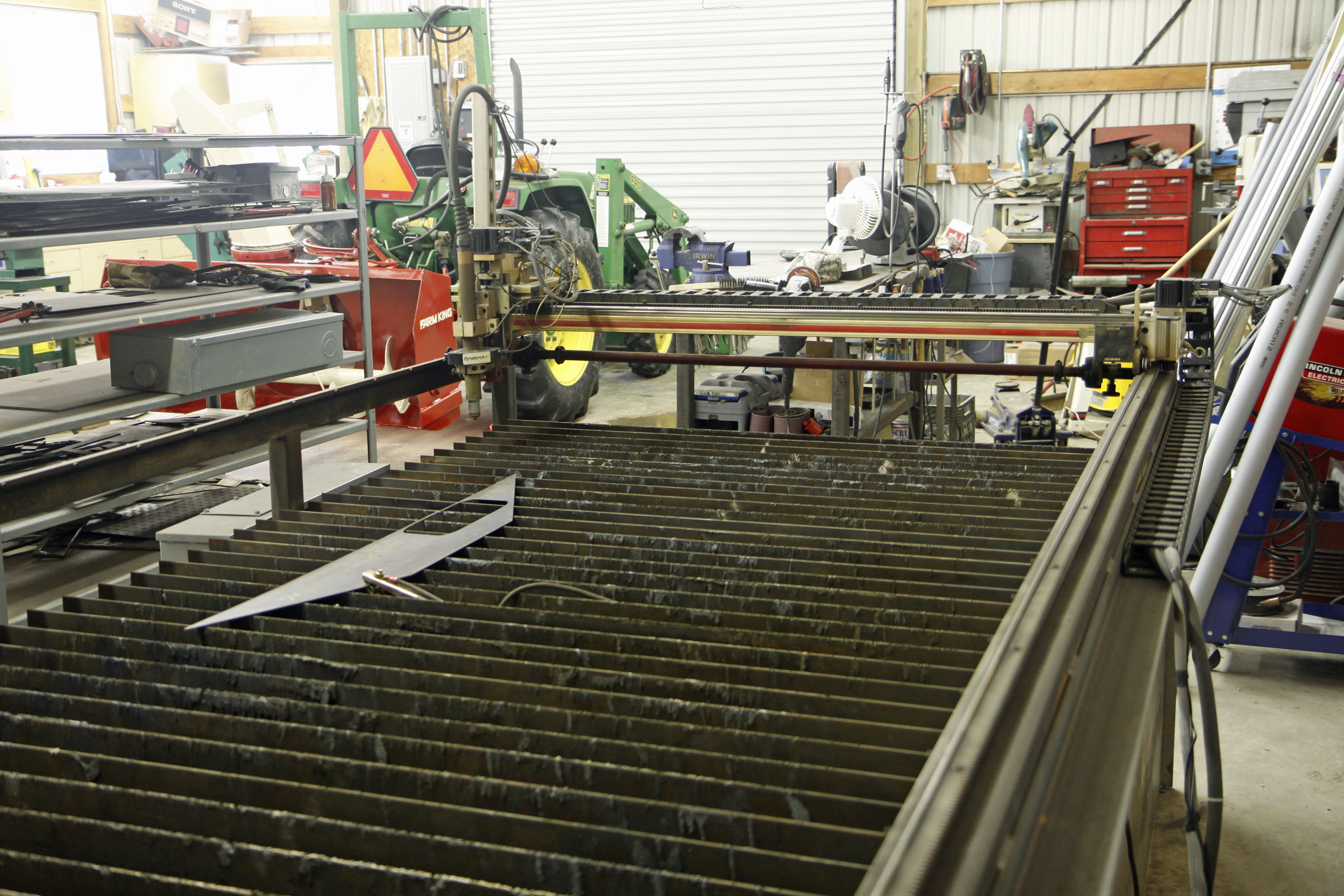

hypertherm powermax 1000 and a dynatorch 4x8 table.

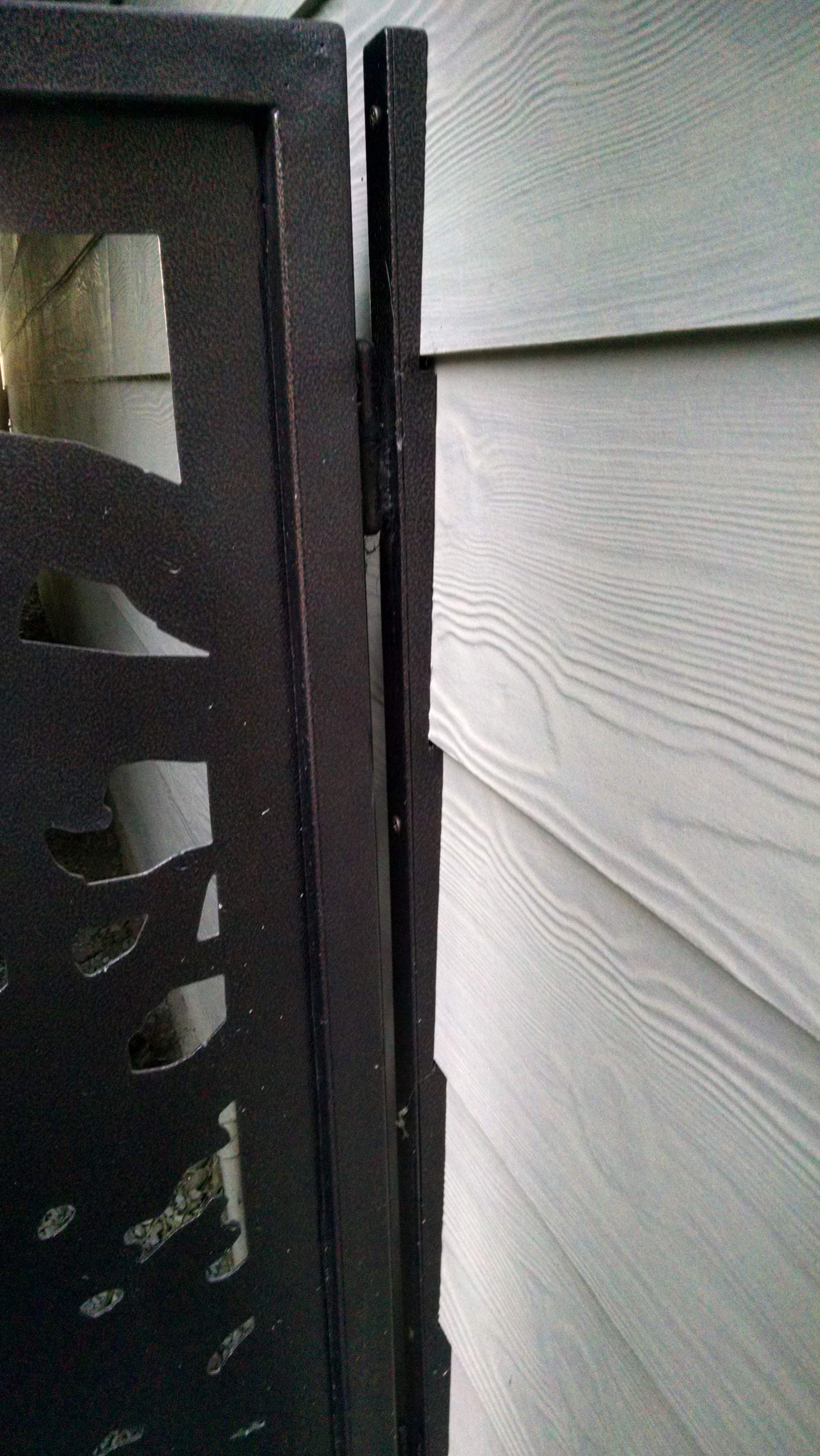

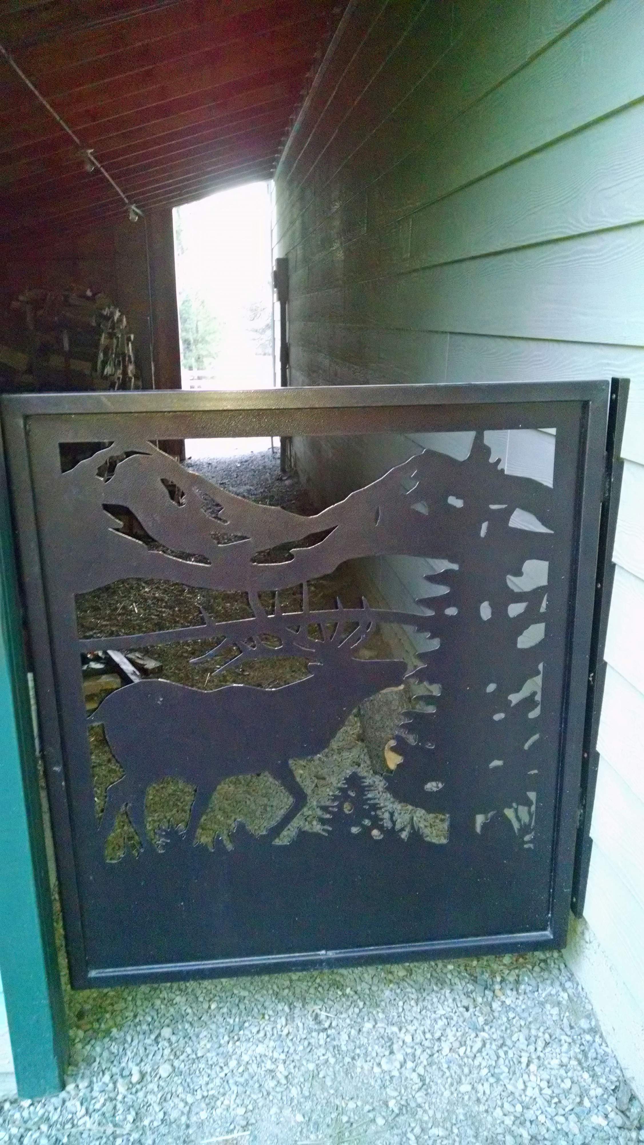

i also made a smaller access gate. i had to figure a way to attach it to lap siding. again the plasma torch to the rescue side gate 1.jpg side gate 2.jpg

Two sweet pieces of equipment!!! I like that gate .. And the cut out to fit the siding .. Great job!

Great looking gates and awesome table. I gotta put a plasma table on my bucket list!
