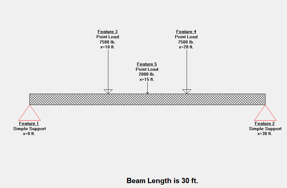

so you dont think my drawing on the picture will be sufficient? (assuming the beam is the correct size), starting to sound like this may be more trouble than its worth. Maybe I should just live with two poles as the support.

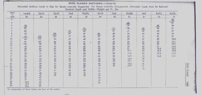

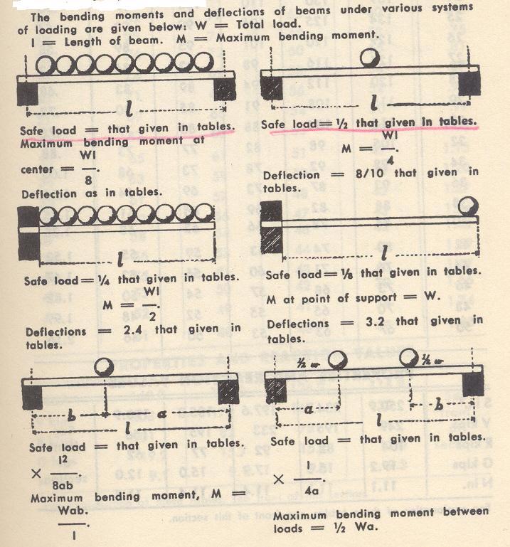

All pretty good advise, a 10" x 12 lbs per ft beam seems extremely light for your 30' span. When calculating you must factor not only your the span and the
dead load ( the roof itself )but live load ( roof + snow/ice + loaded trolley while at center span ), to properly size the member. If you're buying this iron new you may be surprised at the current prices.
