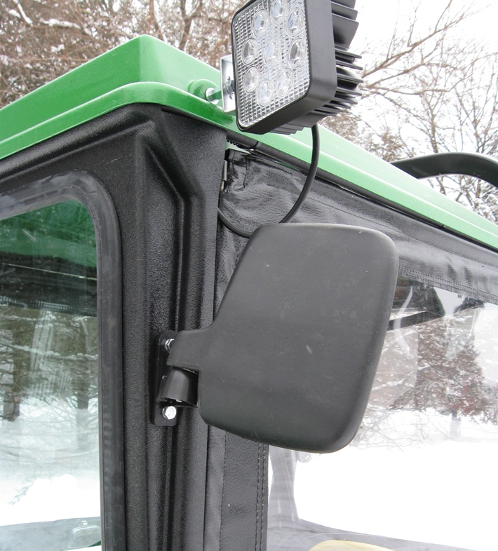

trying to figure out how and where to mount LED lights for the front, also have a Berco soft cab that makes it challenging-dont want to poke holes in it to mount the light.

Based on my experience you need lights mounted high. My OTC soft cab has a hard top which simplified the mounting. Does Berco have a patch kit for making penetrations through the fabric?

Is there a place you can attach some brackets anywhere on the front, that could extend up to the roof line?
Or, how about magnetic mount lights? Strong enough magnets, could sit on top of the vinyl, but hold the steel underneath.

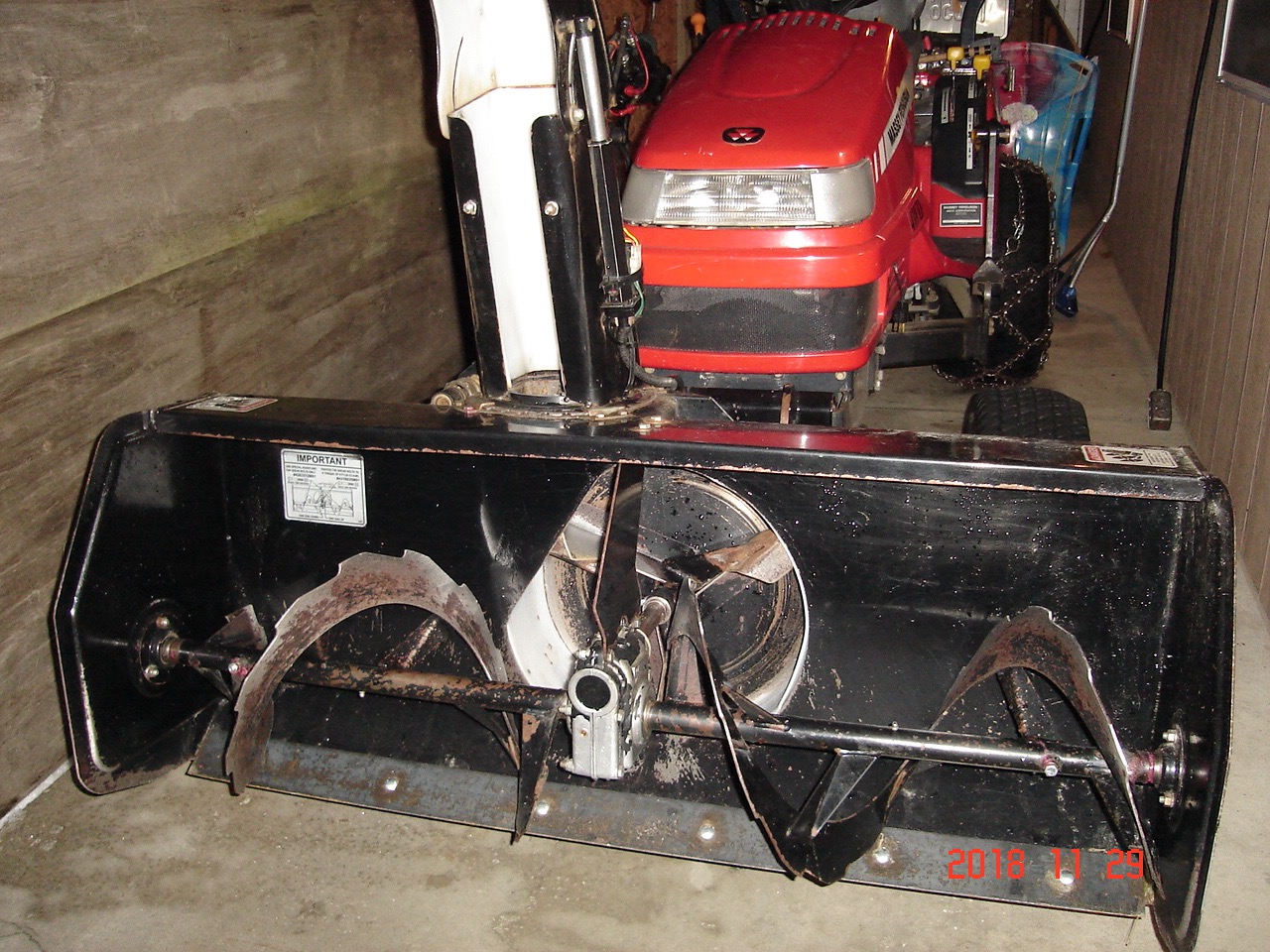

The boys over on the snowblower forum do the impeller kit mod to take care of blowing the wet slush. Basically, the slush does not get blown out because of the gap between the metal impellers and the impeller housing. They bolt/rivit thick rubber pieces on the end of the impellers so there is not gap.
The blowers they discuss are the walk behinds, but no reason it would not work on a pto driven snow blower

The only snowblower I have that worked was my Woodmaxx, but it would only throw\dribble 10 feet. I had 8 inches of snow then it turned to rain for the next 6 hours so the snow was over saturated, I have never seen this much snow this saturated before, never. Loader came to the rescue :) My 31 inch wlk behind Husqvarna was worse....My ATV wouldnt push this snow more than 10 feet before it would spin.
I sometimes think Im clever, when mother nature throws something at me a few times that Im unprepared for - I prepare for it for next season. This one was\is a head scratchier and NO snowblower front or rear would handle this stuff well no matter how many RPMS you throw at it. Even if you did manage to throw it 30 feet it would destroy everything it hit.

The LED lights still not sure but I know I need them, bought a set of two from TSC which may or may not work....if not I will try a rechargeable LED bar velcroed to the cab.

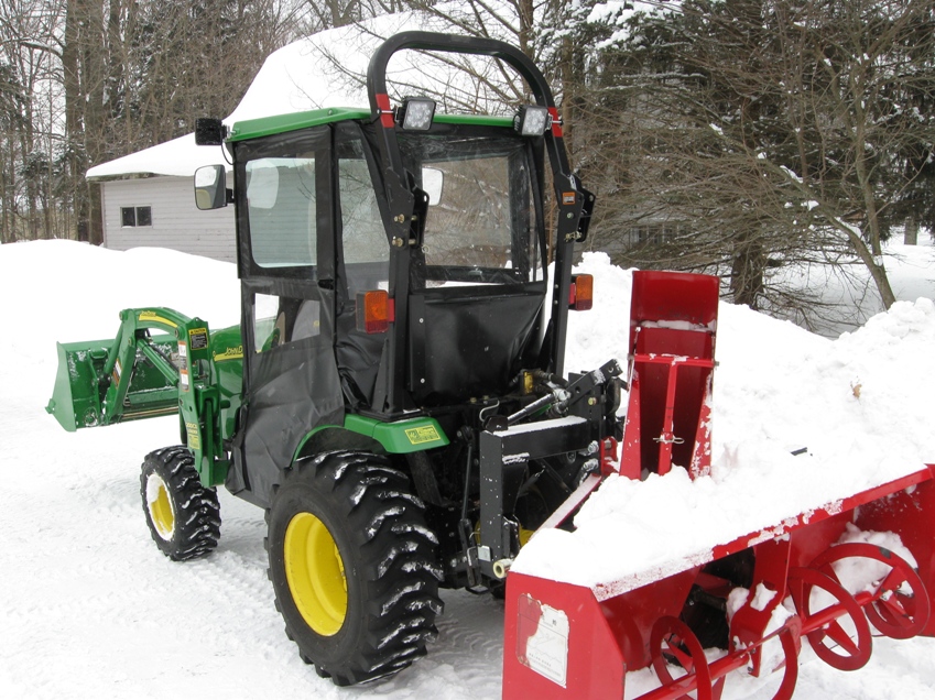

This rear blower was going through drifts so hard you could walk ON them: The 2nd photo is the equipment we then used to do the open area...can your UTV keep up?

If magnetic rechargeable could you stick them on the loader arms or cross member behind the bucket? This would put the light out front but if you have trees they could easily get knocked off.
