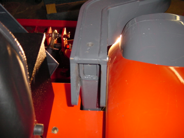

I am having a problem with my ROPS

mech, I had the same problem with my ROPS. I removed them, (they are very, very heavy), turns out the ear or tab on the left side was slightly out of line. It was welded with a bit of an angle which caused it to come in contact with the fender. Just enough to rub the paint when I lowered them.
I put a heavy C clamp on the tabs and smacked the outer tab with a good ole sledge hammer once or twice, touched up with paint and put them back on. I now have a clearance, not much, but enough. Probably could have filed a little off that tab if I wanted, but didn't need to.
I agree that your dealer should know about this, but for me I took care of it in about an hour and I was back on the tractor.

My CK30hst has the older style rops like yours and the right side is my problem. It just touches the fender when I lower it to a 45' to get it into my garage. I'm sure I have scratched the paint on the fender. I haven't dug into the possible fix because of the same thing Hodak mentioned...heavy. One of these days, I'll eat my "Wheaties" and tackle it. I didn't mention it to my dealer because I figured I'd just fix it myself but I would think that is something they should take care of. The shim idea would work but I didn't want to do that for the reasons you mentioned. Maybe a few bowls full this weekend and I can tell you what my fix is. /forums/images/graemlins/grin.gif

Here is plan A. I was out tonight scouring all of my buddies’ tool cribs and I came up with a 10 ton Porto-power. His will both push and pull. The plan is to remove the upper part of the ROPS completely. Connect the Porto-power and apply inward pressure on the part still mounted to the tractor. Then using a wood block and a sledgehammer persuade the left side over a 1/8 of an inch or so. In my book a miss is as good as a mile as long as I don’t hit the fender. I don’t care about both sides being equal for appearance sake. Even now, a few feet away it is unnoticeable. I realize that the sledgehammer persuasion must be done with due care so I will start off very slow and take great pains not to damage the connection to the axel housing. Measurement will be taken! Once the lower half is adjusted more measurements will be taken and the top half pulled in to match. Now, if I all goes as planed, the top and bottom will not be truly parallel to each other. Since it is a sloppy fit to begin with I should have some built-in forgiveness. If not enough space remains I think it would be OK to grind off a 1/32 from each side that faces each other when assembled giving me the 1/8 I would need at the correct angle. Now if the weekend weather will hold I can put my plan into effect! What am I overlooking here? /forums/images/graemlins/confused.gif

Thanks VictorW, Highbeam also mentioned that, so I now have plan B rev.1. I am going to cut a piece of schedule 40 2 inch steel pipe the exact width of the current configuration. I will install it between the post just below where I would like the bend to occur. This should take away the lever action on the cast housing and bolts. I will sandwich it between C clamps to keep it from sliding up or down. The bottom of the ROPS is very beefy so I think it could withstand this minimized pressure without adverse effects.

Hodak, Thanks for the vote of confidence. Problem solved though by a different approach. /forums/images/graemlins/blush.gifI assembled all the tools to do the job, and was prepared to complete it as previously outlined. I decided to remove the light assembly from the fender to prevent any damage when using the hammer. Once removed I had a clearer view of the fender assembly, I also had a better handle ( the hole where the light fixture was) to pull with. A good tug indicated that I would have enough room to operate the ROPS if I could get it to remain in that position. /forums/images/graemlins/smile.gif I scrounged around for something thin enough and rigid enough to rest against the fender. I came up with a large hardwood paint stirring stick compliments of HD. I located a standard 3 foot wrecking bar. I removed the seat from the tractor. I placed the stirrer against the fender the bar between the ROPS and the fender and a couple of good tugs later – Problem Over! I did dimple the fender where most of the pressure occurred, but it is very minor and really not noticeable. Put the seat back on and the installed the light assembly and now I am one happy tractor owner. /forums/images/graemlins/grin.gif Thanks All.

When I originally tried pulling from the edge of the fender there was very little give. Once the light was out and I got a firm grip I was able to pull it right where I wanted it without any separation from the frame. You know the rest of the story. /forums/images/graemlins/smile.gif
It only required 3 or 4 minutes to remove the light with a Philips screw driver. I then loosened the wiring harness unplugged the wiring cable and moved the fixture to a work bench out of the way. So it really doesn't take much time and very little muscle if you have a long pry bar. /forums/images/graemlins/grin.gif
