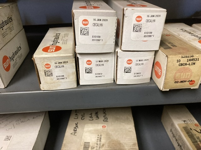

Ok so why would there be two identical valves like that? One for up and one for down?how do these valves work? And what would you do before taking it to a shop or buying new valves? And lastly, how would I know which one is actually causing it?
So, these valves are adjusted and tuned to suit manufacturers requirements for each direction. Two choices when replacing these, buy the preadjusted OEM cartridge valve from the lift manufacturer and plunk them in, or pretest existing valves on your existing cylinder (with known good new seals installed and bled) to witness the factory adjusted pressure, then install new counterbalance valves and adjust on test stand while cycling cylinder off machine. Adjusting your existing cartridge valves blindly can result in bad things happening. Finding the problem valve would require a cartridge body on a test stand or ……hit or miss

Yep your right. I ended up and bought two sun valves. The guy I talked to was Trey of precision hydraulics out of Odessa tx. Real nice guy but when I was giving him the numbers off the valves I gave him the first 7 numbers and started to give him the last 4 and he said “the first 7 is all I need, the last 4 don’t mean anything” so I pushed back on him and said “well they got to mean something, these valves look adjustable, are you sure the last 4 aren’t what the valve is adjusted to” he assured me I would be good to go. I knew it was very unlikely that both valves went bad at the same time and I was wanting to order just one, but the guy that works with me saud let’s just get both of them that way it’s done and we can get to work. Do I bought two, had them overnighted. Got them, put them in. And still leaking down! I guess I’ll try the rest from above to see if the cylinder is leaking internally, this sucks though, out 250 dollars with no change.

Ok so am I right I’m thinking the last 4 digits may point to pressure tge valve is set to? This lift manufacture is no longer selling parts, I do believe they are stilll in business after multiple bankruptcies and sell offs, but they no longer carry parts for these lifts. So should I put the old valves back in and then get a fork lift to do the test you’re talking about? Or should I just go ahead and keep the new ones in? How big of a chance do I have that these new valves will be set close enough? Like does it have to be absolutely perfect? Cause there isn’t even a hydraulic shop within 60 miles of where I’m at, I live in an oil patch but the primary shop that was really good and open for 30 years retired and sold tge business, then about a year later they went out of business because the new owners were sooo terrible.
   / I’ve got a 45’ Eagle towable manlift and bottom boom is leaking down. #44
I suspect last four digits are just a date code and have nothing to do with setting. On previous post you stated 2500 PSI. Was that marked on the valves or where did the 2500 PSI come from? Per Sun the standard setting on CBCA LAN is 3,000 PSI so slightly higher than 2,500 PSI but should work fine if they were not adjusted from standard factory setting.
