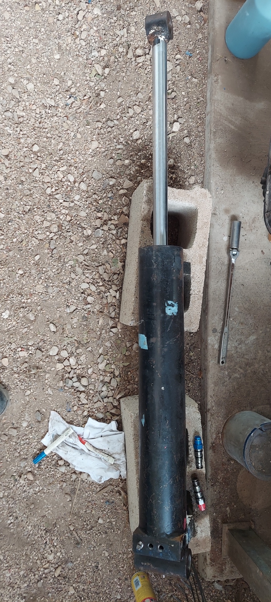

Here’s the whole cylinder I’m guessing this extended with the boom cradled?

   / I’ve got a 45’ Eagle towable manlift and bottom boom is leaking down. #32
Which port on the block connects to the tube running up to the rod end? the nose on one of the valves must connect to this port? That would be the valve for controlling extend.
The hose that retracts the cylinder would connect to port 2 or lower side port of this valve. This would also connect to top port of other c’balance valve.
Same thing the other valve nose of that valve should connect blind or cap end of the cylinder.
The hose that extends the cylinder would connect to port 2 or lower side port of this valve. This would also connect to top port of other valve.
Difficult for me to determine connections even with the pictures provided.
If it would help I could draw you a schematic showing connections.

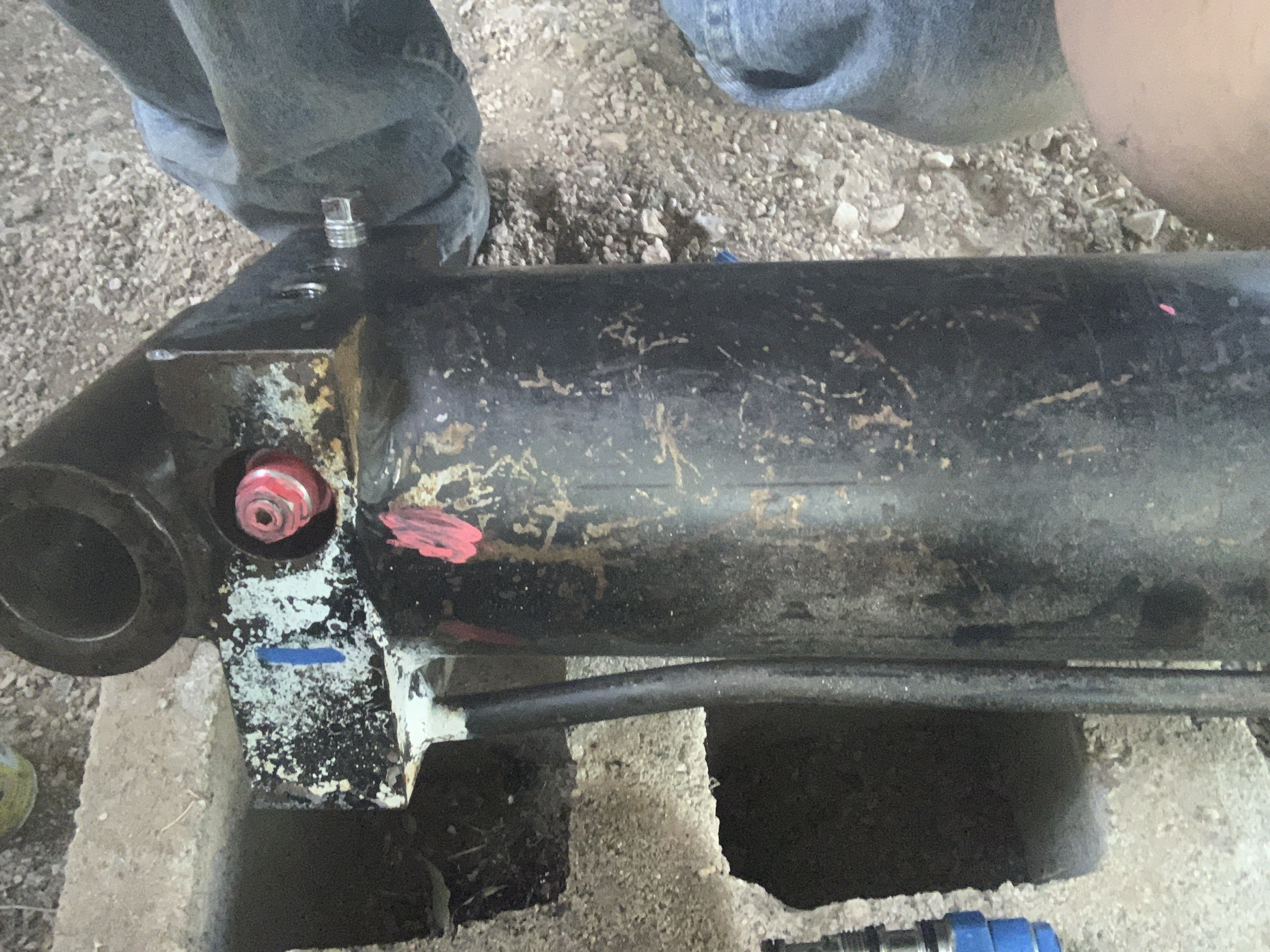

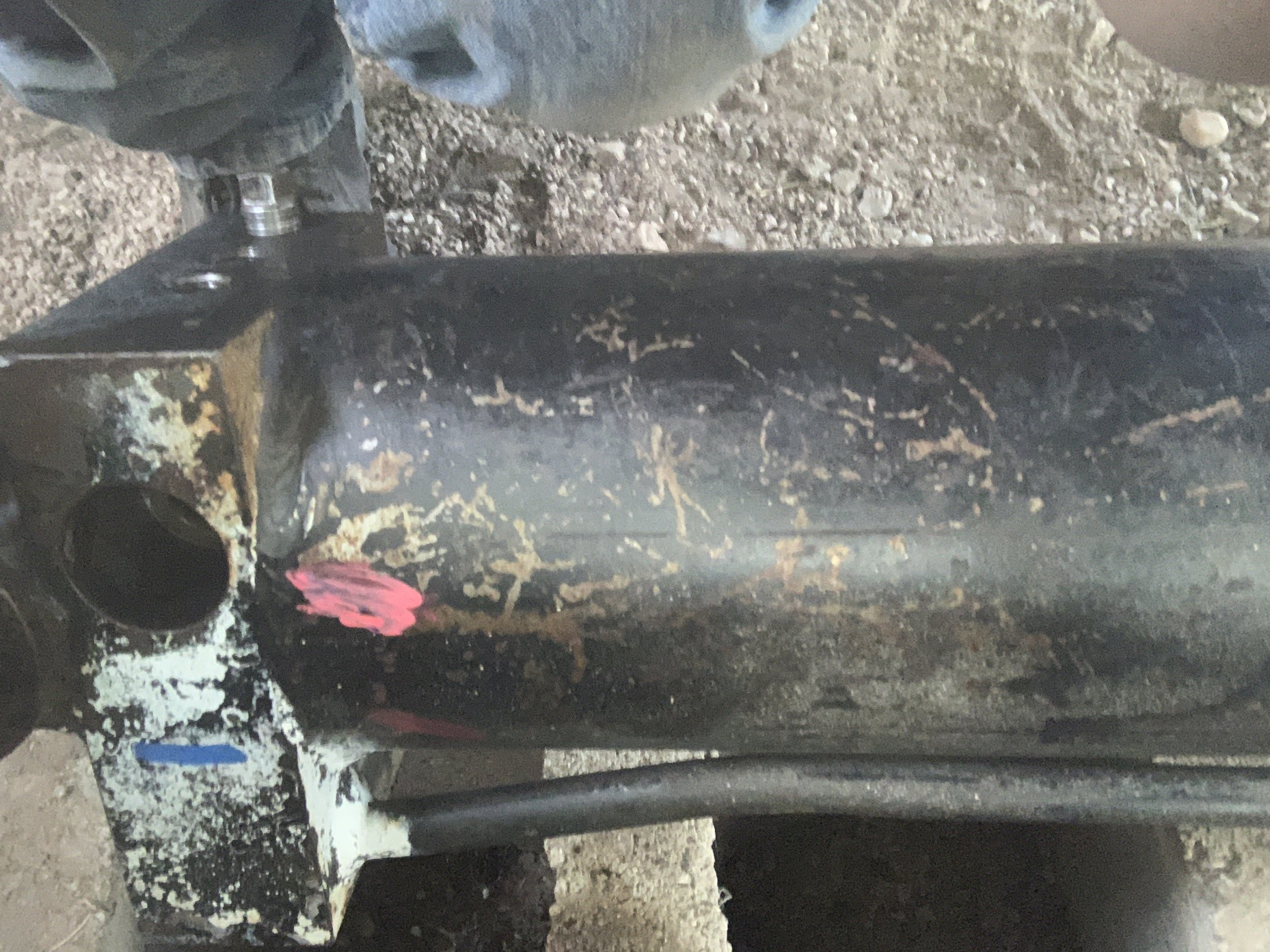

Here’s another one, the one that has the plug in it is “BD.” The blue line is where the blue valves nose would be coming out compared to the red valve.

   / I’ve got a 45’ Eagle towable manlift and bottom boom is leaking down. #36
Puppy,
Sorry for the confusion on port identification.
On the valves there are three connections or as I have called them ports. These may or may not correspond to the stamped labels on the cylinder.
On the valves:
Nose of the valve is port 1 and must connect to the cylinder
Lower side or middle port 2 must connect to one of the hoses to the directional control valve. These could be the R & E ports.
I have no clue what BD is other than like you suspected bleed
