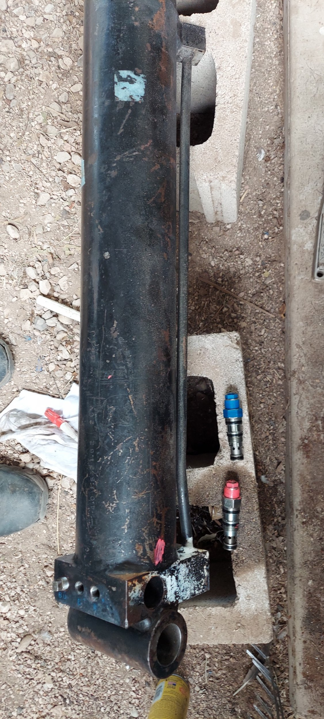

Yes when the machine is cradled the lower cylinder is extended, meaning gravity is trying to extend it. here’s what I found (oldnslo I can tell you must have worked in a hydraulic shop or owned one most of your life) because you were exactly right, they r as follows
Sun pilot valve “blue” side
2500 psi
CBCA LAN
9EJ5
Sun pilot valve “red” side
2500 PSI
CBCA LAN
9DG5
   / I’ve got a 45’ Eagle towable manlift and bottom boom is leaking down. #29
Puppy
The good news is that Sun is still building those valves today. If all the external seals look good I would blow air through from port 2 to port 1. This would flush the check valve which is the load holding portion. Like I stated earlier that little poppet in the nose should move a short distance easily. If it does not that would indicate something is causing it to bind and valve might have to be replaced since tearing them down further usually requires replacing inner O-rings that are a thin metric size.
If load is trying to extend the cylinder the cylinder piston seals could be leaking allowing this drifting. I was incorrectly presuming the cylinder was retracting to lower.

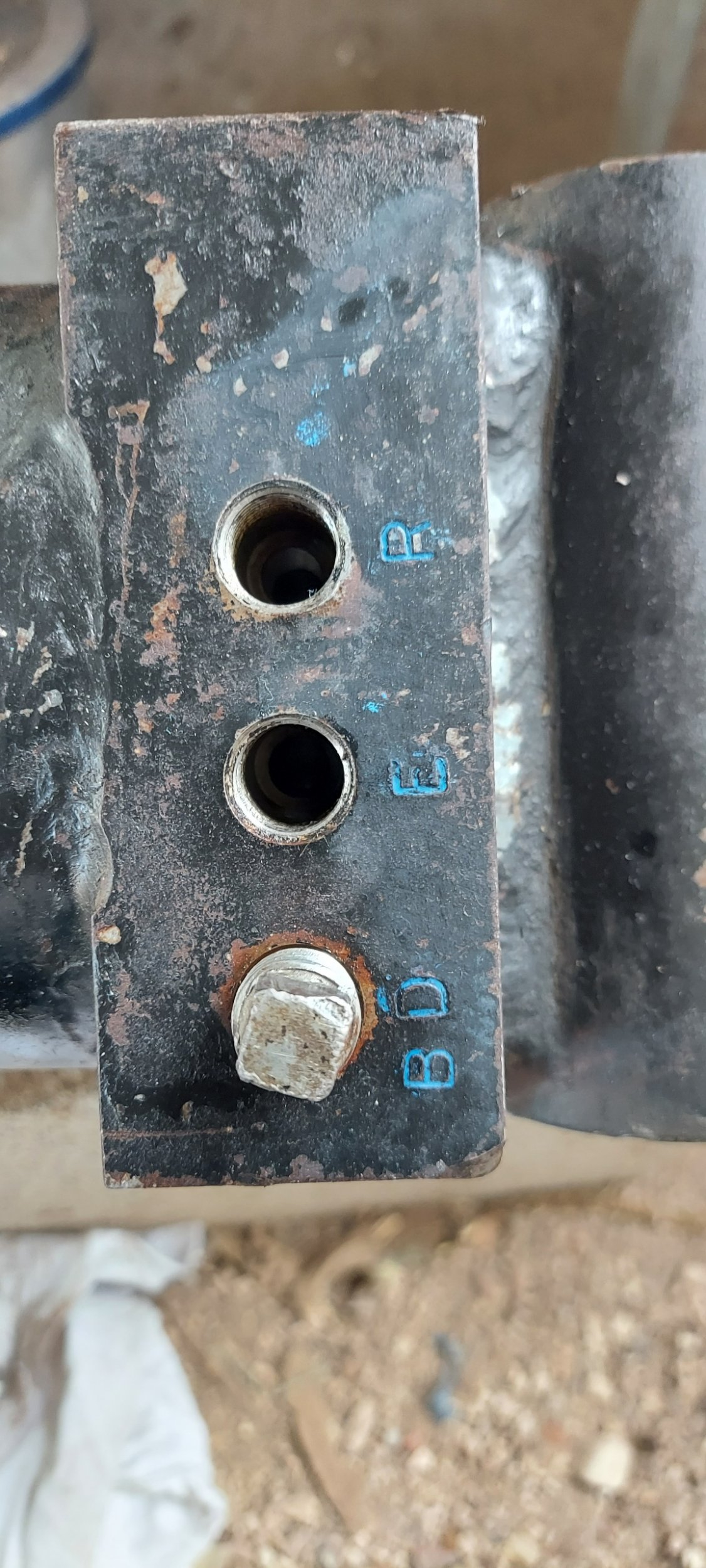

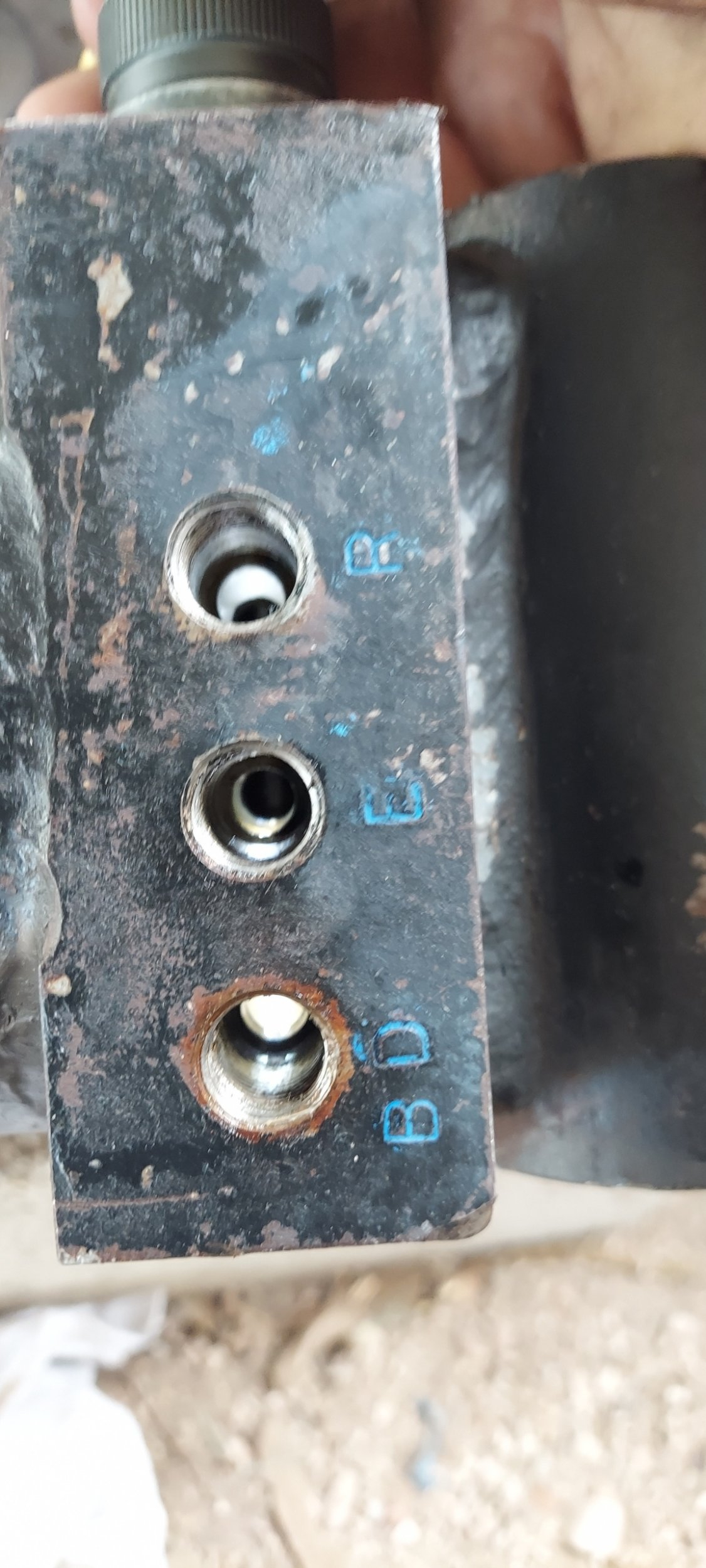

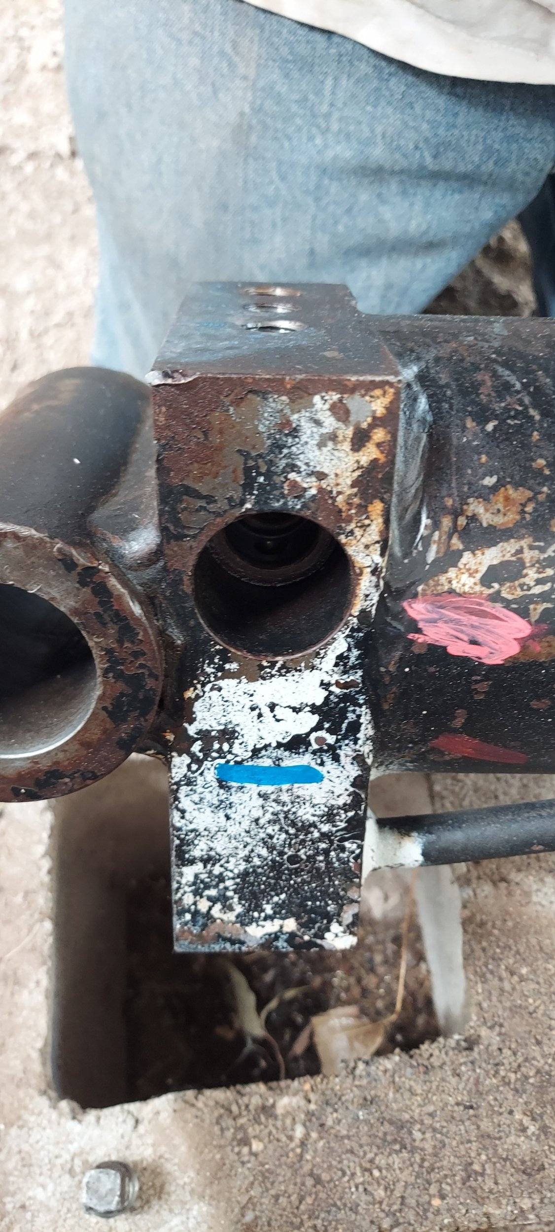

Ok so if you would tell me again how this works based off these pictures. on the third photo, that’s showing where the red valve goes in, the blue mark is showing we’re the blue valve lines up. I’m guessing the “R” means retract and the “E” means extend? What does the other one mean? “Bleed?” If you notice on the first photo I’m shining a flashlight into the red valve and u can see light through all three of the ports, shining a light through the blue valve only “R” and “E” shine through. And how does the piping on the side work with all this? I’ll have to go put it back on the lift to tell you whether it is extended for sure, obviously how it’s sitting now is with the boom cradled, but I got to thinking maybe it could be retracted in that position. Thanks again for all your help.
