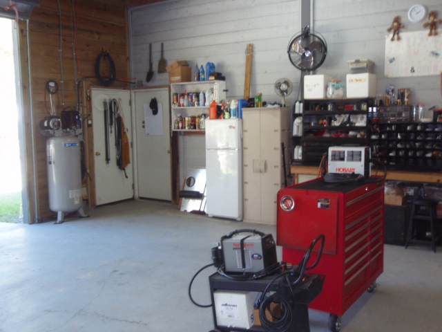

Well an update to this thread. Merry Christmas! ...and I am the proud new owner of a Hypertherm 45XP. I last posted in January of this year and was weighing 30xp vs. 45. Still had Miller 625xtreme on the list because of the dual voltage. In November, I visited Fabtech with tickets courtesy of yomax! Thank you. I had the pleasure of meeting Jim Colt of Hypertherm and also tried out the brand new 45XP. Decided then that this is the one. Really appreciated the time that Jim and Vince Tucker spent with me at the show.
Well this afternoon, I got a chance to unbox my new toy. Shop temp is 38degF so I am reading the manuals next to the Christmas tree. Will fire it up and cut some scraps this week hopefully but dang it's cold. Snowing tonight and a chilling breeze. Bought the unit with CPC so I can migrate to the CNC table when I expand the shop.
