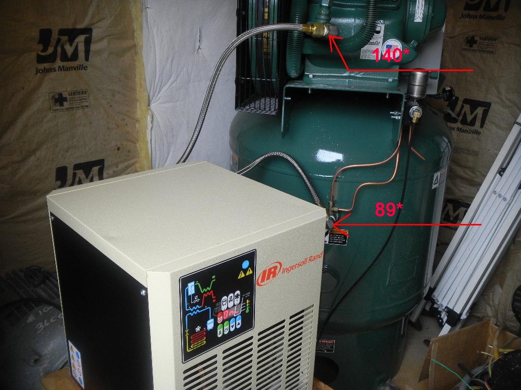

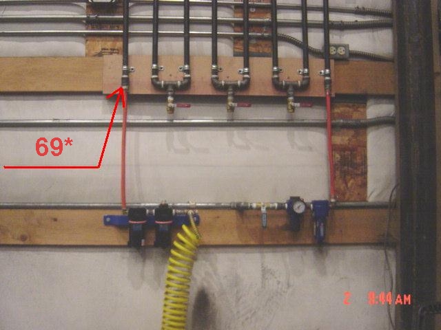

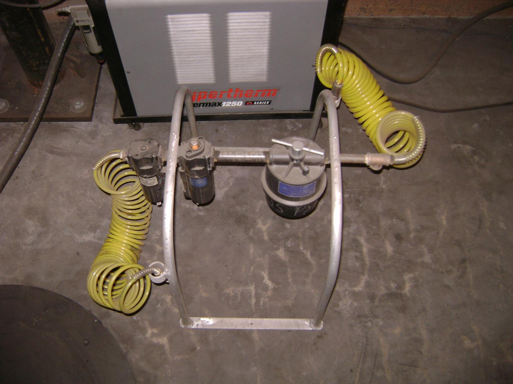

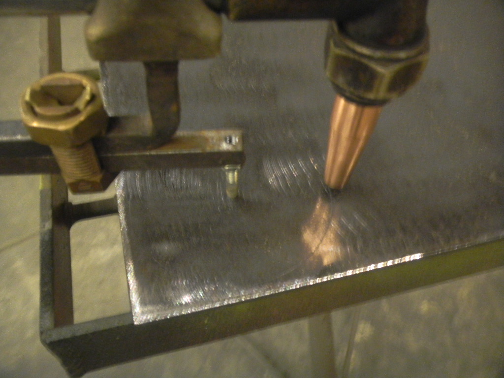

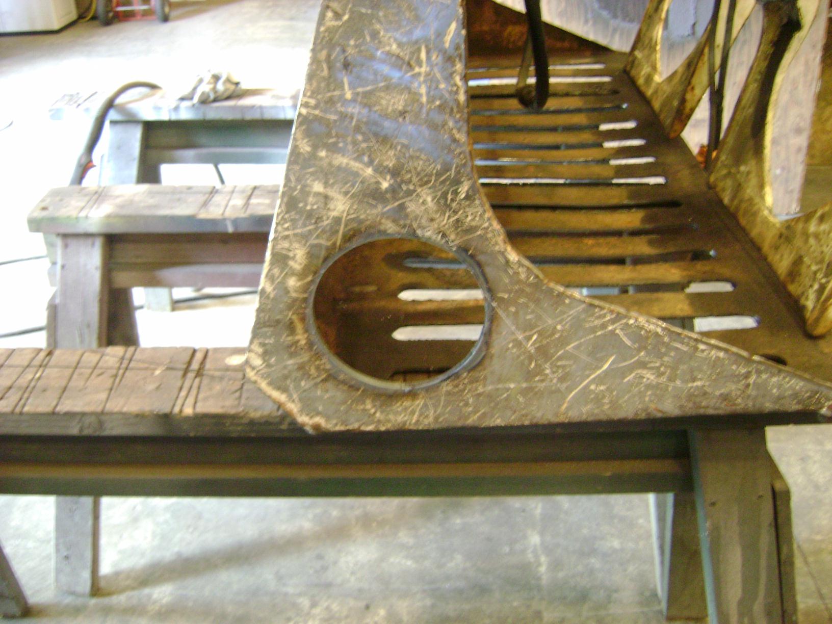

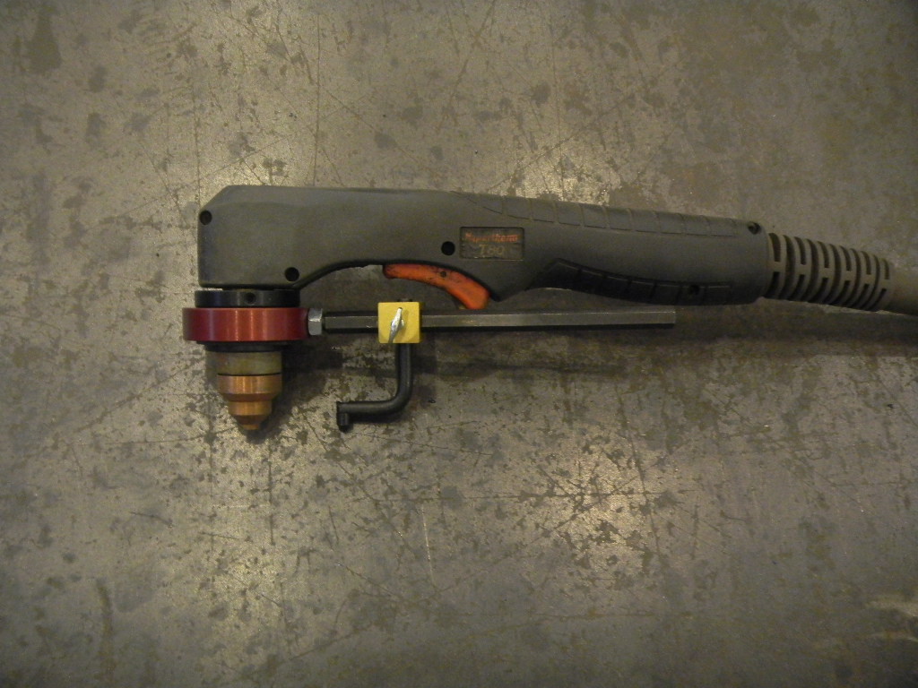

You'll need one of these then. You plan on cutting things like this?

Exactly... what is that attachment and just how does that work? Are you just tracing? I am not getting the gist of it yet.

The attachment is for burning circles with a plasma. Use a center punch in the middle of your circle. Start your cut.
Yeah I understood the circles. I am assuming the artwork was all freehand? Very nice.
