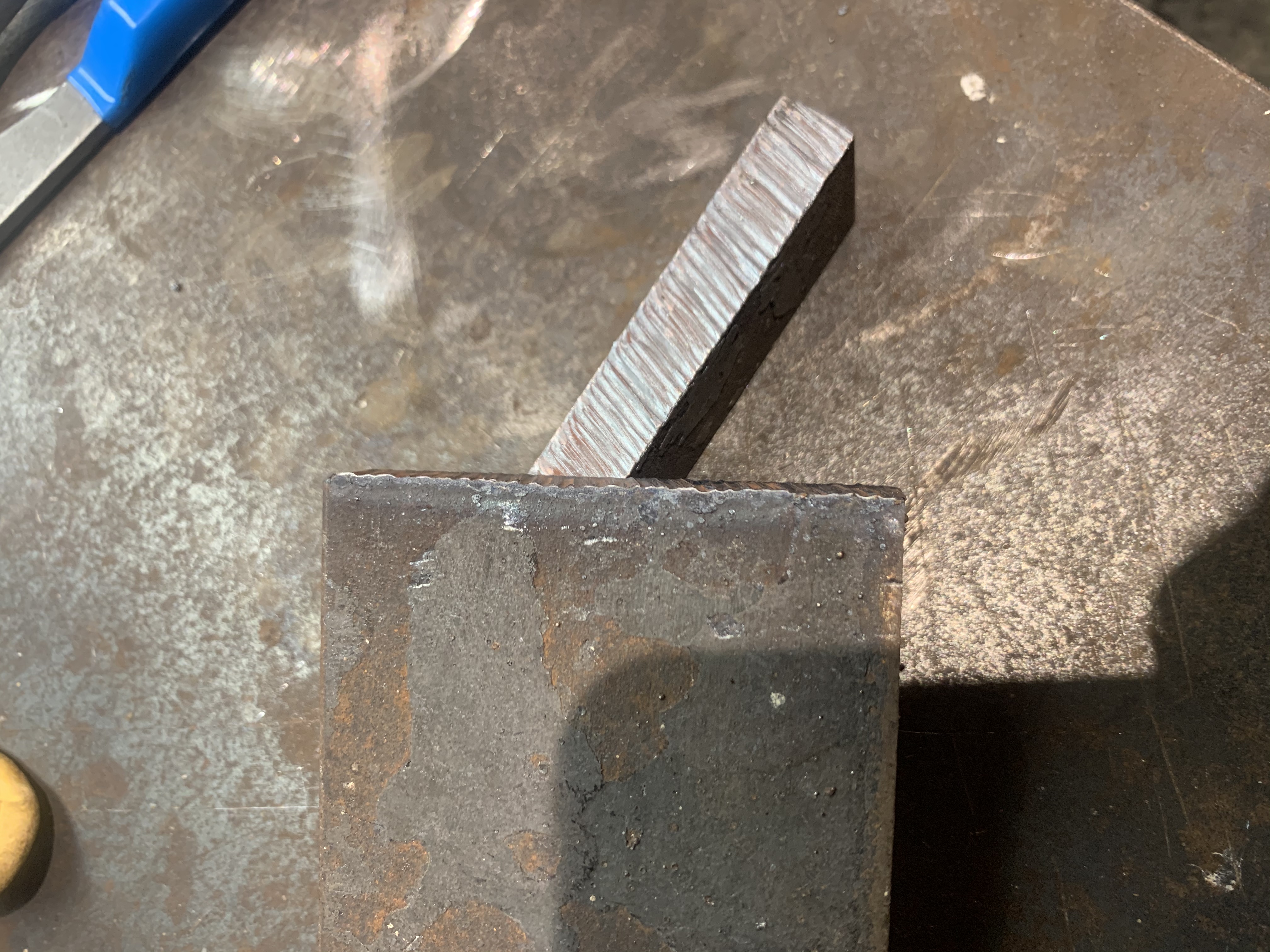

So I messed around just a little with it. Here’s a 1/2” ar500 bar I cut through. I am going to have to practice cause this thing just burns right through stuff. I find myself pausing to try to see the plasma tail. 9601C8D6-5990-4923-8DEE-4431EE42B0C5.jpeg
   / Hypertherm 30 vs Hobart 40i for first plasma cutter. #16
So I messed around just a little with it. Here’s a 1/2” ar500 bar I cut through. I am going to have to practice cause this thing just burns right through stuff. I find myself pausing to try to see the plasma tail.View attachment 679377
Dang fun... isn't it? I do the same trying to gauge my speed by looking at the tail and not focusing on a constant speed drag. I might look into investing in a tool to better roll along with so the tip doesn't get hung up and jerky. It has be a dream cutting with my 45xp.
