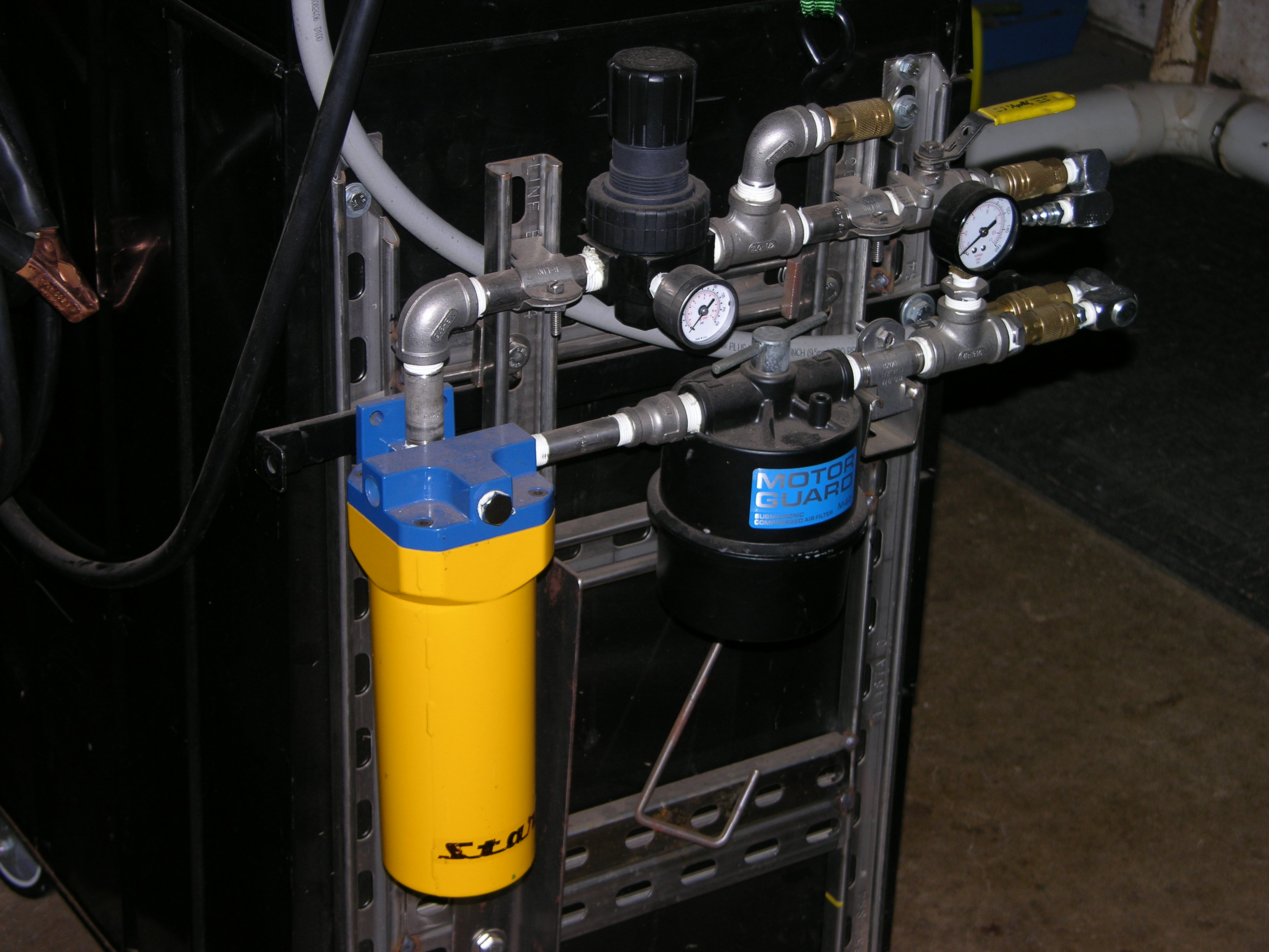

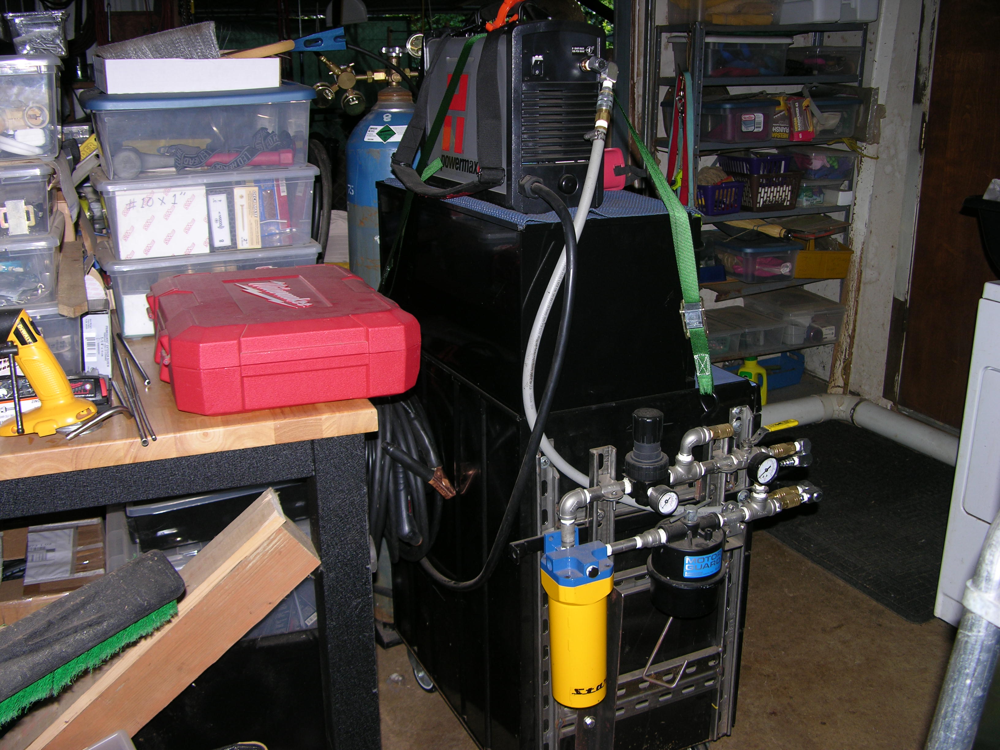

Back to plasma; my PM45 needs to be "sorta" portable, so it sits on a rollaway tool cabinet (which doubles as consumable storage for MIG, TIG and Plasma) - my compressor is the SMALLEST industrial one the local compressor store sells (5 horse Baldor, 80 gallon, inter-cooled, pressure lubed all cast iron, 21 CFM @ 175 psi) - so for "portability" I put together a "helper" separator
full pressure air enters top right in the pics; goes thru a "pre-regulator" down to 125 psi, then thru a "painter's filter" with a water drain, then a Motorgard filter and up to the plasma.
I get several hundred feet of cut on a set of consumables, for me that's more than acceptable.

Can’t go wrong with hypertherm. Performance and consumable life can’t be beat with outstanding manufacturer support. Use coalescing air/water filters that Hypertherm recommends. My xp45 has a self draining one inside. Use much bigger one outside before the cutter.
