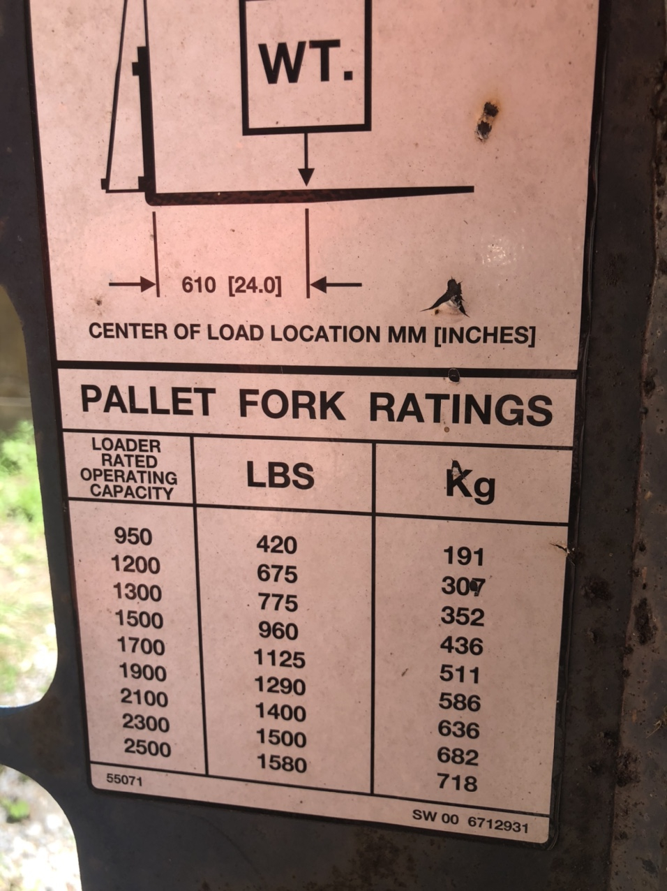

Copy of Family Handyman arrived today, it has an article which touches on a BX2380. Author says he was having trouble filling the bucket on the FEL, and needed a bit more horsepower. He said when he pressed down hard on the "forward" pedal, it "essentially shifted into a higher gear range" which wasn't what he wanted and bogged the engine down. His solution was to shift to 4WD low and try again, which he said solved the problem (I guess more mechanical advantage from a lower range). He wasn't clear if he was having problems filling the bucket by shoving it into the dirt pile, or filling the bucket by push/curl/lift (which I think is the proper procedure since using the FEL as though it was a bulldozer will bend it).
So . . . I have a B2601 with pallet forks. I have sometimes run into problems lifting "stuff" which I know weighs less than the FEL rating. The engine doesn't bog, but the FEL won't lift. I was unloading freight on pallets out of a tractor-trailer, and the FEL wouldn't lift, but it would curl, and that gave me enough clearance to get the pallet out of the trailer, back away, and lower the pallet to the ground.
My question is this - would I have had more lift capacity if I were in low range (I was in medium, 2WD) or did I just happen to find the lift limit of my FEL? Would the gear range affect the output of the hydraulic pump with drives the FEL? I also think the lift capacity of the FEL varies with the height, and the truck bed is 4' off the ground, maybe a little more.
His explanation might also be apples and oranges - if he was playing bulldozer, that shouldn't affect the hydraulics, and he simply asked more of the BX than it could deliver in high range.

It’s operator error. The HST pedal works differently from a car accelerator. You want more throttle and less pedal when the going gets tough. The tractor should have already been in low range which it sounds like it wasn’t.
/ Hydrostatic quirk or total nonsense? #5
Mike: The Handyman Author gave a misleading article. First, it does not shift into any range. Only the operator shifts to a different range. Certainly he got more forward motion force when HE shifted to low range (which happened to be how he was filling his bucket.) Then you add more mud to the water saying "he might bend the FEL." That is not going to happen. The BX does not begin to have enough traction or power to bend the FEL. The FEL will win that battle all the time.
Then your question: Would you have more lift capacity [with the FEL] if you were in low range ? Answer is NO. In both his tale and yours the range the HST is in does not materially affect the lift capacity of the FEL. That's the simple answer.
Now to clarify a bit: the FEL (or anything else driven via the hydraulic pump) will have more lift capacity at higher rpm. So if either of you lug down the engine rpm by whatever means (such as by lugging it down being in a high range while trying to move forward) then, YES, you would have 'reduced the lift' but that is a misleading rationalization (rationalization is substituting A reason for THE reason.)
Look at it this way, if you stop the tractor, run the engine at rated full rpm, and keep adding weight until the FEL won't lift it anymore that weight will be the same regardless of what range your transmission is in. Including neutral which it is in anyway with your foot off the pedals.
/ Hydrostatic quirk or total nonsense? #6
To answer your question the gear you are in has zero effect on what your loader will lift. With forks the center of the load is potentially farther forward which will reduce the theoretical lift capacity.
And pushing harder on the HST pedals tries to make the tractor go faster Vs giving the tractor more power. This is a misconception that some people have.
/ Hydrostatic quirk or total nonsense? #7
Chart shows where the position the weight is on forks effects lift.
The curl has breakout force. Caution as this can add to your total lift force.

/ Hydrostatic quirk or total nonsense? #14
NOTE TO OP
Your SCUT is NOT a skidsteer. Your SCUT is NOT a forklift.
Rated lift capacity for your machine is at the pins without bucket or forks. Your lift capacity changes based on the height of your lift. Your max lift is near the ground, is lower at 4 feet, is lowest at max height.
Put on forks, deduct the fork weight from your lift capacity. Same for the bucket. The further your load is from the pins, the less you can lift.
Digging from the ground or a pile is hard work. Digging from the bottom of the pile is even harder work for any machine. Your machine wasn't designed for this work.
Bottom line is if your machine can't lift or push something then you are using the wrong machine and/or you have wrong expectations.
