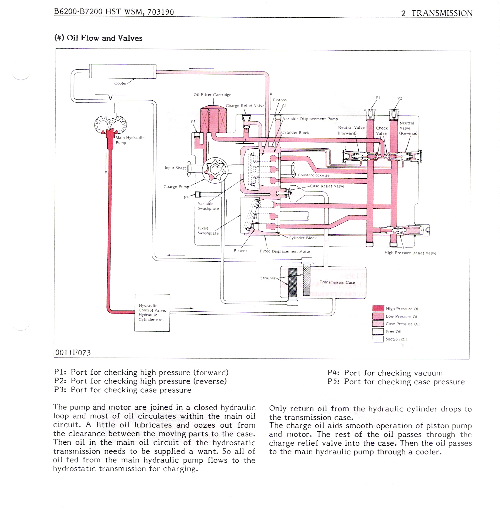

I'm new here and have been posting in the buying forum as I'm looking to get my first tractor. Anyhow, a friend who has a New Holland 25 hydro calls me tonight and tells me he talked to one of his friends who "knows tractors" and this friend does not recommend a compact with hydro if your going to use a FEL and/or a BH. Claiming it will be to hard on the transmission. His suggestion was a shuttle shift.
First, enlighten me to exactly how a hydrostat tranny works.
I am not sure what exactly what he means by it will be too hard on the trann. My guess is that your friends friend is under the impression that the FEL and BH hydraulics run off the HST. The 3pt, FEL, BH all run off a seperate pump not off the HST, which is a seperate system. The only thing they share is the hydraulic oil. HST's are pretty simply actually. You have a variable displacement pump that has a swashplate (the variable part) that is connected to your drive pedal. When you push the pedal forward or rev. all you are doing is moving the swash plate one way or another, which starts pumping oil fwd or rev. This oil then goes to a fixed displacement "pump" or motor, which turns fwd or rev. So a HST is really only two hydraulic pumps connected together; a variable hydraulic pump hooked to a hydraulic motor. I have attached a picture that may or may not help. It is of my B7200, but I think it gives a good idea.
