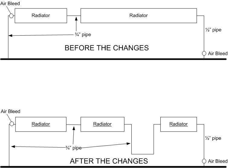

Throw out some ideas - nothing is too simple; talk to me like I am 5 years old.
It is a one pipe main system.
Two zones
I believe the pressure differential is 6lbs.
Everything worked until I messed with it.
The problem -
Water is not flowing through one section of radiators.
At each end of the feed, the main pipe is hot.
The changes - along one wall, I had one long radiator. I added a door in the middle of the wall.
To accommodate the door, I cut a section out of the radiator.
I dropped a section of pipe down underneath the doorway , through the crawlspace, and back up to the other side of the door.
I attached a drawing - note the pipe sizes.
Also note that now the water will not flow at all, from the beginning of the pic to the end, even through the unmodded radiator
So why wont water flow now?

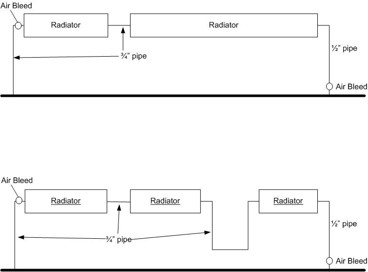

Sooo.... the top pic is the system down one wall - bottom picture is down the other wall. My guess is an air block somewhere in the system. Is there a valve somewhere that was accidentally closed. What about the circulating pump - is it still OK.
/ Hydronic heat, I broke it.
I changed the pic - the pic shows the radiators before and after my changes.
The circulating pump still supplies the rest of the house fine.
/ Hydronic heat, I broke it. #4
Is the air bleed valve on each side at the high point and have you bled them sufficiently? It looks like you've created a "P-trap" and this is most likely your problem preventing flow. One of our TBN resident plumbing guru's will be along shortly to give us the "skinny".:)

If you're showing one leg vs all of the system, we have net flow through a 1/2" pipe that has just had four 90s added to it.
If this is a 'branch', then the extra turns are adding that much to flow restriction to it. If this were a hydraulic circuit, a flow divider would be indicated.
An extra circulating pump can be added to a branch, but while it might improve flow in the portion shown it might then deprive other areas.
What are/were we using for zone control already? IMO, 6 psi PD should push air out unless flow rate is too slow.
Inquiring minds might want to see a flow chart of the whole installation for perspective.

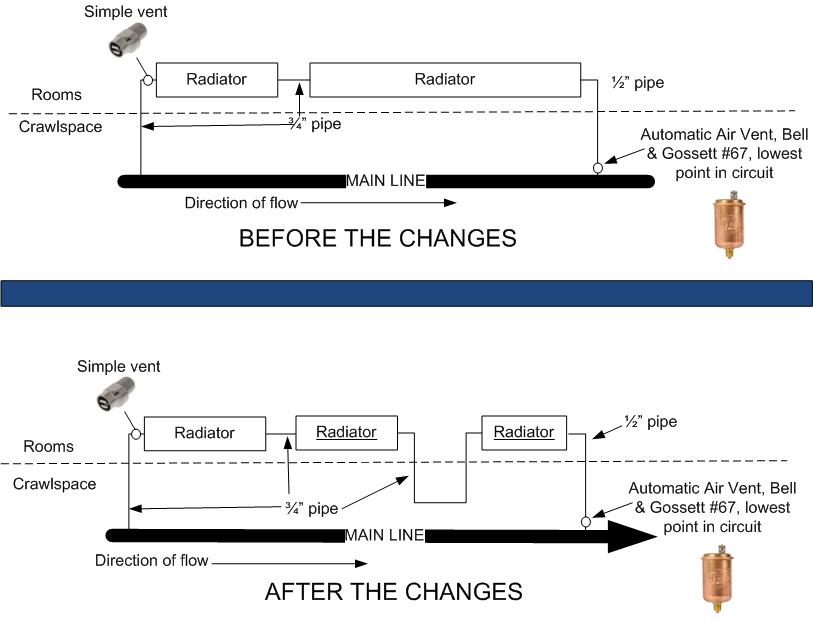

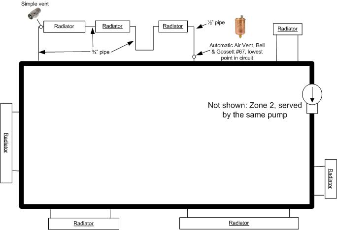

Two more drawings -
/ Hydronic heat, I broke it. #14
WF - is that bottom drawing correct? You have a main loop( heavy black line) with a circulating pump in the loop. Each of the radiators is a separate loop off that main loop? How does water flow out and thru each of the individual radiator loops?

Just wondering after you cut, drained, installed the new radiator & piping; how did you initially refill & bleed that loop?
I'm assuming your one pipe system uses Diverter Tee's (MonoFlow Tee's) in it at each radiator loop off the Main System loop. This system is much tougher to bleed when air is trapped in one of the radiator loops. Using just the bleeder vavle in the radiator loop my never work or take an extremely long time to bleed. Water will take the least pass of resistance & with an air lock in that loop most of the water will flow past the Diverter Tee & travel straight through the Main System Loop.
This may help:
(1) If you have the ability to shutdown each radiator loop off the main loop I would shut them all off first (your system may not have this)
(2) Then shutdown the Main Loop Return
(3) Then Open the Bleed Valve on the radiator loop you just modified
(4) Slowly (SLOWLY) add water to pressurize the loop forcing the air through it.. You don't need the boiler running to do this...
Go slow... these system take awhile to bleed... after you think you have most of the air out of that radiator loop Close that loop also
With ALL of the radiator loop closed off the Main Loop - Bleed the main Loop again..
Then fire the boiler & have the system call for heat... I would then carefully open & bleed each of the radiator loop again individually...

With mono-flow tees at each diversion, the newly installed drop will likely never self bleed or purge the trapped air.
If diverter tees are NOT fitted, it's worse '-)
There are no shut off valves shown in the system layout. That sucks. because if the flow could be forced through the modified loop, circulation could be restored. At least until "new air" gets caught in the natural trap.
A simple bleed at each elbow of the modification might be enough to get things moving through the loop.
I can't think of a reason to use caution or to go slow with your efforts. but don't expect immediate improved results without getting in and making changes.
