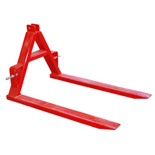

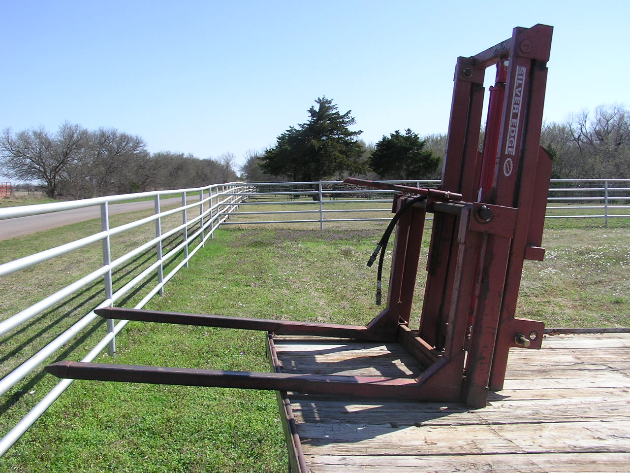

The second most useful would be pallet forks or a fork lift:

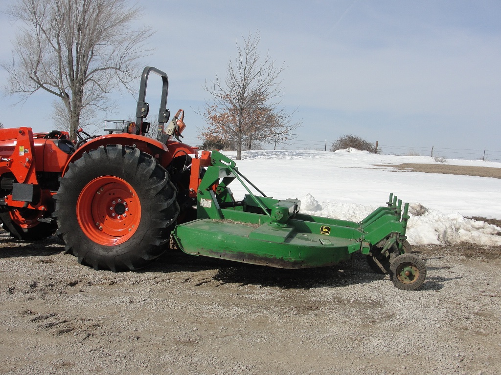

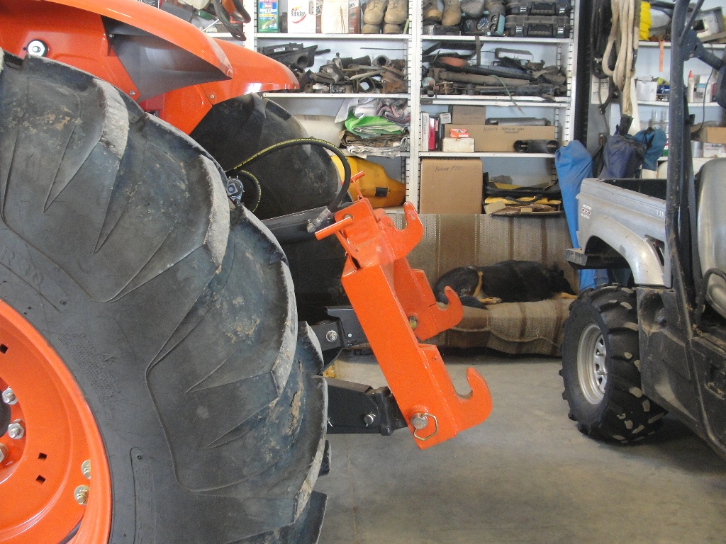

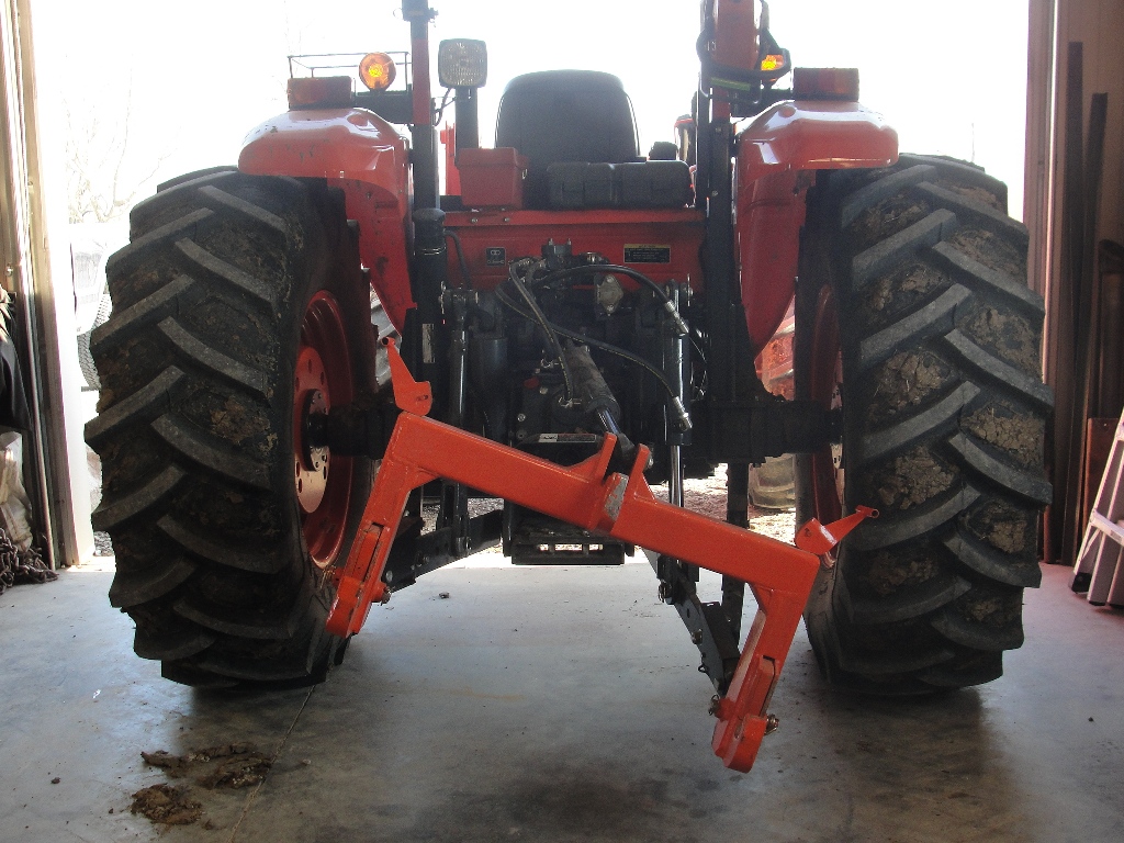

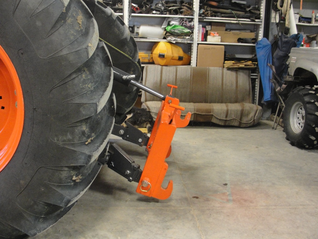

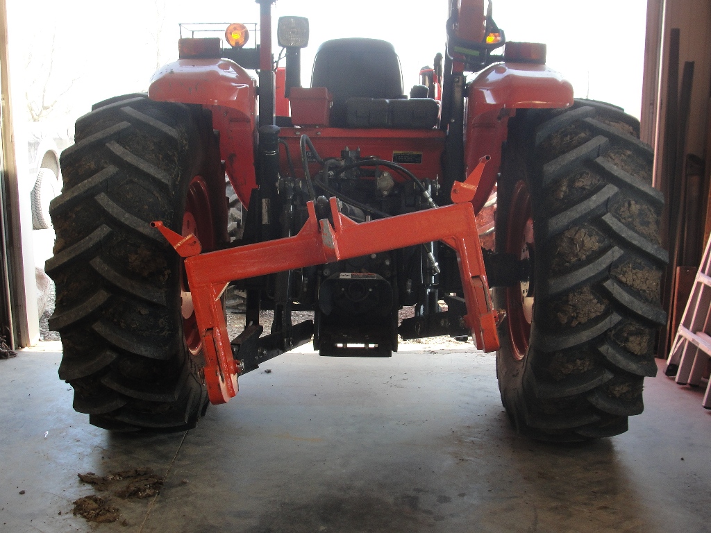

I use a Quick Hitch on my Kubota. I also have TnT that I built. Makes most 3pt attachments much more useable. Also dramatically improves hitching to an attachment. It allows you to do this without leaving the seat.
/ hydrolic top link #9
Hydraulic top link+ quick hitch = very easy and quick change of compatible implements with out pushing pulling fighting kicking pounding straining cussing or even getting out of the seat.
I can change from my box blade to my pulverizer to my rake in seconds just by backing up to them and pulling levers. Plus I can adjust them on the fly with another pull of the lever.

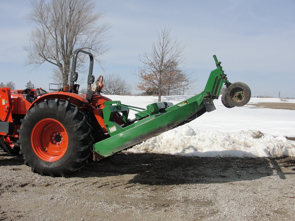

Another plus for me is with a mower on you can really get a lot of lift when loading on a high trailer or going through a ditch. or angled drop if backing up to mow a sloped bank.

The hyd top link makes the quick hitch work even better. Extend the link outward with the quick attach plate. Hook the top link (but not fully) to the implement. Lift and pull in the plate. The implement aligns itself. Then lift and engage the locks. Done!

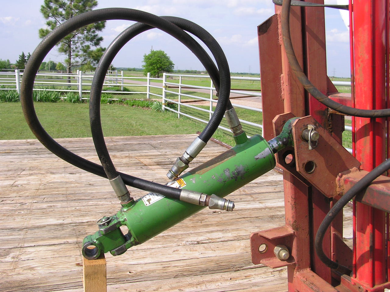

A hydraulic top link and a quick hitch are the best options I put on my tractor. I bought the quick hitch on sale ($200) and made my own top link. I had a hydraulic cylinder with a broken shaft. I got a new shaft made and cut the cylinder barrel shorter with my chop saw. The bolts holding the cylinder together were shortened and retreaded. Then I welded three point hitch top link ends onto the cylinder and I was in business. Total cost for the cylinder was about $100.
Cons, It ties up a remote.
So to get around this "problem" I had a hydraulic spliter laying around so I plumbed it into my rear outlets. One way runs the outlets and the other runs the top link. I had hoses made up at my local NAPA so I could hook it all up.
The whole project, top link and quick hitch was about $450. I didn't have to pay for a hydraulic cylinder and the spliter so I saved some money there. It was worth it though.
