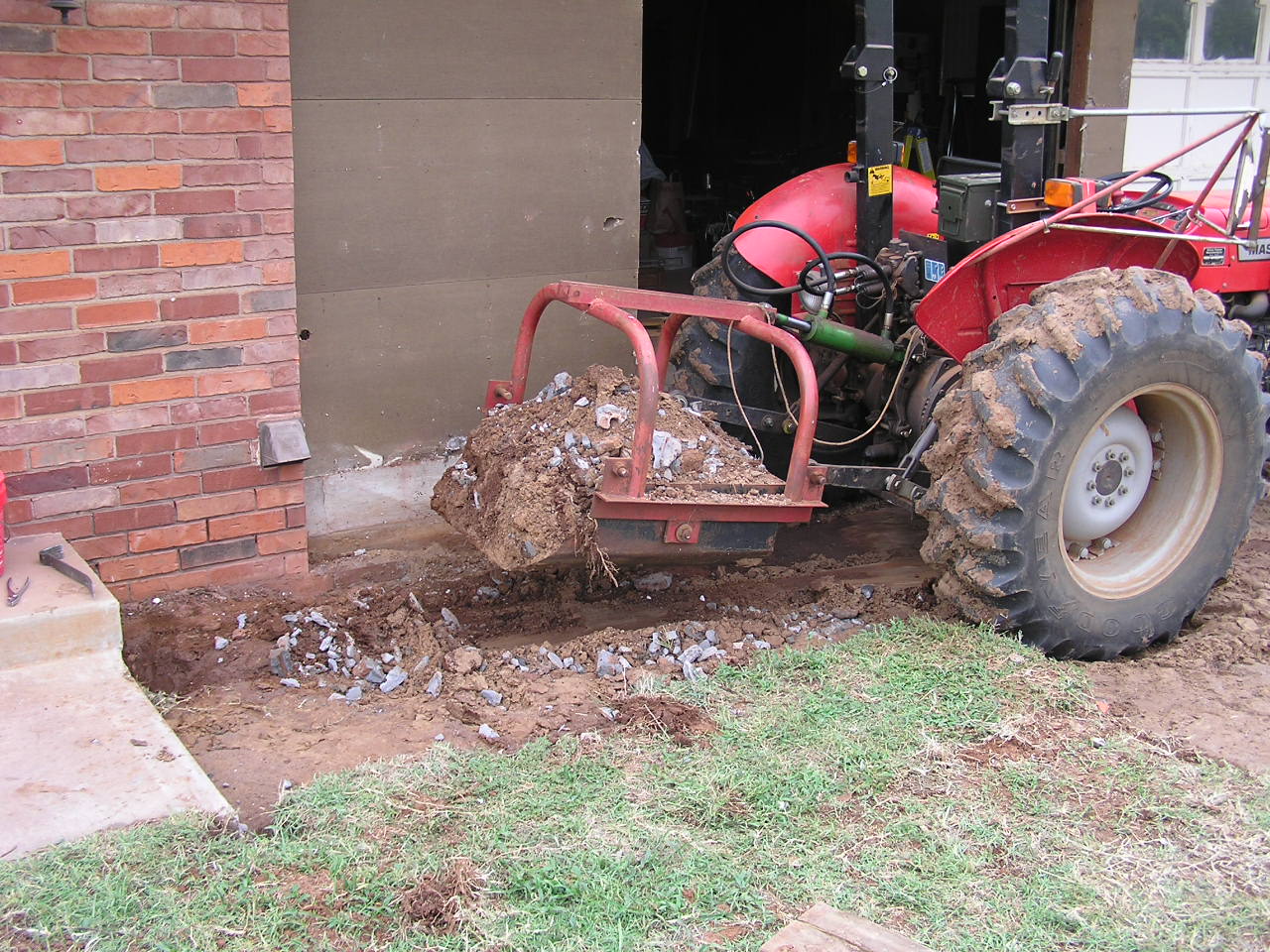

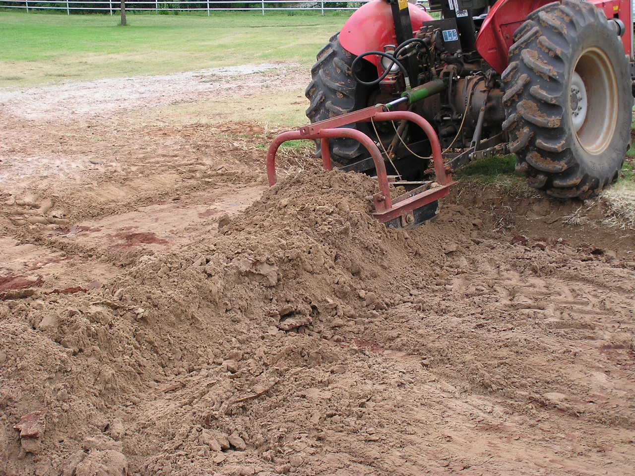

It makes a rear scoop work much better.
From July 2004, back when I had a tractor:

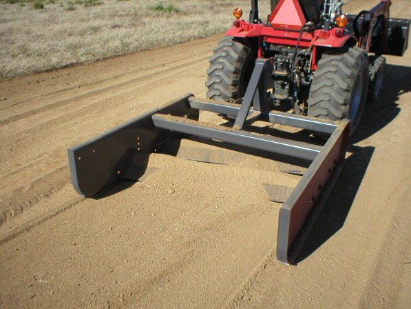

Richard, use varies immensely from person-person. (reads customer-customer) I use my side link more than the top link. When I first got my small tractor, only one rear remote. I did not put a top link on, but a side link. (see pic) The main reason I guess is that with a ROBB, you set the top link and you're done, not like the std box blade where the tilting forward and back is a constant thing and I got by fine without one using the LPGS. ;)
