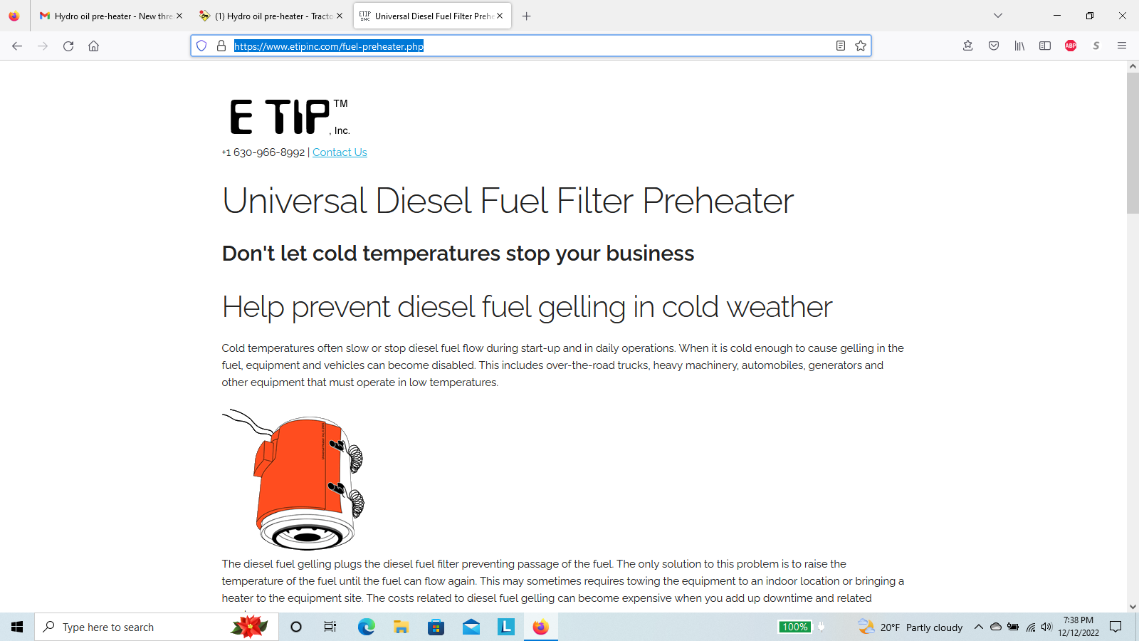

I'm getting ready to order a couple of this type heaters, thinking one for my fuel and considering one for my hydraulic filter.
Universal Diesel Fuel Filter Preheater [E TIP]
