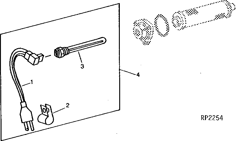

I'm considering adding a hydro oil heater to aid in very cold weather starting. Since my implement pump is direct coupled to the engine, the starter has to turn over the engine and the hydro pump on startup. Even with a block heater, the starter has trouble turning the engine over fast enough on very cold days. A couple of times I've had to warm the transaxle in order to get the tractor to start. I'm looking at a low wattage (150W) stainless steel heater rated for oil immersion.
Anyone here have one of these on their tractor? If so, how do you like it?

Here's a hyd oil heater offered by JD for a 955
AM880977 Assembly Line Parts ADD 9.72 USD
AR94493 Heater View/Update 79.49 USD
AR95434 Wire View/Update 21.87 USD
R34557 Clamp View/Update 1.37 USD
R44302 Tie Band View/Update 0.09 USD
Parts that have an issue will display a flag. *Subtotal 122.35 USD
*Total 122.35 USD
*Total 122.35 USD
Thanks... I was aware of those parts JD offers, but there is no way I would pay an extra $60 to $70 for a cardboard box with "John Deere" printed on it when I can order the exact same heater elsewhere.
