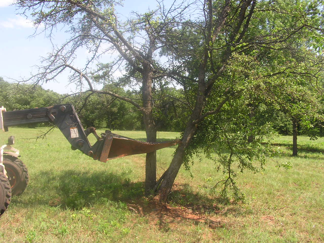

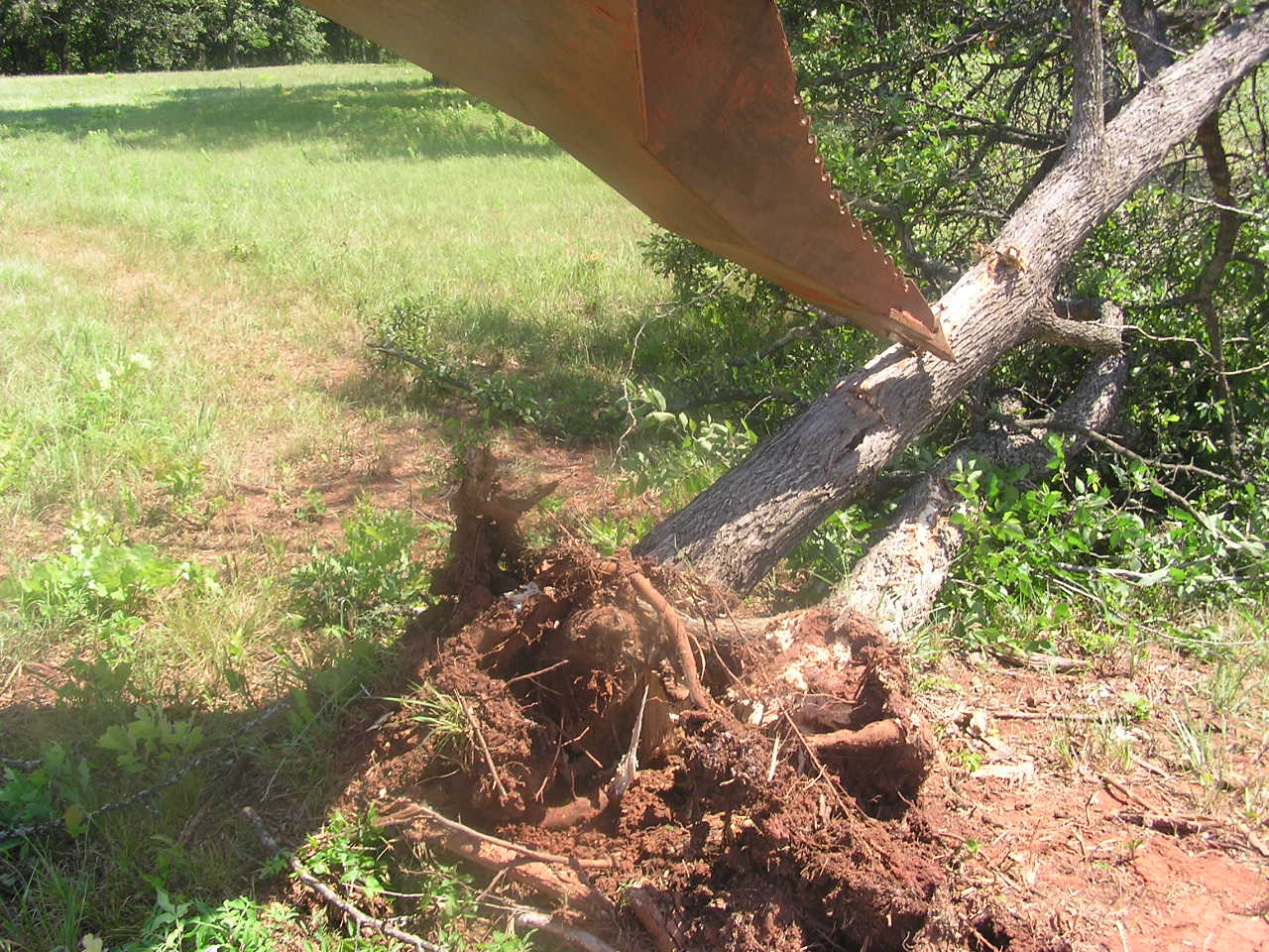

I use a stump bucket:
/ Hydro Ax for Pushing Trees #10

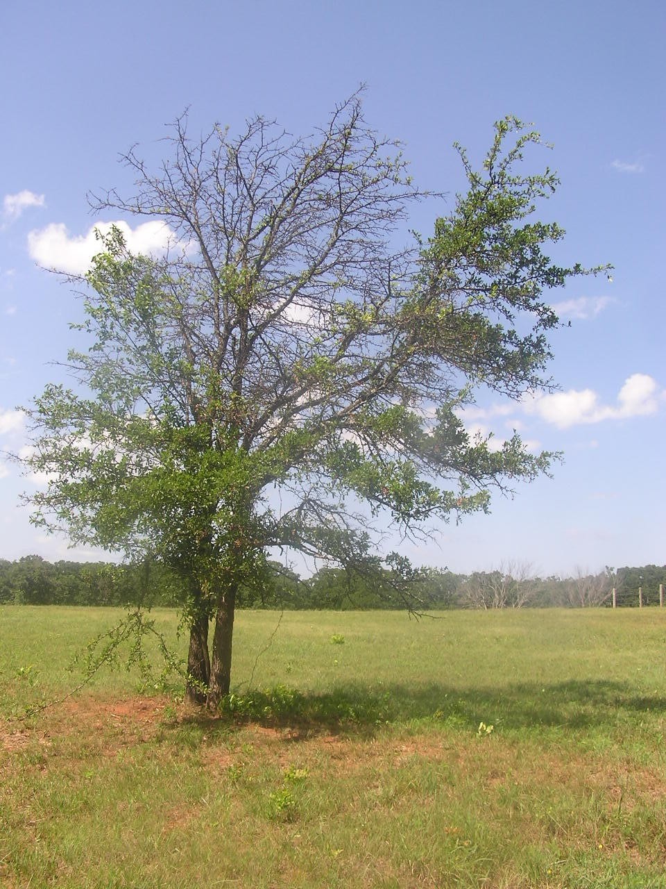

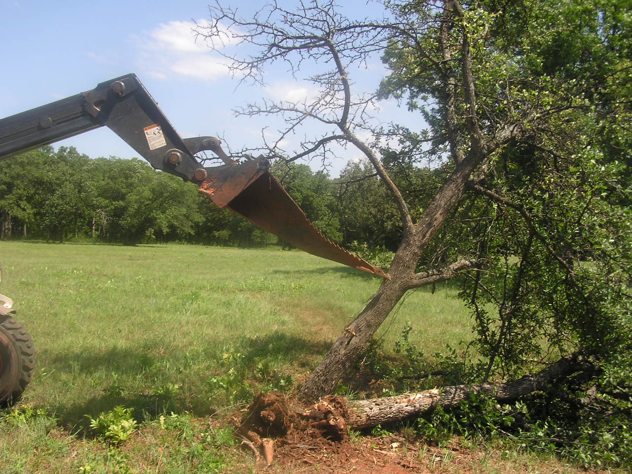

Dead trees are easier:
Balanced on the stump bucket:
