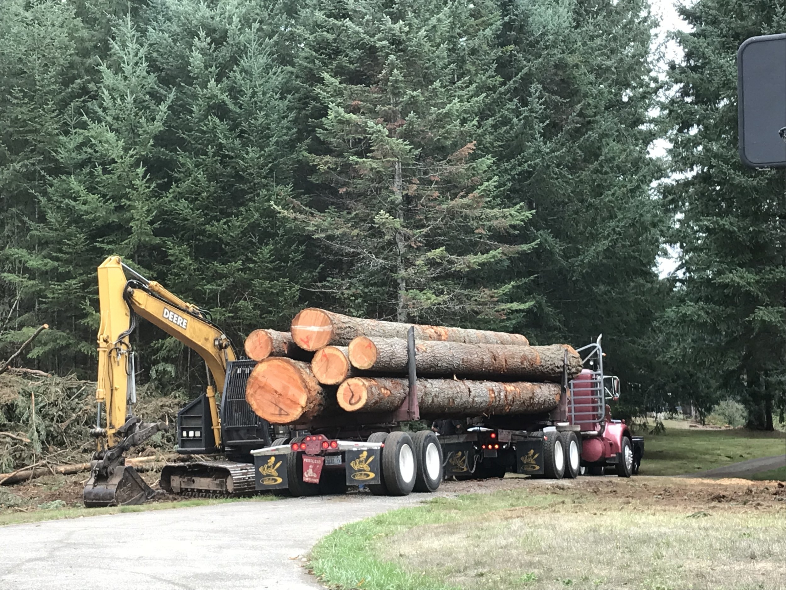

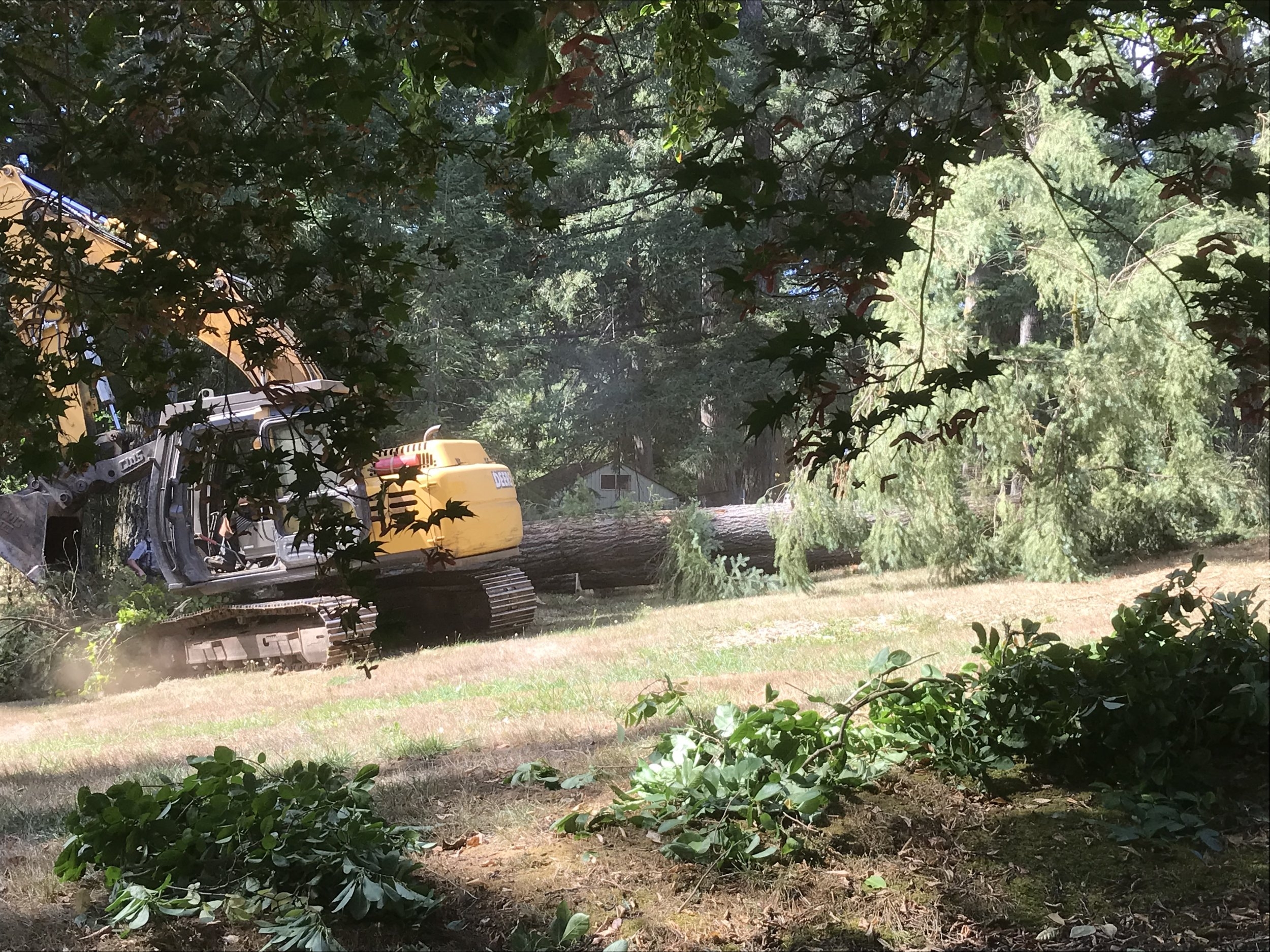

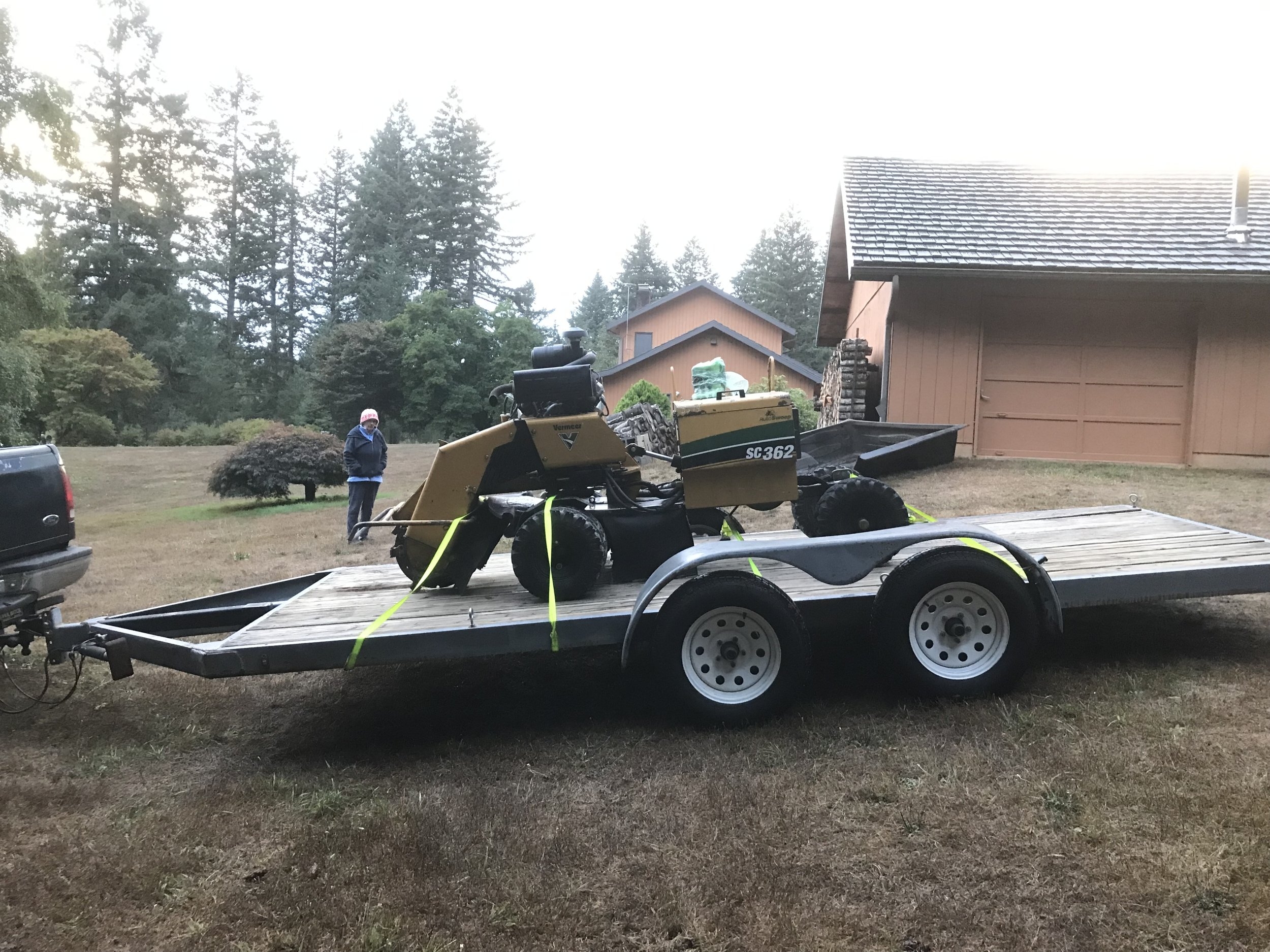

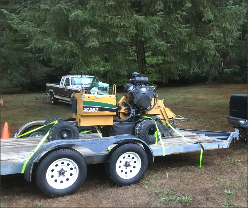

We are having bunch of "hazard trees" trees removed from our property by loggers and they will remove all the smaller stumps, which can be relatively easily removed by the JD excavator in these photos, but I will be left with many large Douglas Fir stumps to deal with, many of which are at least 44 inches diameter where the tree was cut down.
I also have many other stumps from previous tree removal to grind down.
In order to deal with these large stumps I decided to buy used Vermeer SC362 stump cutter, which I brought home last week and decided to start a thread here in order to describe how well this will work out.

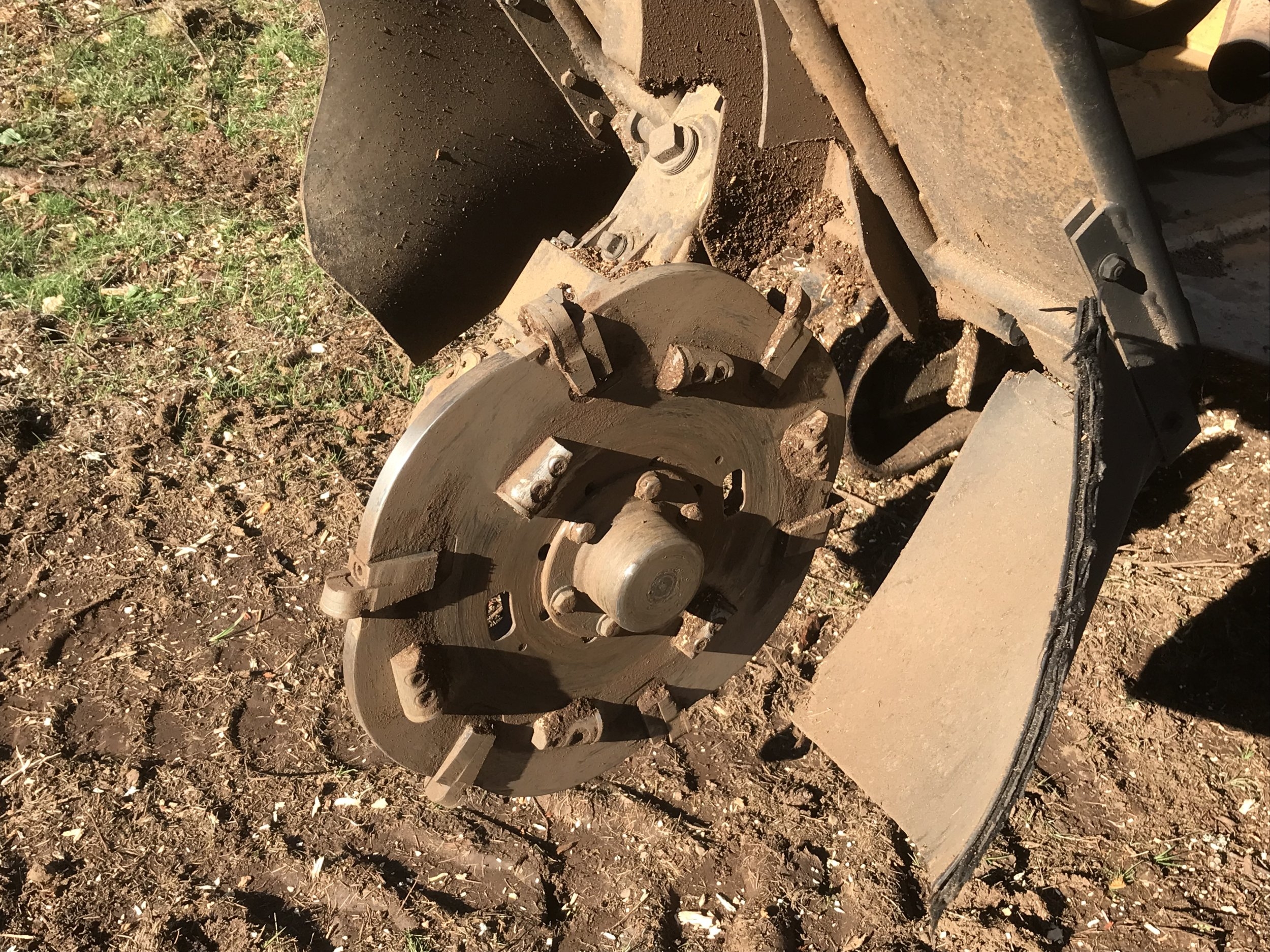

My first step was to order set of spare replacement belts & idlers and set of Greenteeth "Performance Upgrade" kit since their price looked reasonable and members here have given pretty good reviews. Also couple of OEM tooth pockets had been damaged from previous use.
Nothing against Vermeer Yellow Jacket setup, just decided to try switching from 16 cutting teeth to 6 and see how well that works out?
I also did some regular maintenance like engine oil change, belt tightening, lube etc.
I will keep you posted!

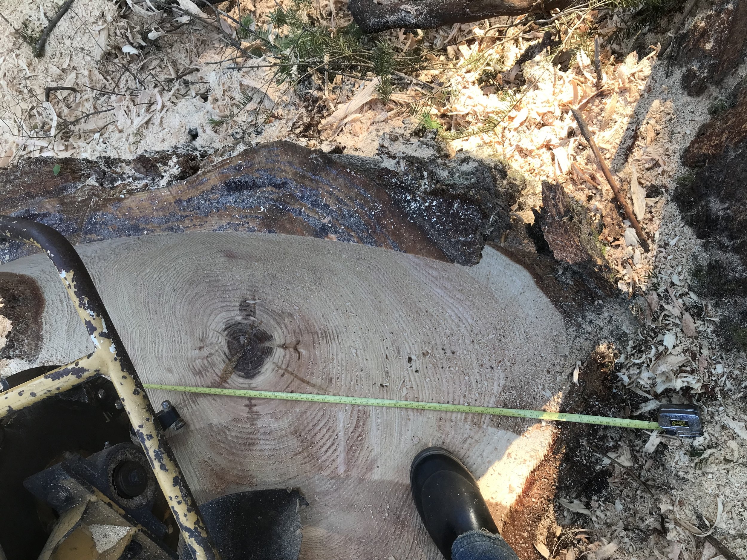

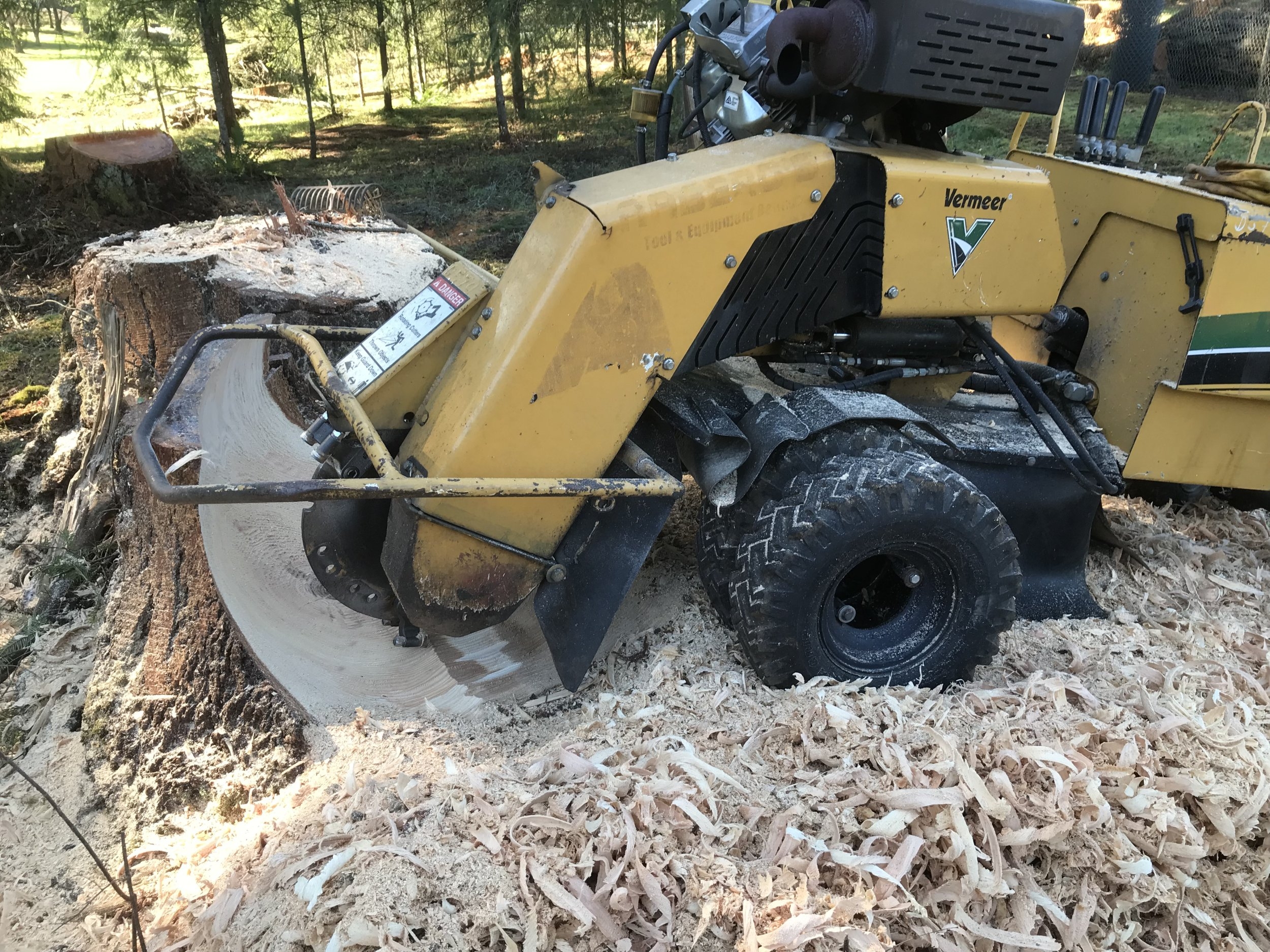

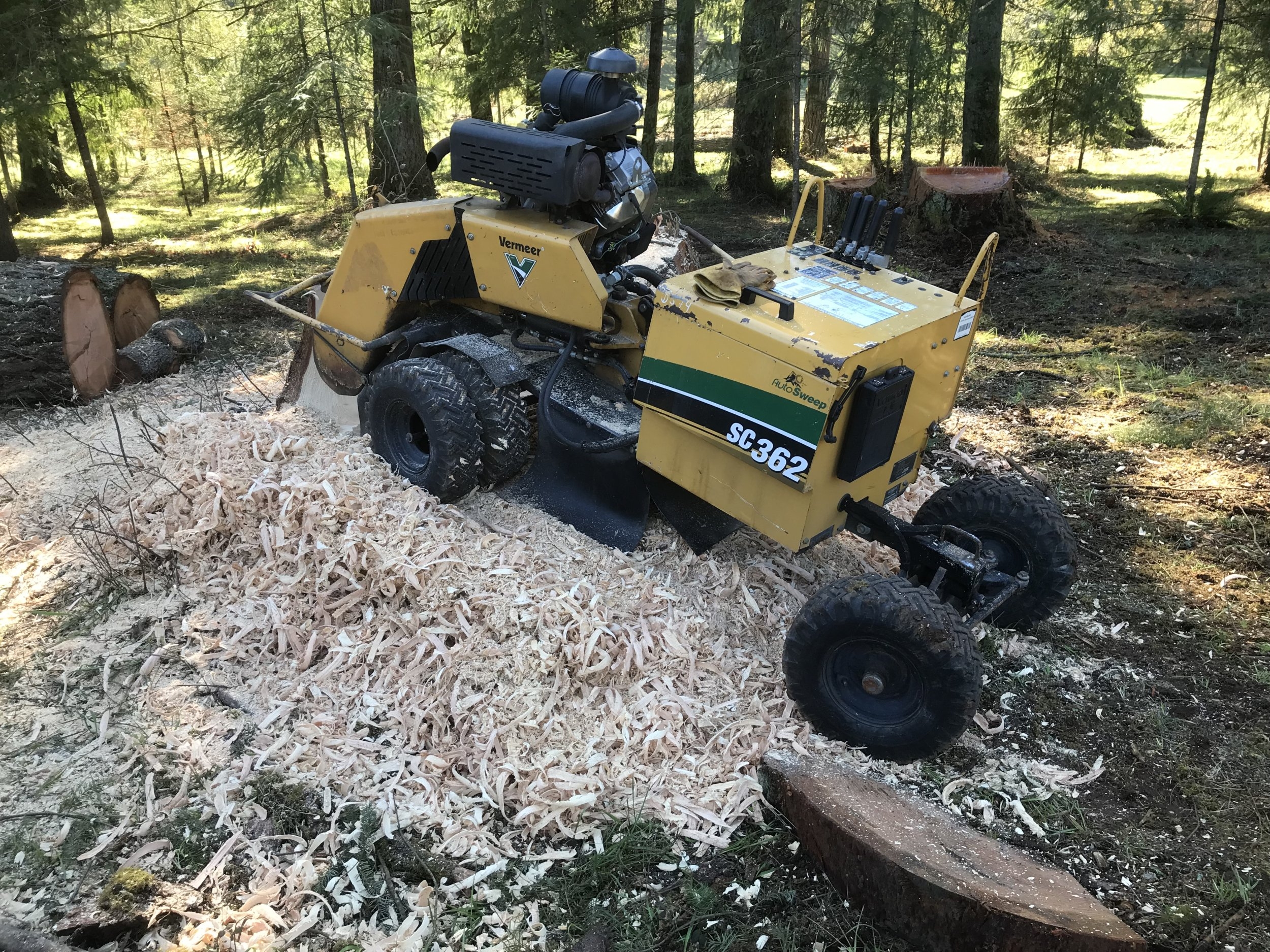

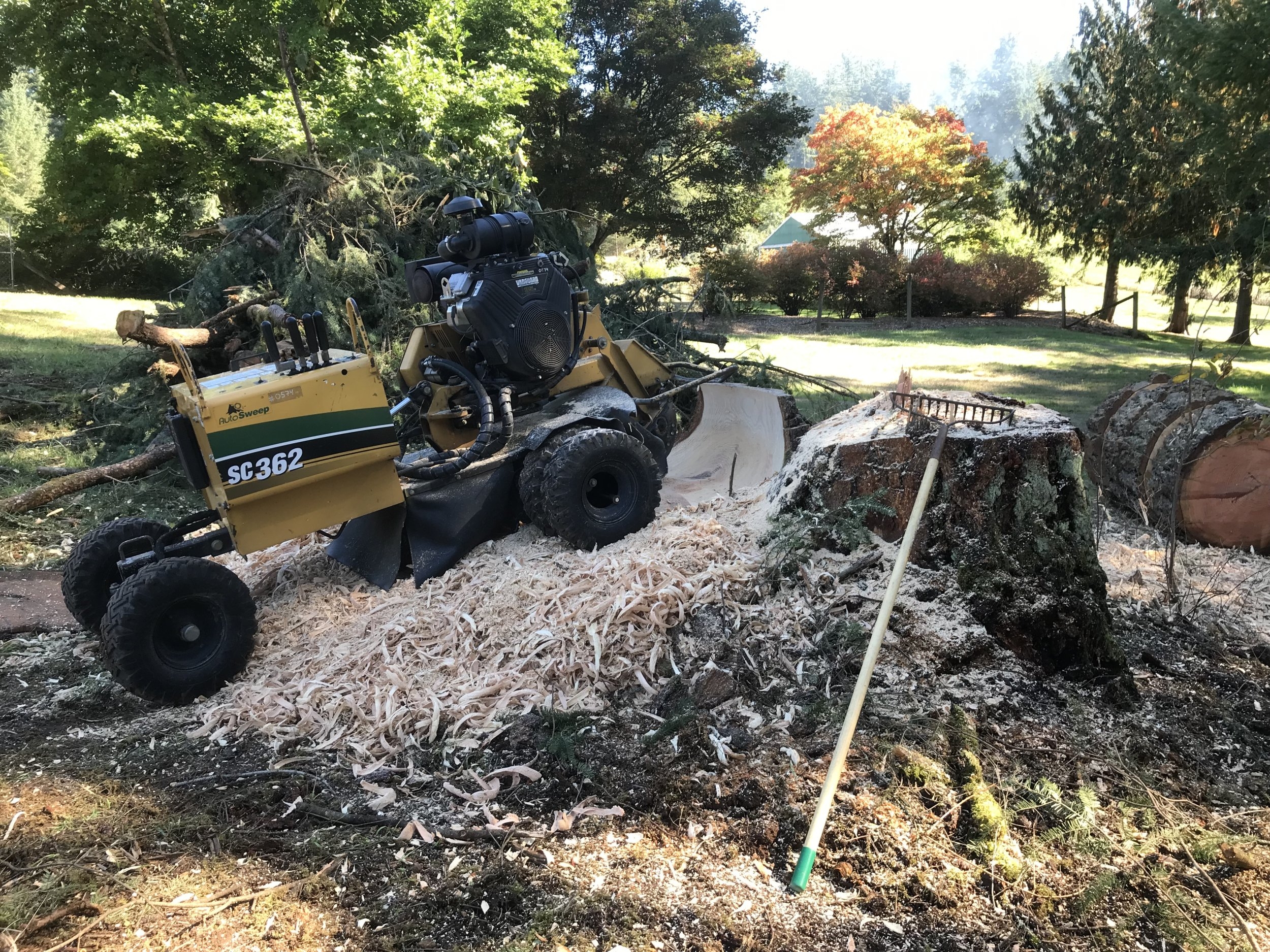

Update:
I did little stump cutting learning/experimenting in my back yard today with the new Greenteeth set in SC362 for the first time!
I have nothing much to compare with since the cutting set that came with the machine was worn out and would not be fair comparison at all, so let's just say that these work as I would have expected.
Lessons learned in cutting a 44 inch "extra tall" Douglas Fir stump:
  • It's far more efficient to cut the stumps shorter with a chainsaw - no surprise there, I just wanted to try it out in a tall stump on purpose and also did not want to bring out my big chainsaw yet today.
  • Lot of wood chips were generated and it slows down the work since they had to be cleared out several times (I used a rake - not the best choice, but better than shovel!).
  • Unlike with the dull teeth - no visible steam was generated due to new sharp teeth.
  • Next time I will have a tractor handy nearby in order to clear out the wood chips faster.
  • SC362 does the job fine, but it takes some time - no surprise there.
  • Anyone cutting 44 inch stumps for living should get the biggest Diesel powered stump cutter they can afford - no surprise there either!

Thank you, all good points!
Later today I will try a large backpack blower for removing the wood chips out of the way when cutting the next large stump.
Manually raking them out is not efficient use of time.

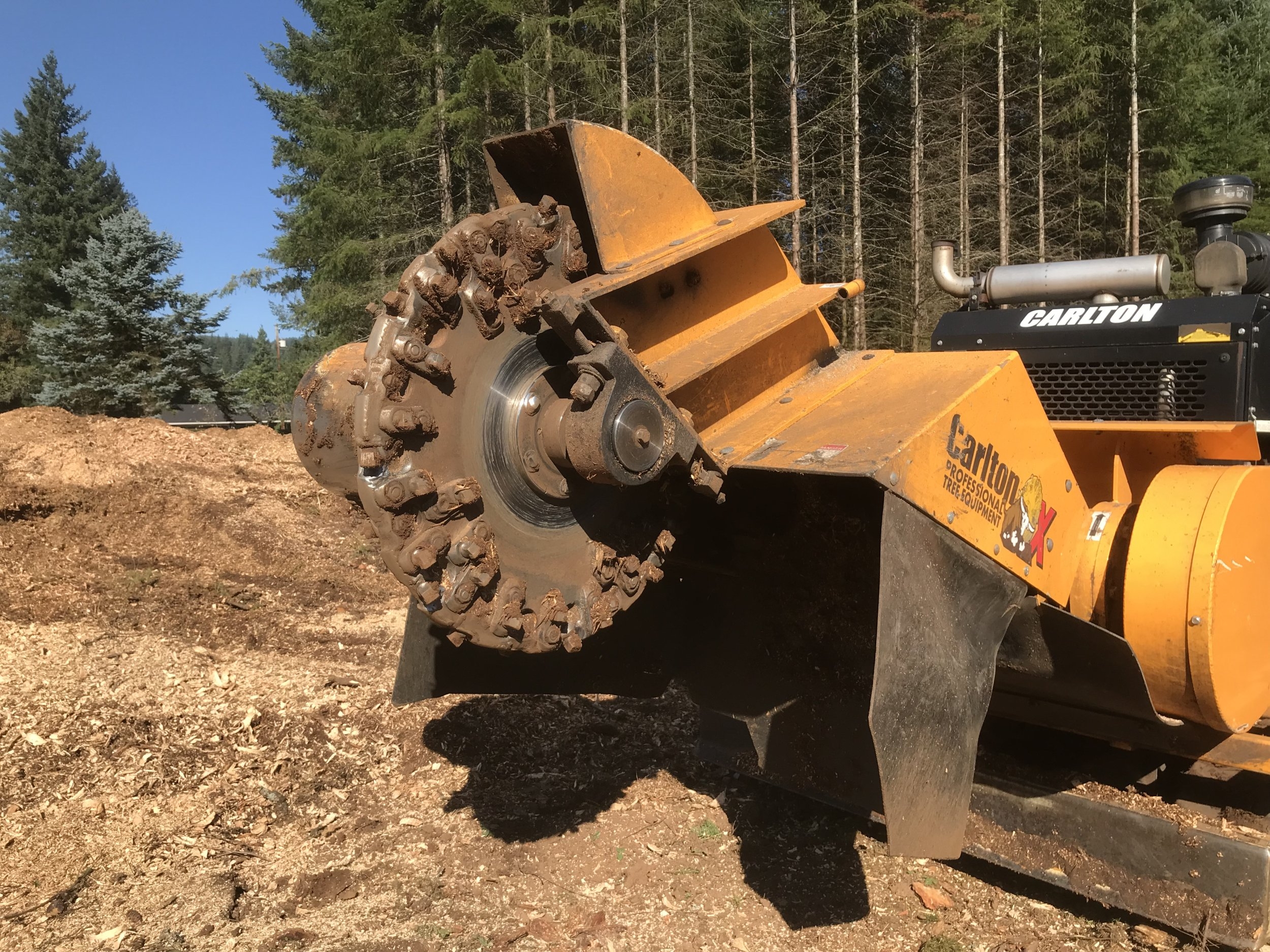

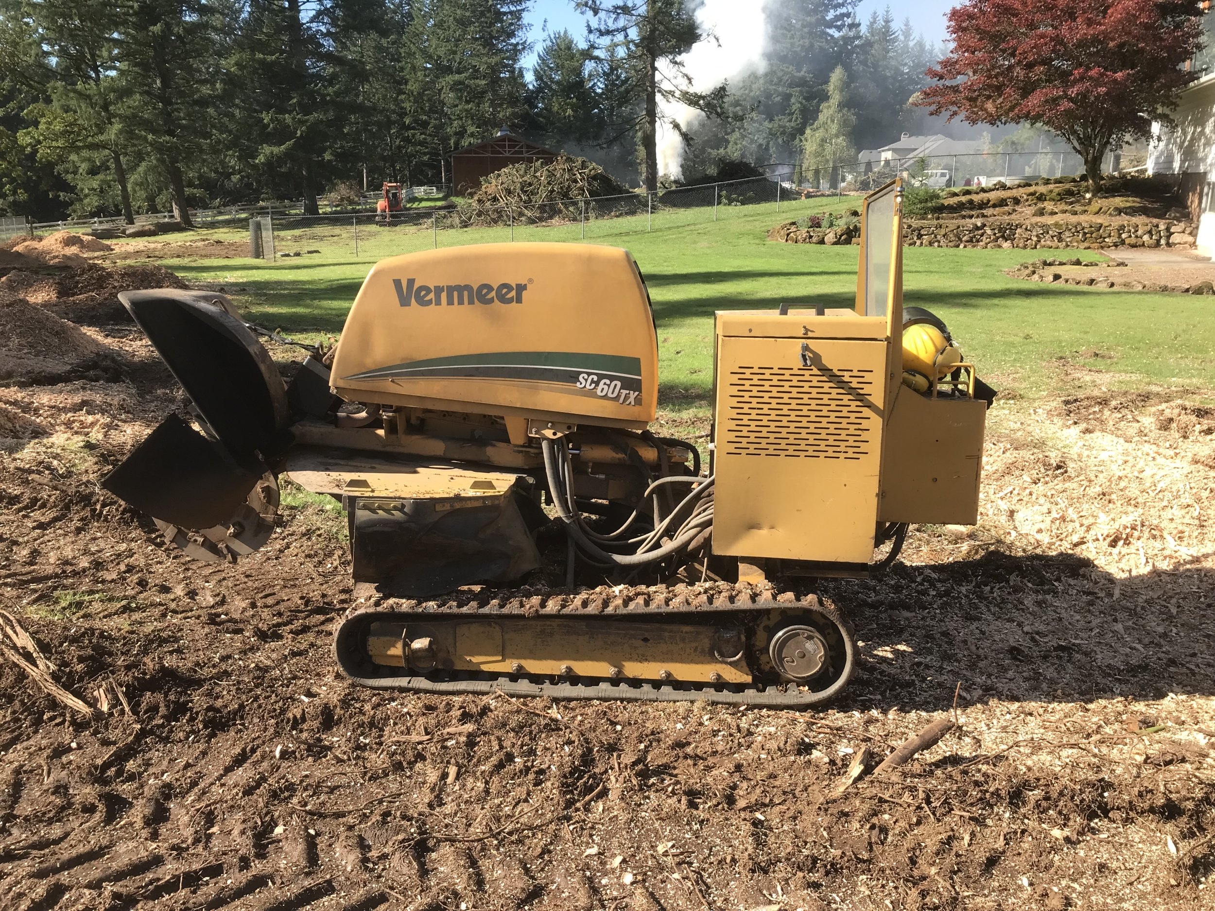

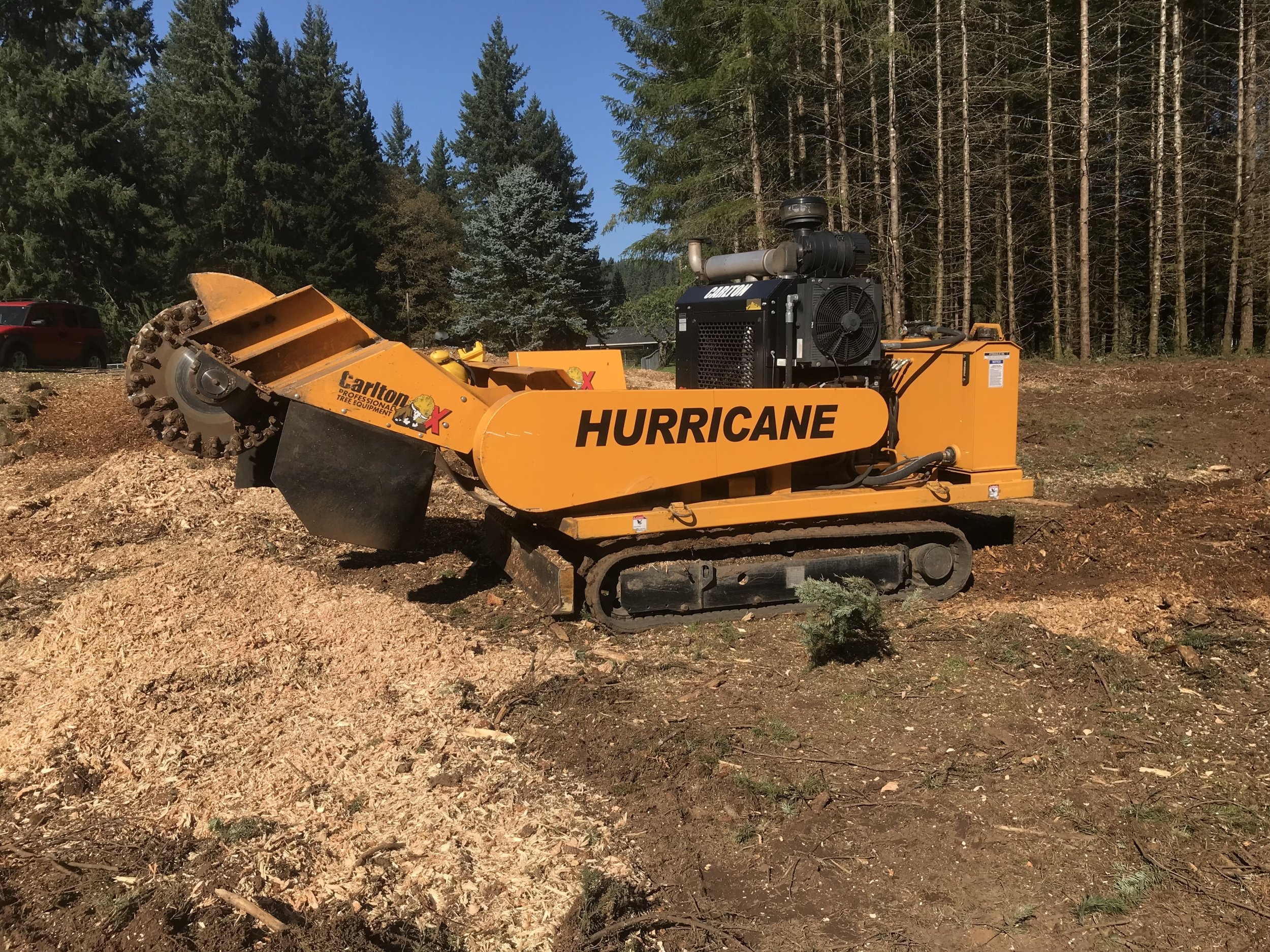

Update:
We ended up cutting down several more very large Douglas Fir "hazard trees" together with a next door neighbor and since he was using a contractor who has big stump grinders, I decided to have the same contractor grind down my big stumps also.
The contractor brought in two Carlton Hurricane (173 hp Diesel) and one Vermeer SC 60 TX (60 hp Diesel) and the big stumps were done in just few hours.
It was nice to watch three big grinders working at the same time and each being operated with their remote controls - IE. the operators were standing back away from the vibration, flying chips & debris!
I will keep the Vermeer SC362 for future use in little smaller stumps when thinning forest.
