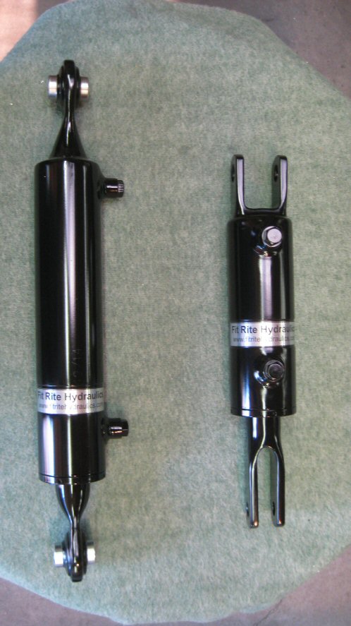

Ideally you need a 7" stroke unit for your top link or a 9" stroke if you are using Pat's QH. You won't find either one anywhere except from me. Probably an 8" stroke off the shelf unit is going to be the closest that you will find. Look at this link, get the asked for dimension and then go searching for something that comes close to that measurement for your mid stroke.
Side link needs a 4" stroke unit. Measure the left side (stationary link) and built to that if you are going to build one yourself.
My current lead times are running 16-18 weeks.
Picture shows a 2 1/2" set for a Pat's system. 2" cylinders are really all you need though.
Good luck with your search. ;)
