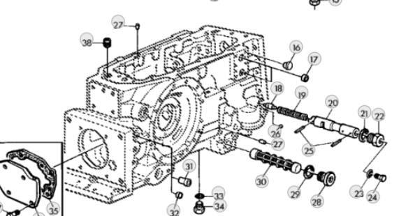

I have a 1980 2240 with Hydraulic pump noise after starting tractor takes a minute or two for noise to start very loud metallic rattle eveything works noise stops for a second upon engaging pto seems like cavitation can anybody help would appreciate any help thanks
/ Hydraulics #2
Sounds like either low hydraulic fluid, fluid with too high of a viscosity, an air leak in the suction hose, or clogged up hydraulic suction filters. My bet would be on the last two. Are you seeing any fluid dripping when the tractor is not running? How many suction filters does that closed center system have?

/ Hydraulics #9
Check screen & check to be sure hyd filter relief valve(item 18-20) isn't stuck open. Does this tractor have a frt end loader?

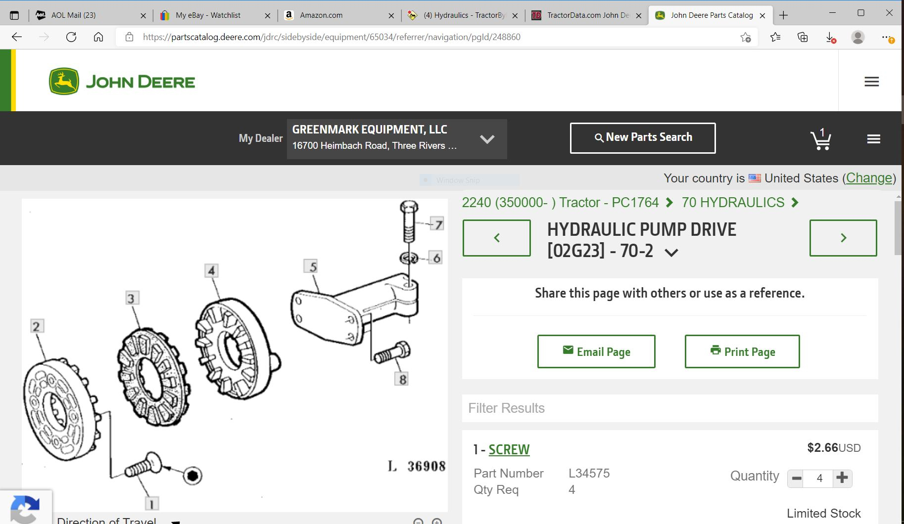

/ Hydraulics #10
This tractor doesn't have the two piece coupler and four rubber bushings.It has a solid one piece shaft. Hydraulic fluid is full, only had this tractor a month don't know when it's had anything done.
Sounds like you have this pump drive. I would check for loose fasteners at the very lease.

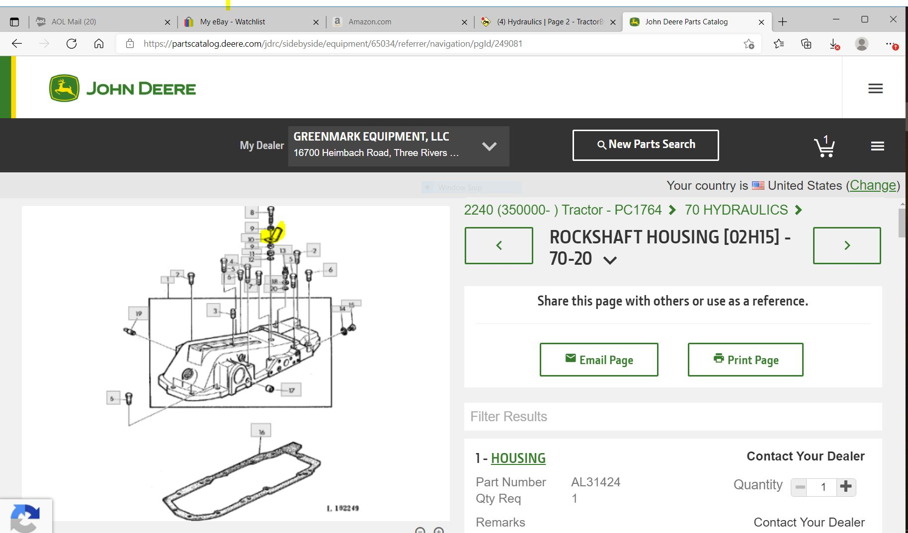

Does anybody have a 2240 with a small lever on top of trans straight back from shifters. What is this.

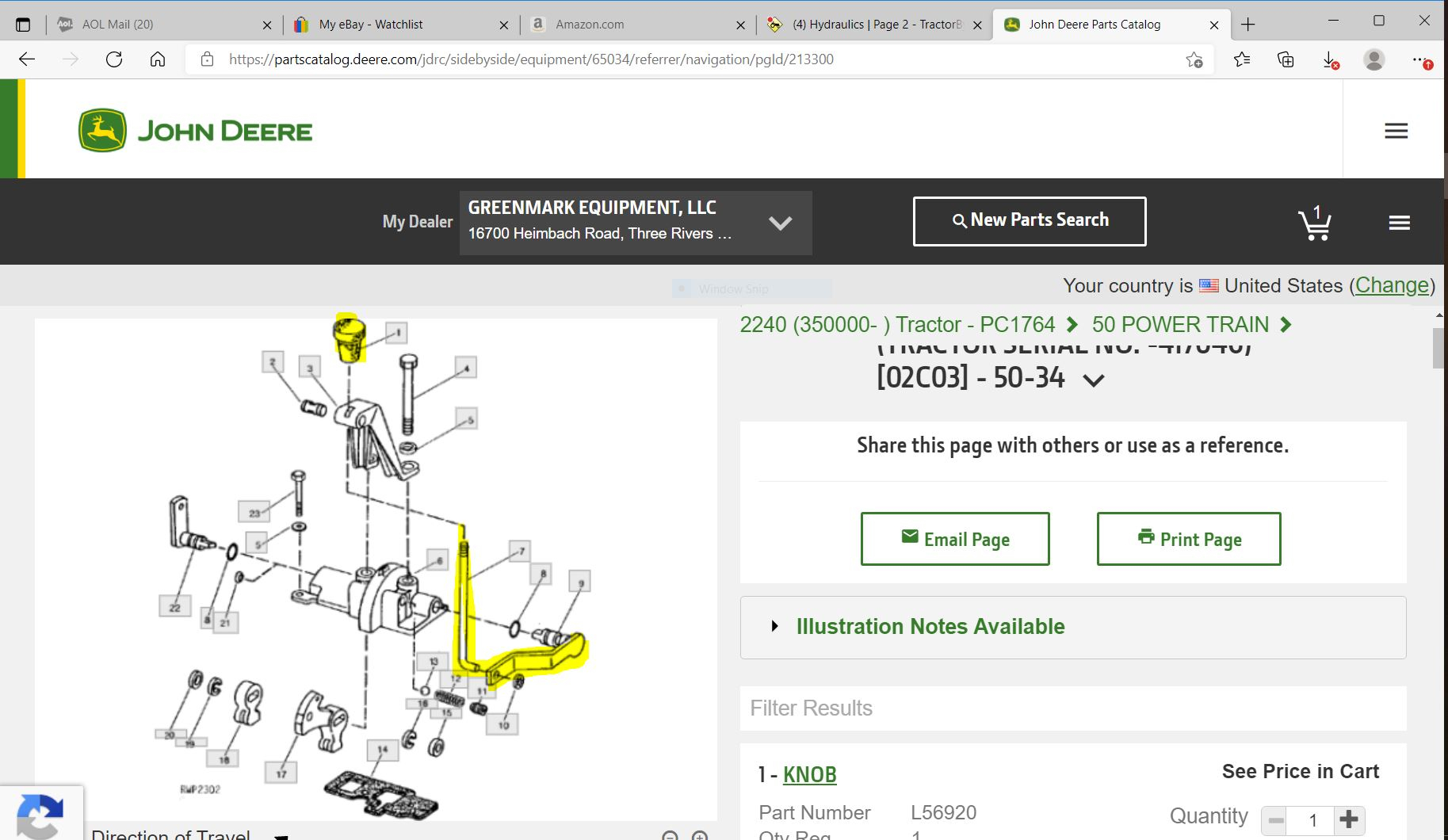

Control lever you describe is for independent pto. Sounds as if you need to study a 2240 operators manual. If you don't have an OM you can download it for free at the following site.

/ Hydraulics #18
Also is the Tractor serial number above or below 350000? This will let us select the correct parts catalog
/ Hydraulics
#19
Lever in the second diagram. The Tractors serial # is above 350
