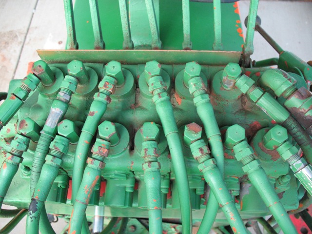

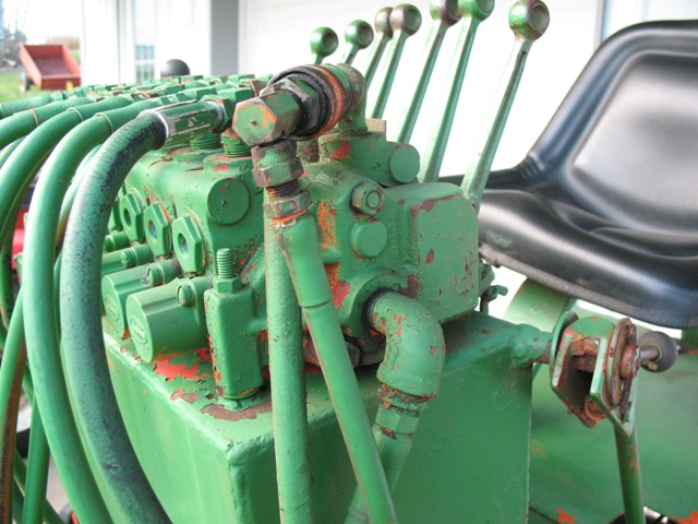

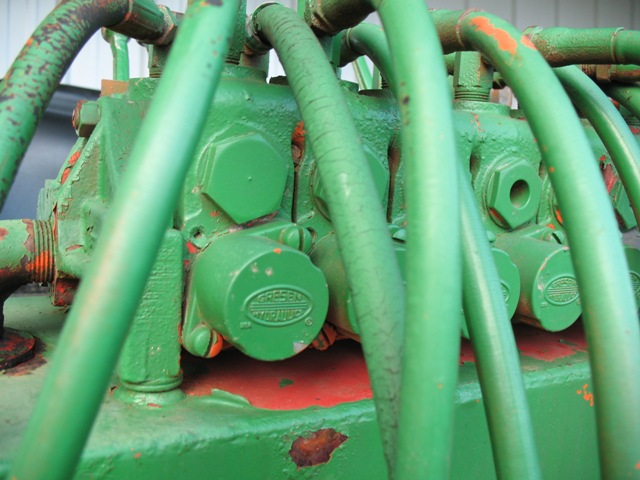

With machine set at high rpm and stablizers down and loader bucket down so all four wheels off the ground:
The left side stabilizer (as you look at back end of machine) is retracting very slowly and the two front cylinders holding bucket down are retracting very very slowly. Also I noticed wet oil residue on shaft ends of bucket cylinders. I'm suspecting the seals and packing etc are in need of replacing. Looking at the paint and rust on all the cylinders I suspect my 1961 machine may have not had its cylinders serviced in a long time. The cylinders only retract until the weight of the machine is back on the ground so suspecting the oil is just equalizing pressure wise in both ends of the cylinders.
/ Hydraulics won't hold #49
IF the cylinders are "retracting" it is NOT the cylindes unless there is oil leaking OUT of the cylinder.
IF no external oil leaks, Problem is in the valve.
