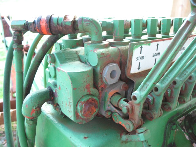

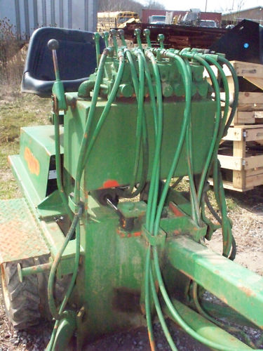

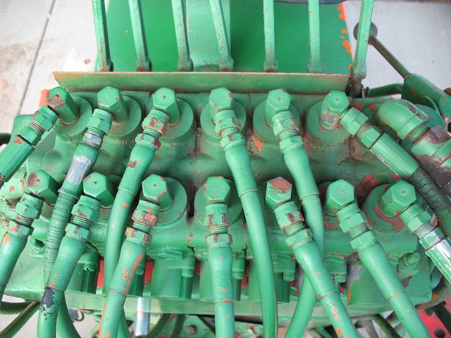

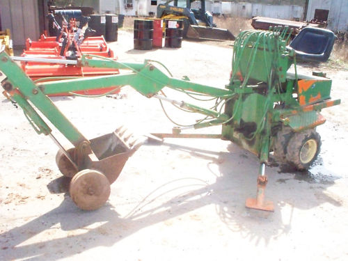

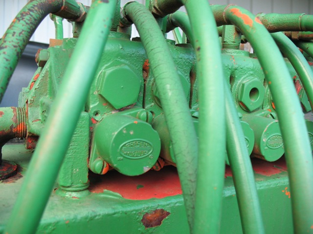

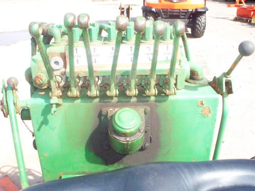

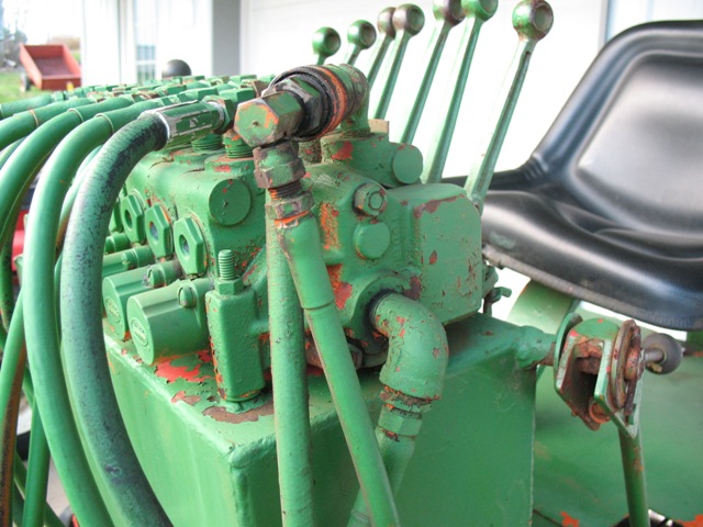

Here are some more. The last picture, looking from the bucket side bact to the operator, the left lever is the right outrigger, the 6th lever from the left is the left outrigger and the 7th (farthest to the right) is the rear outrigger.

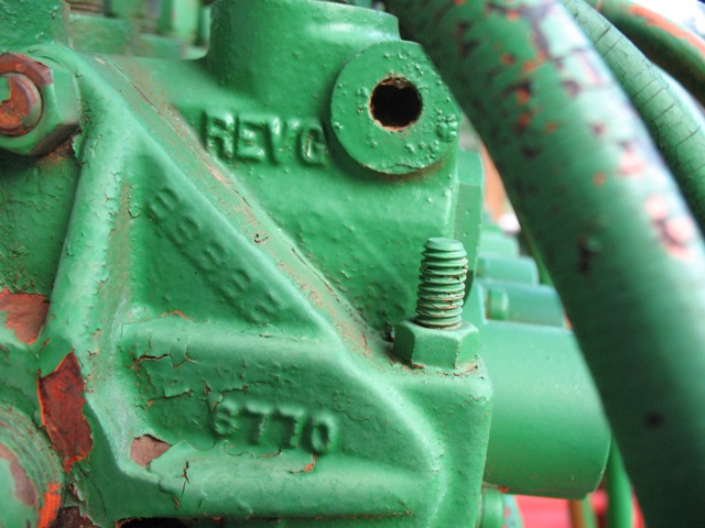

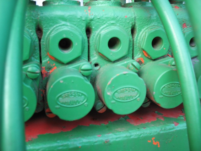

I've found out it uses Gresen V20 valve bodies and a 7 gpm Vickers pump. I'm waiting for the rain to let up so I can test it.
