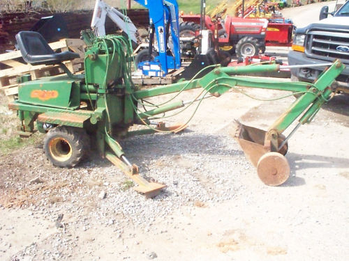

I just picked up a Terramite Model 1 backhoe. The out riggers will not stay up or hold the tractor when lowered. There are no external leaks, so I'm assuming everthing is internal. Where should I start looking? Would it be the pistons in the cylinders or the spoolers?
Thanks, Ron C

Troubleshoot with a pressure guage or start with the pistons.......the piston seal inside is probably worn and bypassing.....you won't see any oil leaking if it's the internal piston seal......
/ Hydraulics won't hold #3
If the relief for the BH does not activate with the cyl are fully extended or retracted, then you have a leak in the cyl as wdchyd mentioned. Remote possibility could be a worn outrigger spool, but unlikely. Are both outrigger cyl doing the same thing?

Yes, it's both cylinders are doing the same thing. I suspect some of the others are as well, I just got it running yesterday. The machine was setting for quite a while.

They have been moved up and down atleast that much, but I will run them through 10 full cycles to make sure. They will lift the tractor, but they bleed down in less than a minute.

They will hold position as long as I have the lever pushed, but as soon as I release it, they start to bleed off. Both side act the same and bleed down a pretty much the same rate.

Main relief is not in the picture when outrigger cylinder is bleeding down. Control valve in neutral makes work ports closed.
If piston seal is leaking and capped side holds the load, cylinder rod is retracting and that rod volume of oil must be displaced through the control valve, if there is no external rod seal leakage. Only an eventual work port relief, or spool could leak. If piston seal is leaking, pressure will equalize on both sides of piston.
Bleed down in one minute do not tell the entire story...diameter size of rod and how long retract will determine leakage volume....
OP should also make sure this old control valve really sets in the real neutral position, maybe it is sticking a bit and not closing the work port properly...spool stiction from rust etc could cause bleed down too....if spool is 1/32-2/32" off from neutral could be enough....

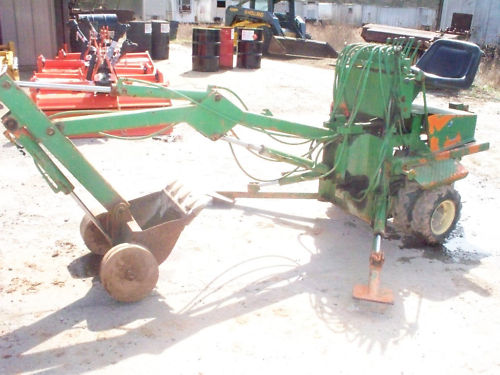

If it helps, the cylinder is 16" eye to eye, 1" rod and 2.5" cylinder. Two cylinders, two valves doing the same thing. I'll check to see if they off center.

Cylinder drift is to many times misunderstood. Piston seal many times in fault but, but in retract mode like this there is always an additional problems due to the cylinder rod displaced volume.
Now we now a little more about what volume that are leaking per minut...
Great to see these pictures.....seems like cylinders are bleeding down 4-8" on the rod....that will make 3-6 cubic inch per minute...
If piston seal is bad, pressure intensification will boost pressure to 6.25 times higher than work pressure that lift. If it takes 500psi to lift up excavator, drift pressure will be 3125psi....and an eventual work port relief will open...
This will happen even with a good piston seal, but at a much slower cylinder drift, which would be considered normal...

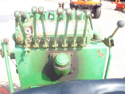

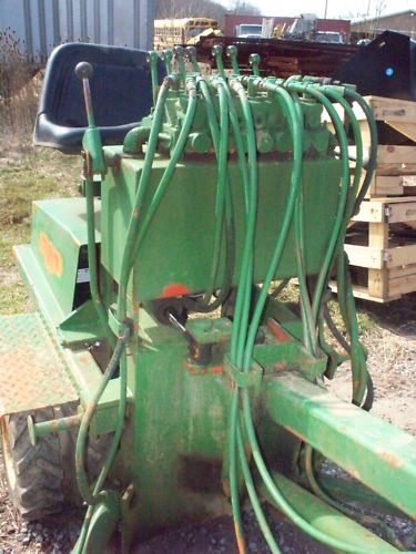

My picture is pointing out (fingers) the position for the work port relief valves that could cause the bleed down...try to find the ones that are connected to the outriggers, I cant tell if there is and valve cartridges in them slots or not....
Please post a detailed picture of both sides of the valve stack??
The valve should be on the same side as the lever, if you push the lever (spool) to lower outriggers/extend cylinders....

Here's some more pictures. Does this help?

It looks like the valve castings are machined for WPR's but are plugged.......
No WPR's......
