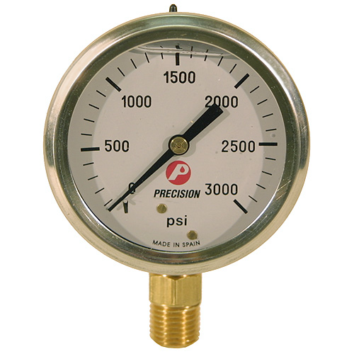

Check your relief pressure with a hyd gauge.
/ hydraulics stalling engine
Not sure how to do that or even where to get the gage. Regardless of that, what should the gage read and depending on that, what could be wrong with it?
Thank you!

/ hydraulics stalling engine #8
Thank you!
Here is one place, Surplus Center:
3000 PSI 2.5" LF LM GAUGE
