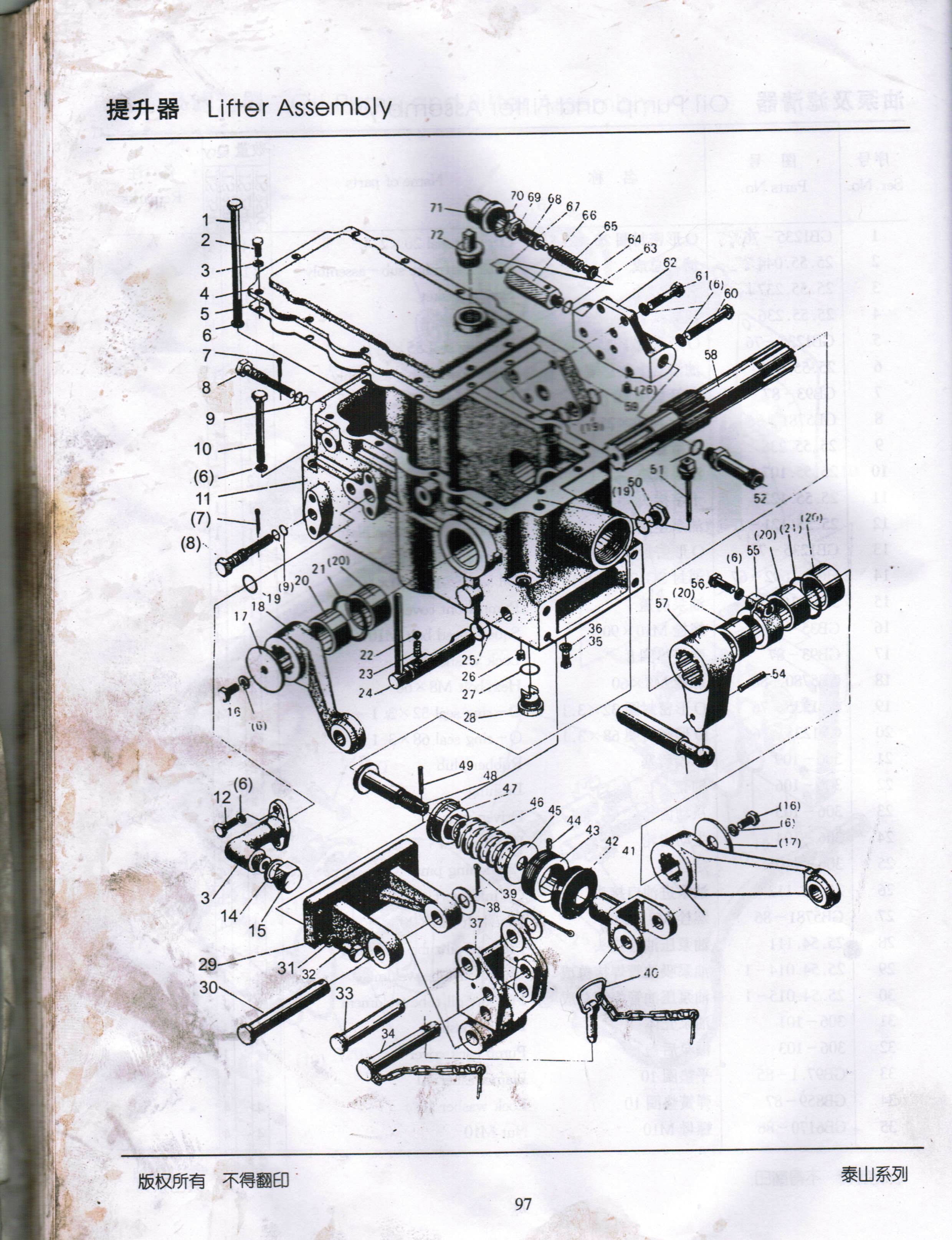

Anyone know what the function of the parts numbered 42 to 49 are on page 99 of the parts catalog?
I cannot get my system working and have taken the entire lifter case off and have removed the cylinder and distributir assembly looking for worn or broken parts. So far haven't found anything. How would you go about checking each hydraulic line and cylinder in the system for a clog?

/ Hydraulics lifter assembly KAMA TS254C
Here it is. Thanks.

/ Hydraulics lifter assembly KAMA TS254C #5
That's the draft control feedback linkage
What's it do? How should it be set?
/ Hydraulics lifter assembly KAMA TS254C #7
First off it's only used in conjunction with ground engaging implements; like plows, box blades, middle busters, rakes, etc. When the implement wants to dig too deep, it exerts a pull on the toplink bracket. That extra pull on the toplink transfers to the draft control linkage, which in turn raises the rear lift back to operating depth. To the right of the operator seat are two levers. The inside lever you already know raises and lowers the three point hitch. The outside lever allows the operator to set that operating depth. It sets the sensitivity of the draft control linkage, which in turn tells the rear lift to raise the ground engaging implement back to operating depth if/when it starts to dig too deep. When draft control is not required - which is typically most of the time - the outer lever should always be in the full up position.
