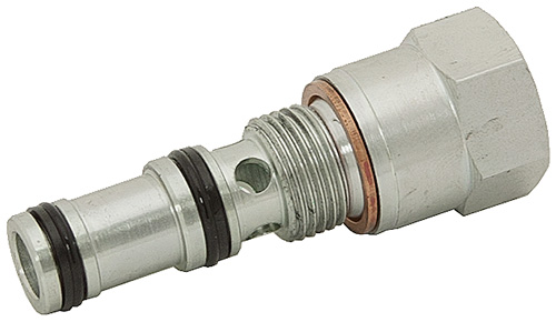

Just to clear up somethings, is the PB adapter a hex screw or a fitting like the picture on the valve page?
Gary at Prince Hydraulics says that a hex screw goes in the bottom port and when installed, make that port an OUT port, and makes the top port the PB port for downstream flow.
Can you show a picture of the inside of the bottom port.
This is a PB sleeve adapter
Surplus Center - POWER BEYOND/CLOSED CENTER SLEEVE WVS VALVES.

I have the PB sleeve that lolls like fitting. Same as picture.
   / Hydraulics for quick attach Grapple #26
In most situations using a PB adapter, the port that the sleeve or hex screw is used becomes the PB out flow.
With this valve, it appears that after installing the PB sleeve, the sleeve fitting becomes the OUT port, and the top port becomes the PB pressure port.
You may have to reset the relief pressure to match up to the loader relief pressure.
The valve comes set to 2500 psi. You can set it equal to or below the tractor relief setting.

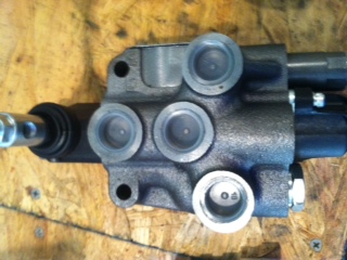

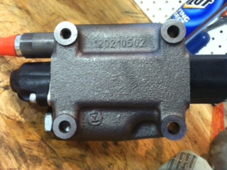

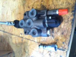

I finally had time to take a few pictures of Valve.WVS Valve 1.JPGWVS Valve 2.JPGWVS Valve 3.JPG

JJ got new valve installed and everything we exactly like you guided me. I have not connected to hoses to the grapple cylinders yet. I wanted to make sure FEL and 3pt lift still worked correctly, and it does. I was looking at quick connect couplers for the grapple hoses and i see one that for single acting sleeve set, a double acting sleeve set, and poppet. What are the differences and what do you recommend I use?
